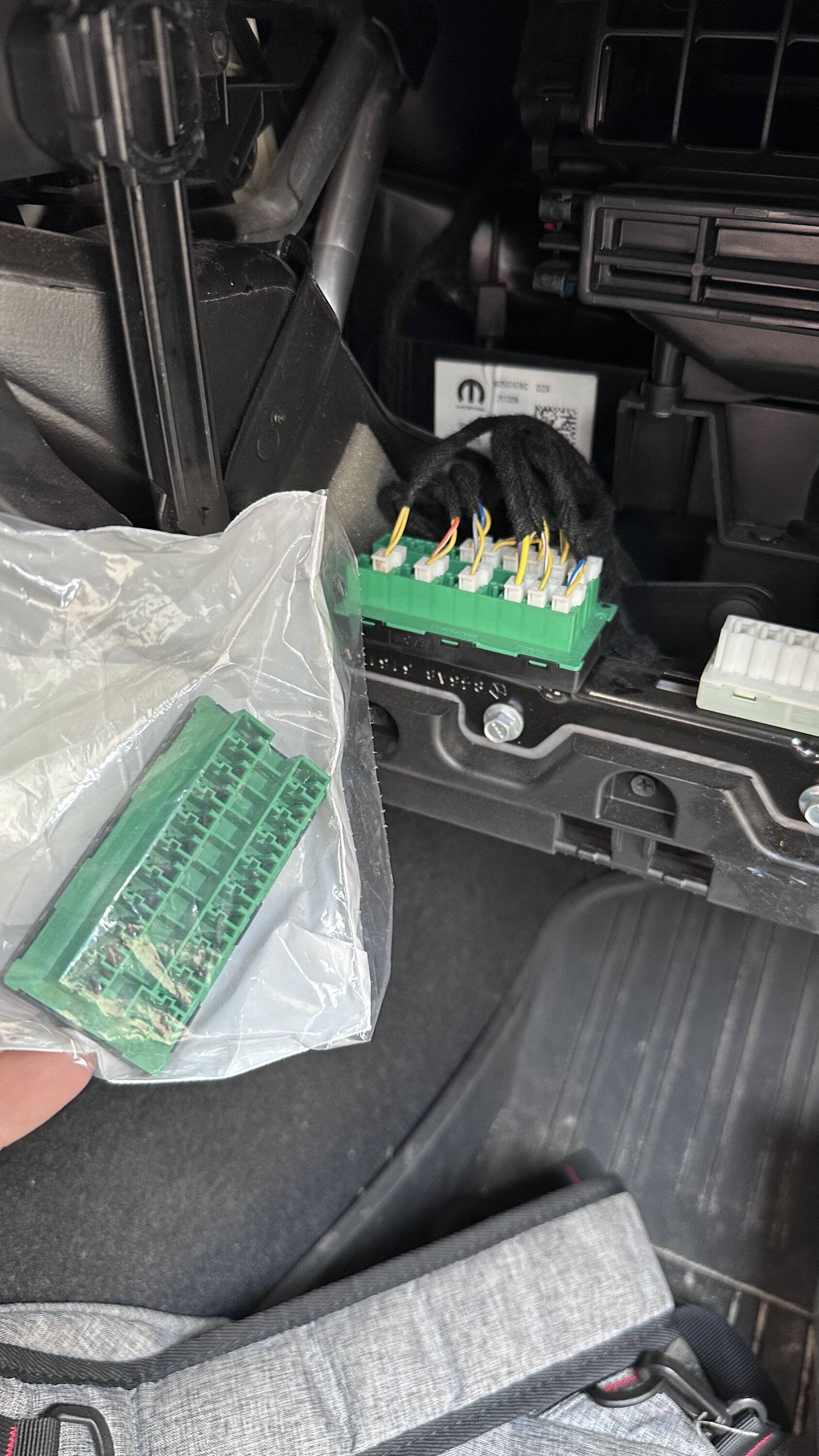

Check the Green CANBUS behind the glove box and replace it. Its a super easy fix that anyone can do, remove glove box, the part clips in to a metal frame (kind of slides into a slot in the metal), take each plug out and replace into same spot in new one (one at a time so you don't mix them up), and reattach new where the old one was.
I have heard you can get them on eBay, I got mine from the dealership for 75 bucks. Haven't had an issues since replacing it and it was a daily occurance for a short time doing same as what yours is doing. Hope this helps!

Hey, quick question. How do you remove the white connectors from the green bus. I’m trying to pull them out and they’re not coming out.
I used a 90-degree pick to press the locking tab while gently prying the connectors out.

If you don't have a pick you can use a small screwdriver to push the locking tab in to pull the plug out.

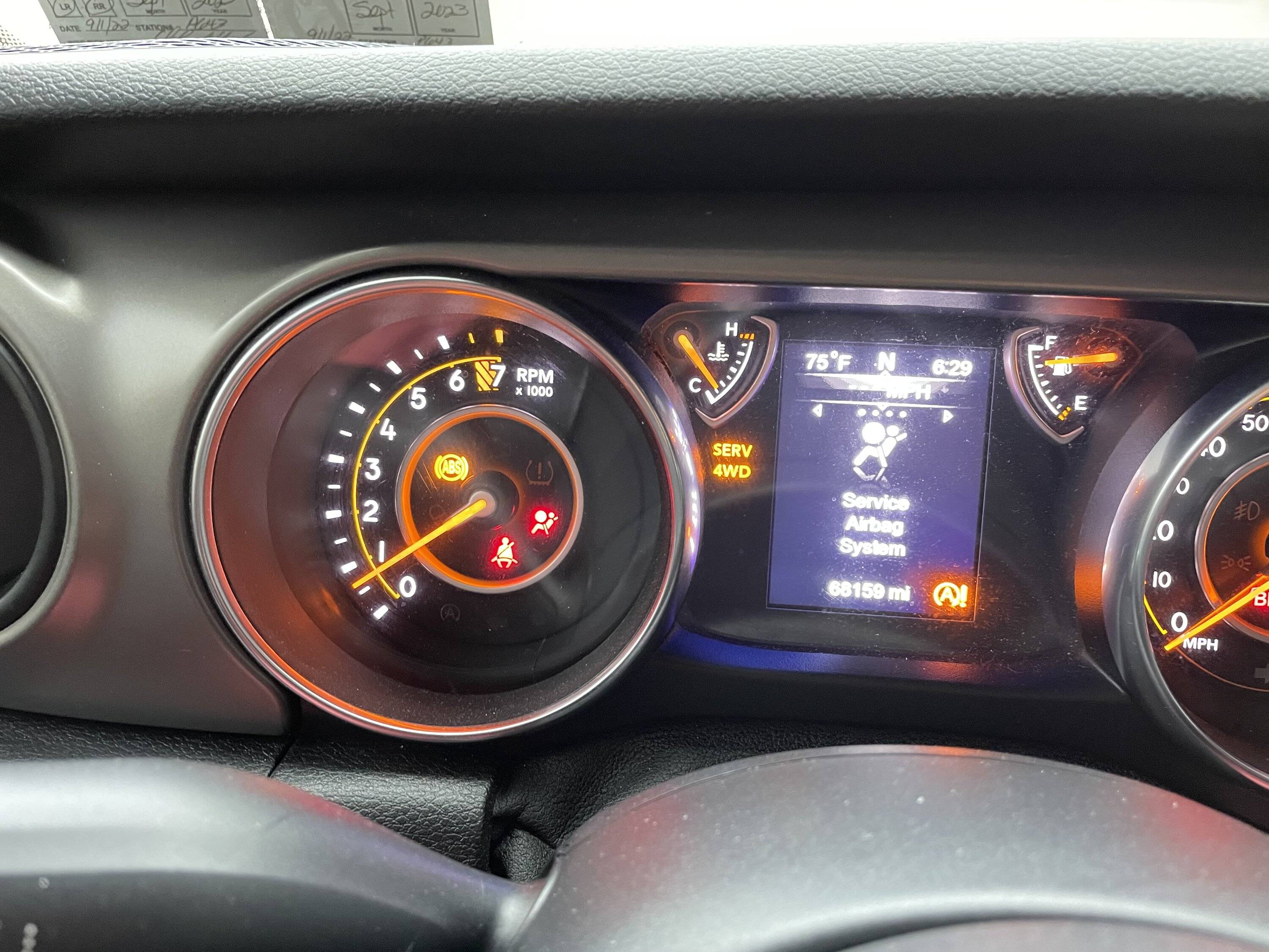

going through same shit.2019 wrangler jl sport 2 door manual. 68,000miles. started with flashing abs light 2months ago with then start stop not working given i replaced the aux battery 3 months before this happened delearship said both batteries needed replaced so i did that. moving forward 2 weeks agos i got all these codes ran the scanner because i got my dash lit up with every warning you can possibly imagine. every time it happened it wouldnt let me turn it over to off but wound turn over to acc. while making a weird noise(video attached) .finally it will turn over to off..one day on the turnpike the jeep did this but this time i lost my power steering. i called the dealership and they now have the jeep and i have a rental.dealership has driven it over 300miles and not one code is popping up and they cant replicate the flashing dashboard or powering steering loss.i called a jeep advisor today. this is a huge liability issue.if the dealership returns it to me and doesnt fix it if i get into a accident especially on the turnpike and kill someone . disappointed
and will never buy a wrangler again if this isnt resolved

When it is doing that open your glove box like all the way to get behind it into the dash. Tap on that green CANBUS connector to see if it stops the problem while it is flipping out (Scroll up and there are pictures of it). That is how I found out it was that and replaced it and have not had a single issue since, and mine was doing same thing yours is. I tapped on it while it was doing all the crazy lights and warning signals and it stopped after tapping on it. I have heard it has to do with some of the solder on the inside of that part maybe breaking loose or something.
Hope that helps.
