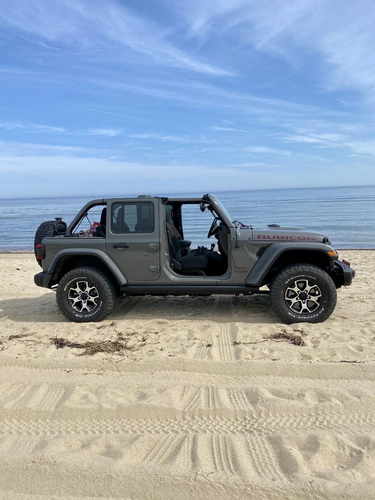

I’ve always driven on beaches in NJ without airing down. Have I just been lucky?
Probably. I think it really depends on the sand. I got stuck going in a dead straight line running 16 psi in my stock BFGs here on the beach in Cape Cod, MA (Race Point Beach).
OP, if your tires start spinning from getting stuck, just stop. Dig out the area in front of the tire, take a little more air out, you should drive right out.

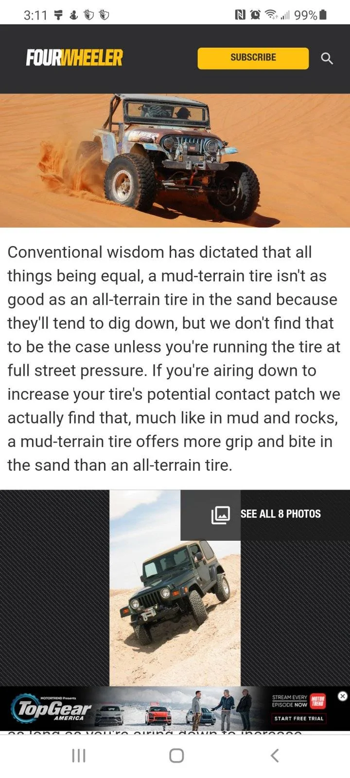

Jeep Wrangler JL Driving on beach sand. Screenshot_20210308-031157_Chrom
All terrains are only better in sand at street pressure, aired down aggressive is always better for the same reason paddle tires exist.
