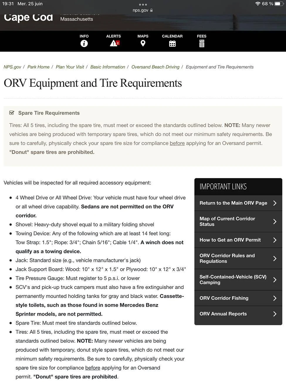

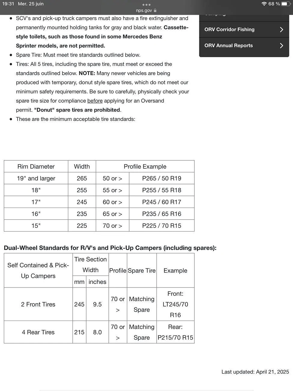

I go to Cape Cod Race Point every year and I air down to 15 PSI and use 4Hi and go nice and slow !
In Cape Cod, we need to obtain an ORV permit and need to have a few things (see below). Check with the location were you are going to to make you bring everything that is required.
Enjoy the Beach!
