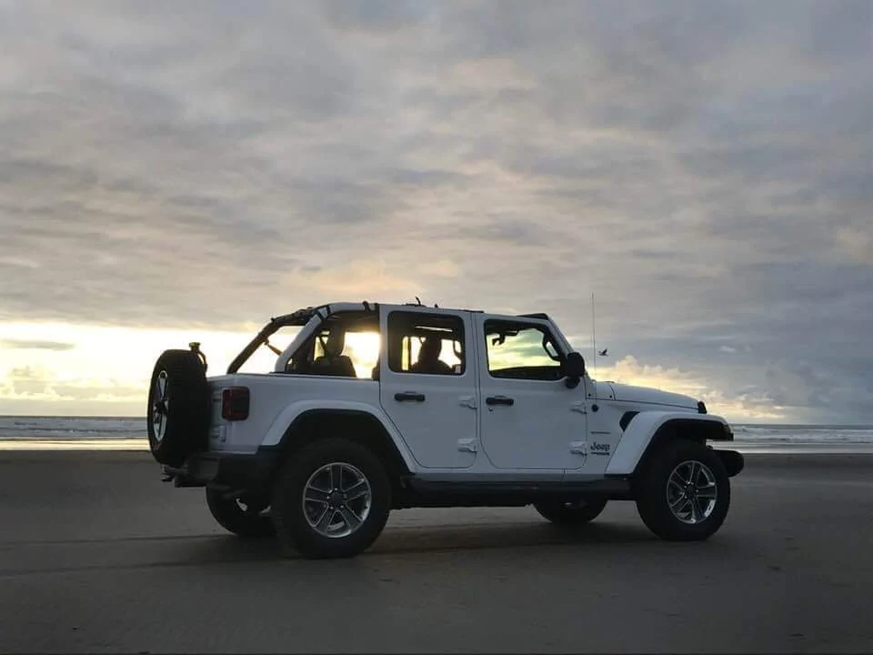

25 mile run in Washington, drove the entire length in 4 hi without any issue. It never felt like it would bog down (most of the sand is pretty compacted tho)
