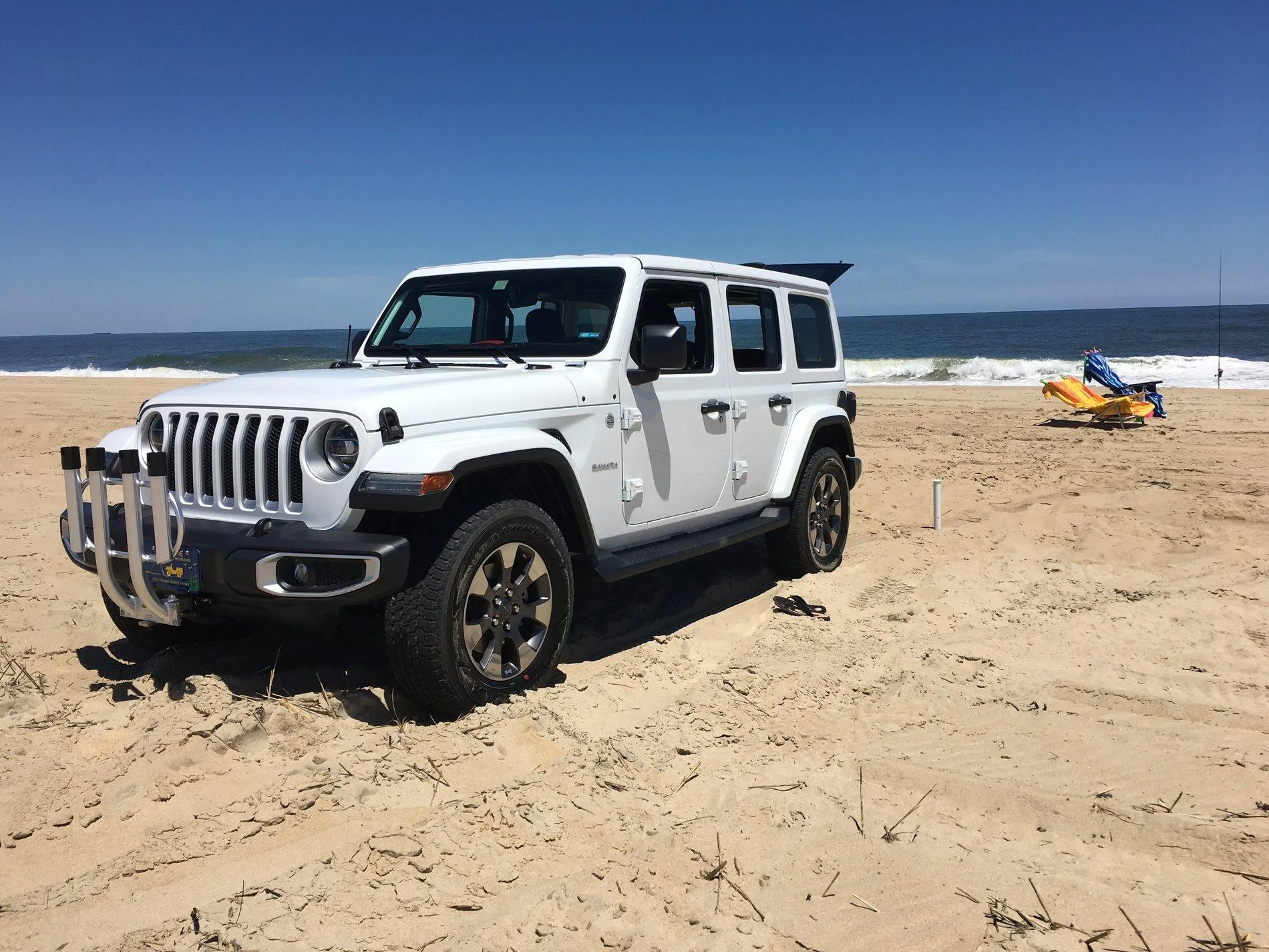

With my 2013 JK, I would disable traction control manually.
On my 2018 JL, traction control is disabled automatically when I select 4 Low.
FWIW, my auto-deflators air me down to 18 pounds before I cross onto the beach.

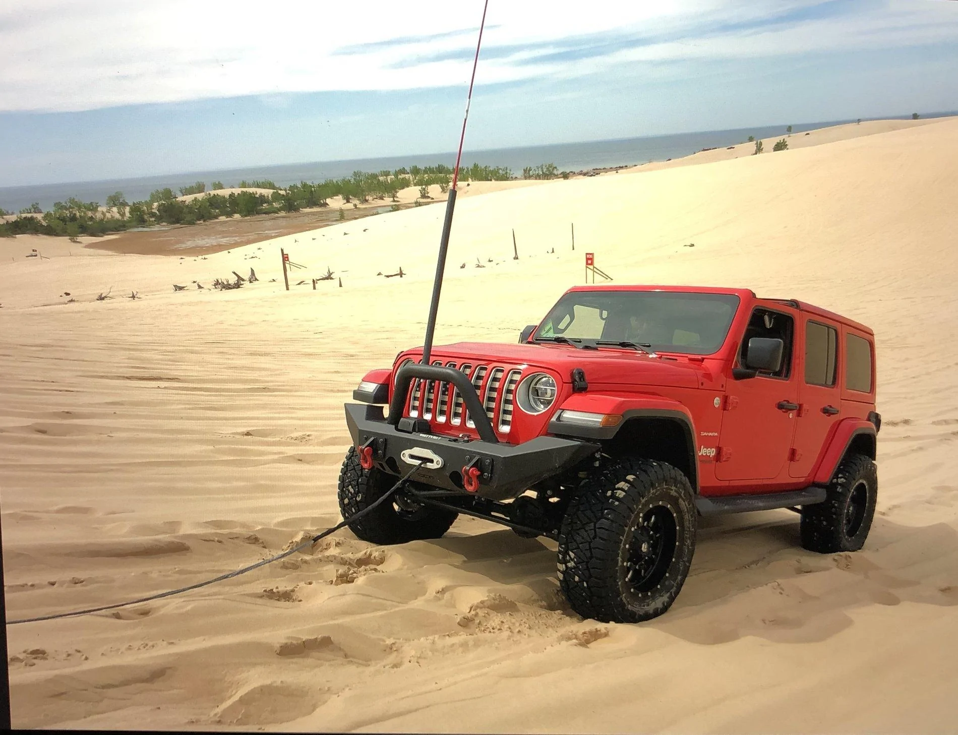

Went to silver lake sand dunes with new JL and night and day difference compared to the previous 16 JKU, rolled and held 8psi two days out there and did not run into any driving issues.
did you use 4hi or 4low ? traction esp ?
airing down does help alot, in the winter the weather is below freezing in some areas and camping a few days out if not weeks is normal, however when its 140+ degrees outside airing down and then airing back up for a couple hours of fun isnt worth it.
ESP Always off, 2w most the time. Occasional hills with 4hi no issues. If it started struggling just kept it in 1st or 2nd using “manual” and it just went right through
