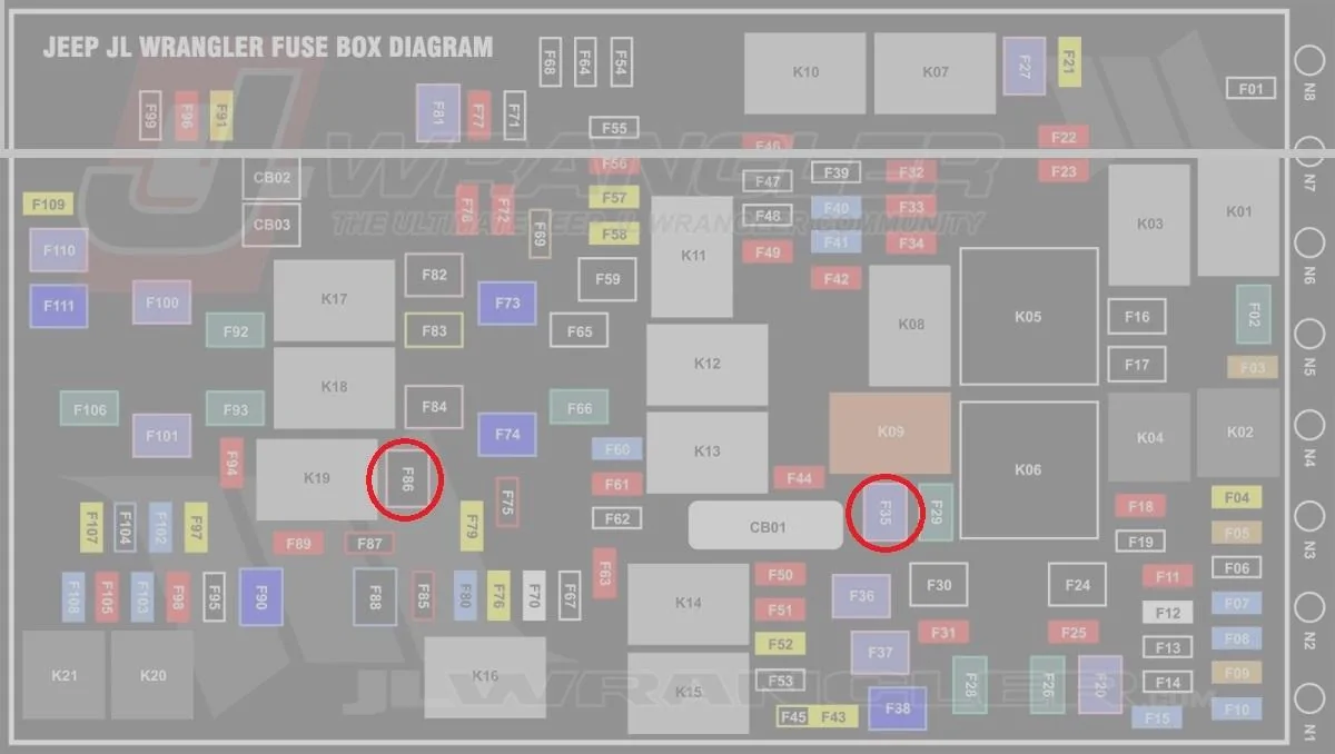

on the jk i haven't seen anyone do it on the jl yet, if you did can you show me what fuse you pulled ?
Need confirmation
(ABS) and related systems
Jeep Wrangler JL driving on the sand issue, traction control ? FUSE BOX DIAGRAM

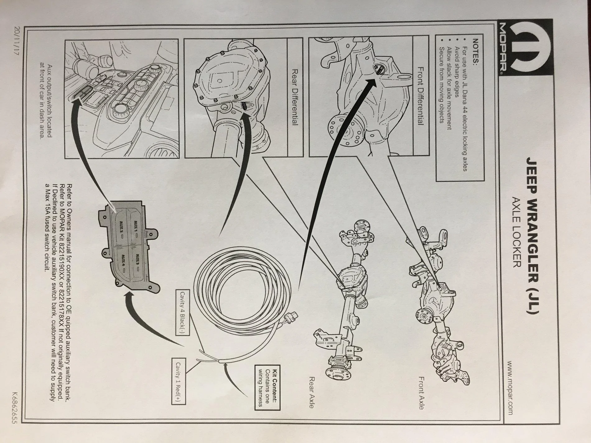

I do have that switch still, I just don’t use it. I have Mopar wiring harnesses that plug into the front/rear differentials and I wired them to my auxiliary switches 3&4, ( 3 front & 4 rear to help me remember, lol.) You can turn off traction control by holding button for however long it says to, but as long as your connected to the computer bld (brake lock differential) is always going to be active because it uses the ABS system. With my harnesses I bypass the computer, it doesn’t know what I’m doing, as far as it knows I don’t have locker engaged, when in fact I do. The bld works with abs when one wheel slips it slows it down to transfer torque to the wheel that’s not slipping. When lockers are engaged you don’t have independent wheel slippage therefore bld doesn’t engage....:)
so bld works when there is independent wheel slippage, when the lockers are engaged using the aux switches to bypass the computer that wont happen therefore bld wont come on ?, so i can drive in 4h and 2h with with the lockers on and the bld off ?
if so, will the lockers show as engaged on my dash or my off road page ? will the red buttons still work as they should ? and one final question is how will it drive in 4auto ?

Ok.... if you have lockers wired to aux switches then you can no longer use the factory switch. Nothing will come on anywhere on the dash or off-road pages telling you that lockers are engaged or not. This is what turns some people off from doing this. But I can tell when I’m locked and unlocked by the way it drives. Also if you listen you can here the click. Bld won’t engage because when you’re locked up then you don’t have individual wheel slippage. You can use front and rear lockers in 4 hi and drive as fast as you want they won’t disengage, you can also use rear lockers only in 2 hi. 4 auto is not available with lockers, at least here in the states, so I can’t answer the last question. Hope this makes sense....:whew:

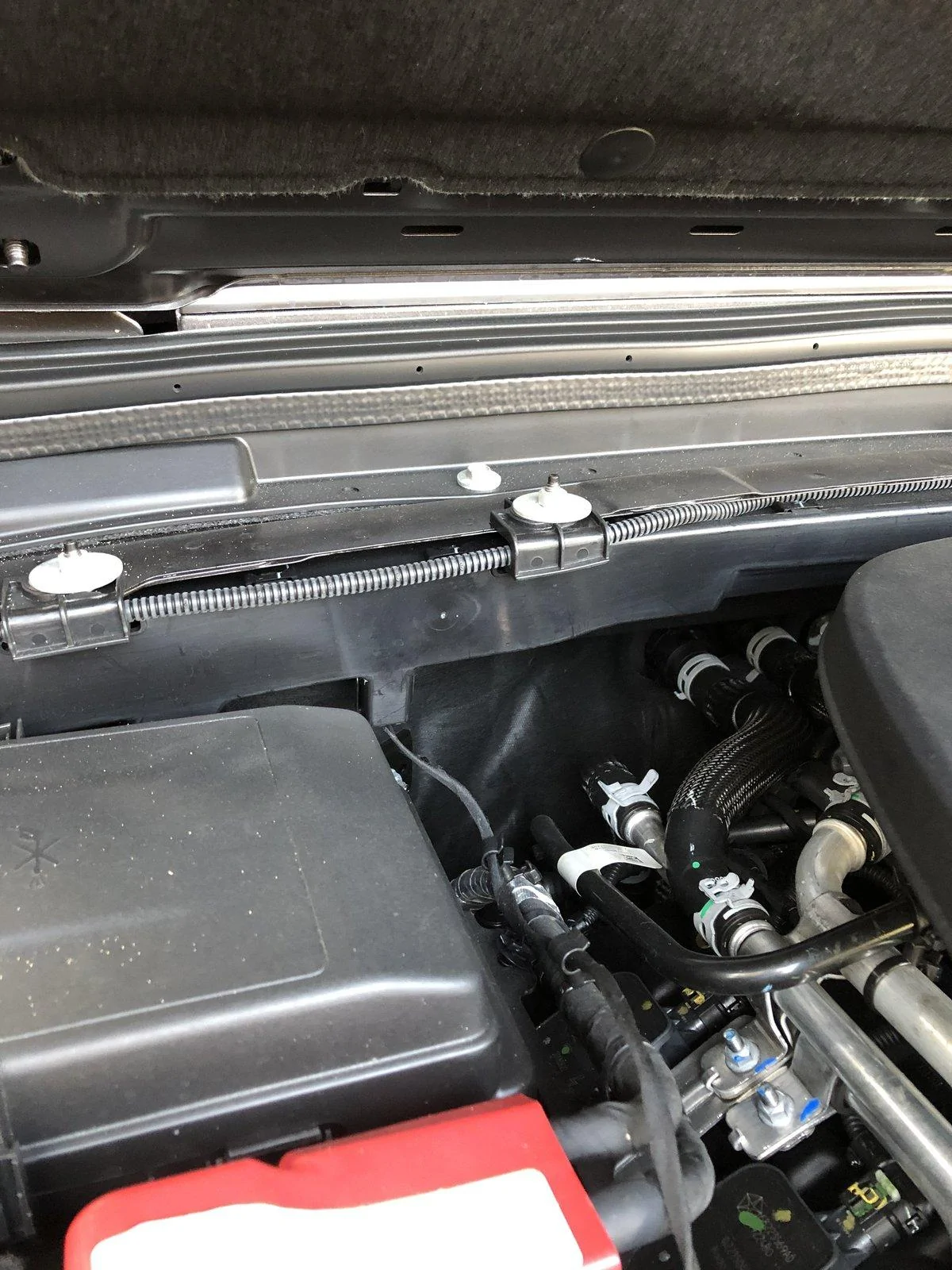

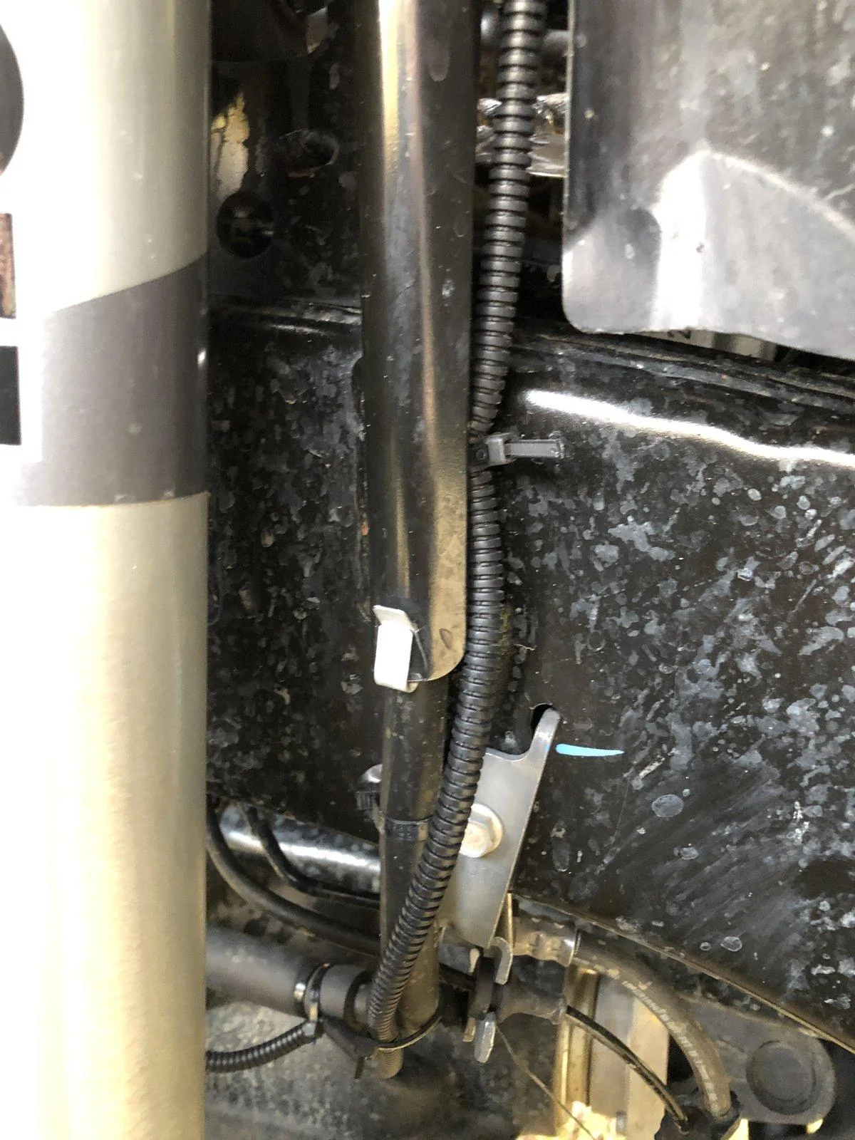

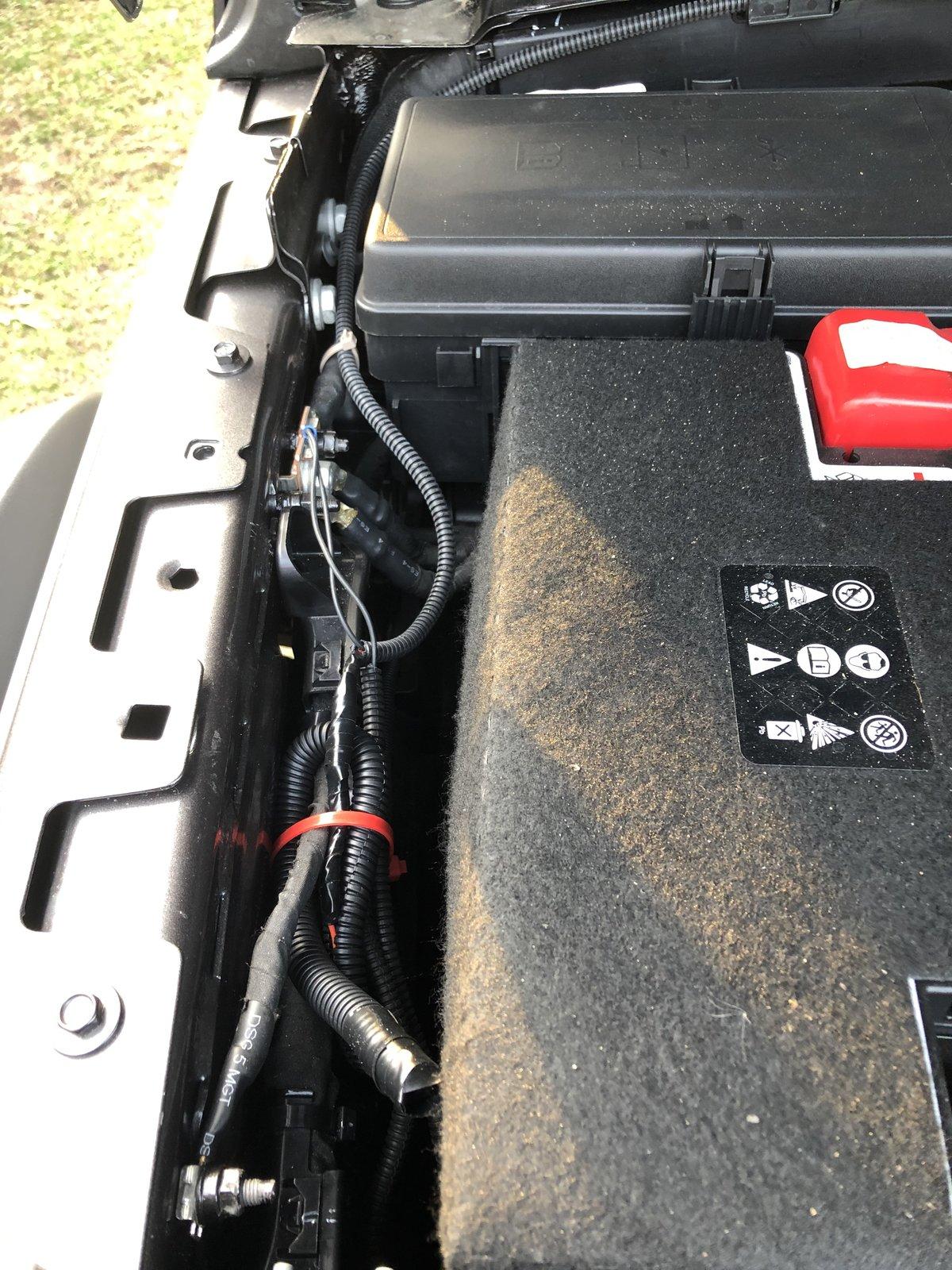

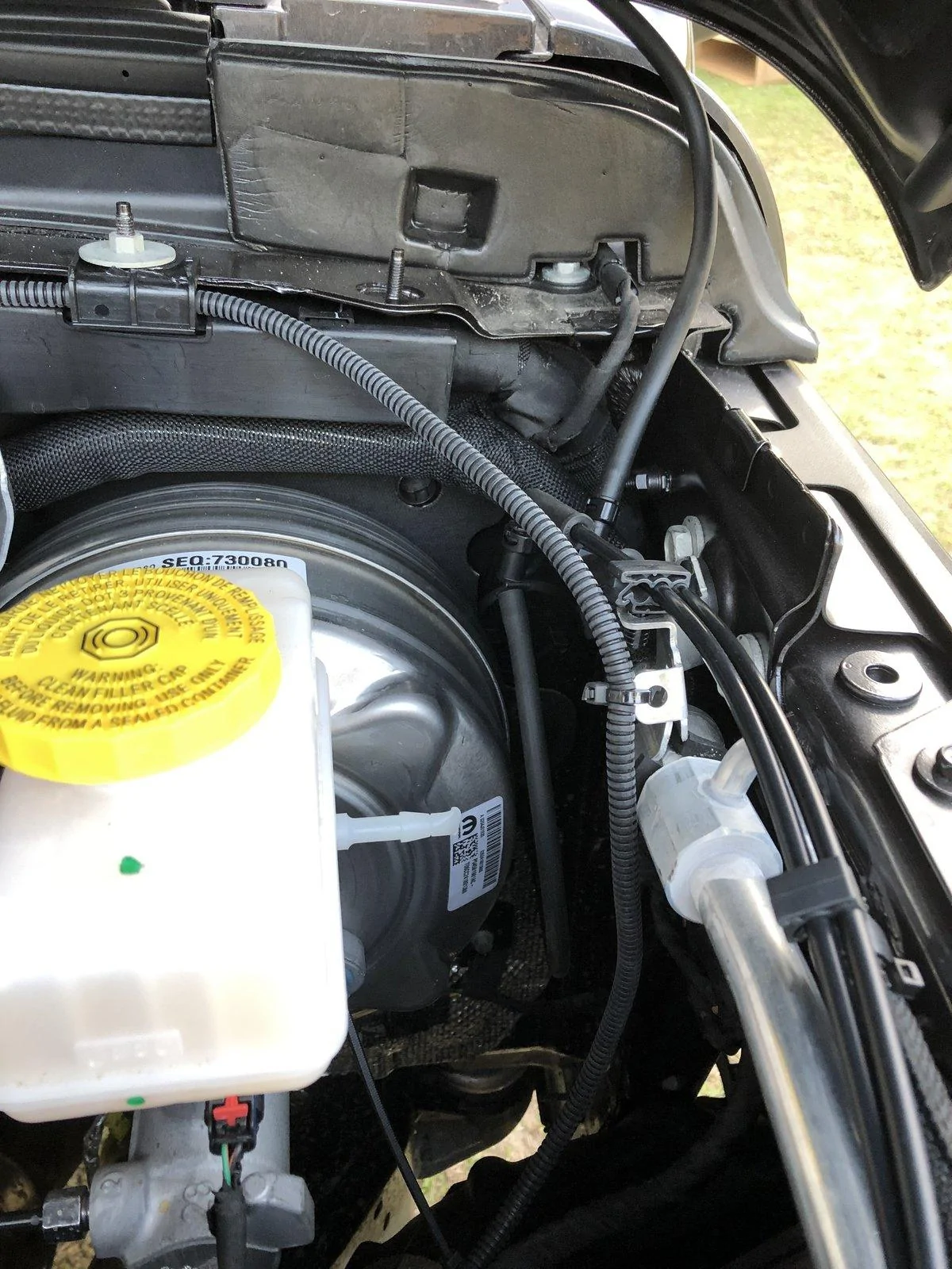

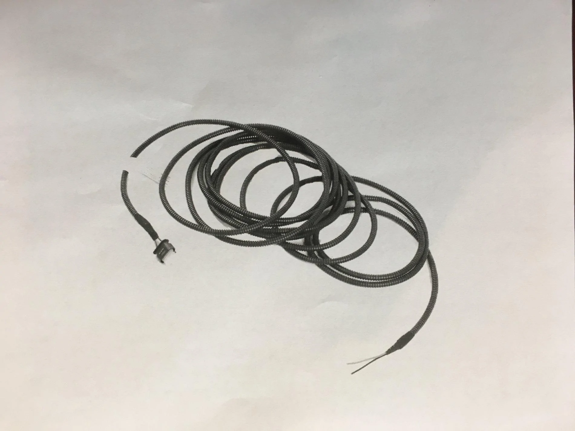

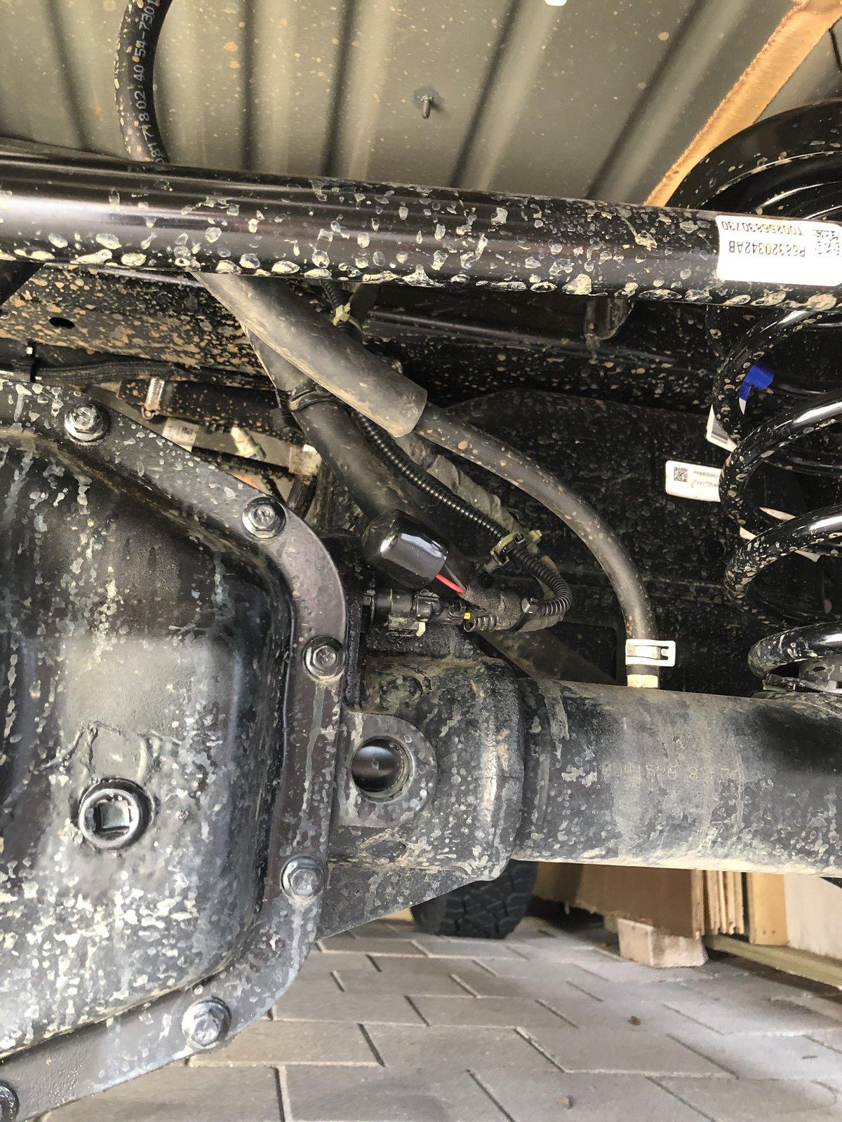

Yes.. I just got a rubber cap and taped it up and zip tied it up out of the way and all you do if you want to use factory switch is just plug factory harness back in. Here’s pictures of how I ran wire to front differential up by where hood meets cowl and picture of my factory plugged in and Mopar capped off.
