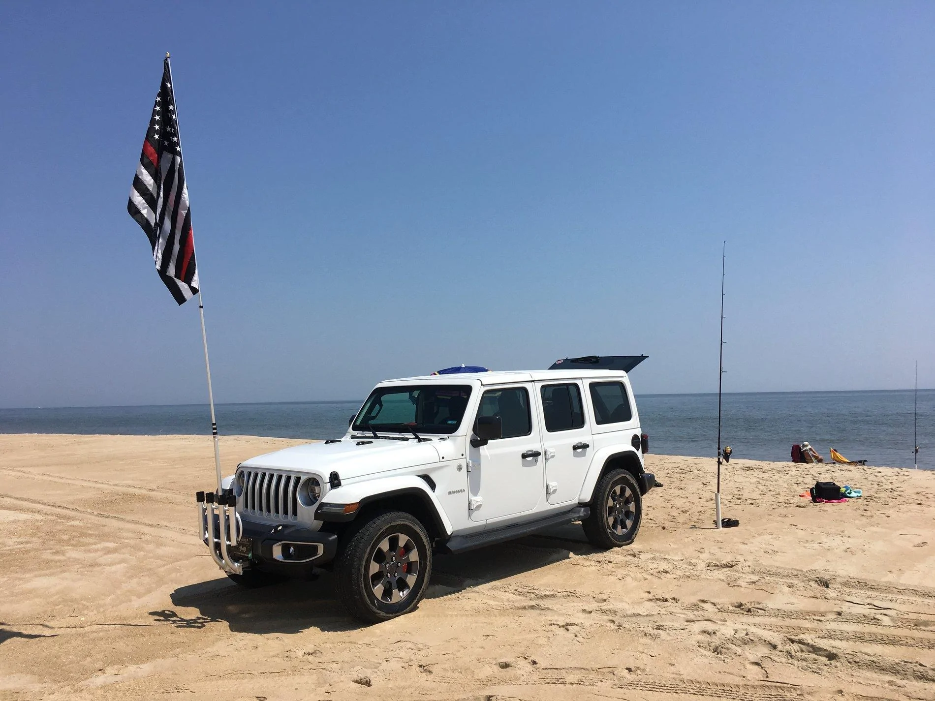

Driving on the dunes here is strictly forbidden. In fact, even walking on them will get you arrested if you are caught.
You are allowed to drive on the beach with a valid surf fishing permit, and I do that regularly.
I air my (stock) tires down to 18 psi using auto-deflators, transfer case in low range, transmission in drive, and drive with a 'soft foot'.
Never had an issue here.
Jeep Wrangler JL driving on the sand issue, traction control ? IMG_7793
