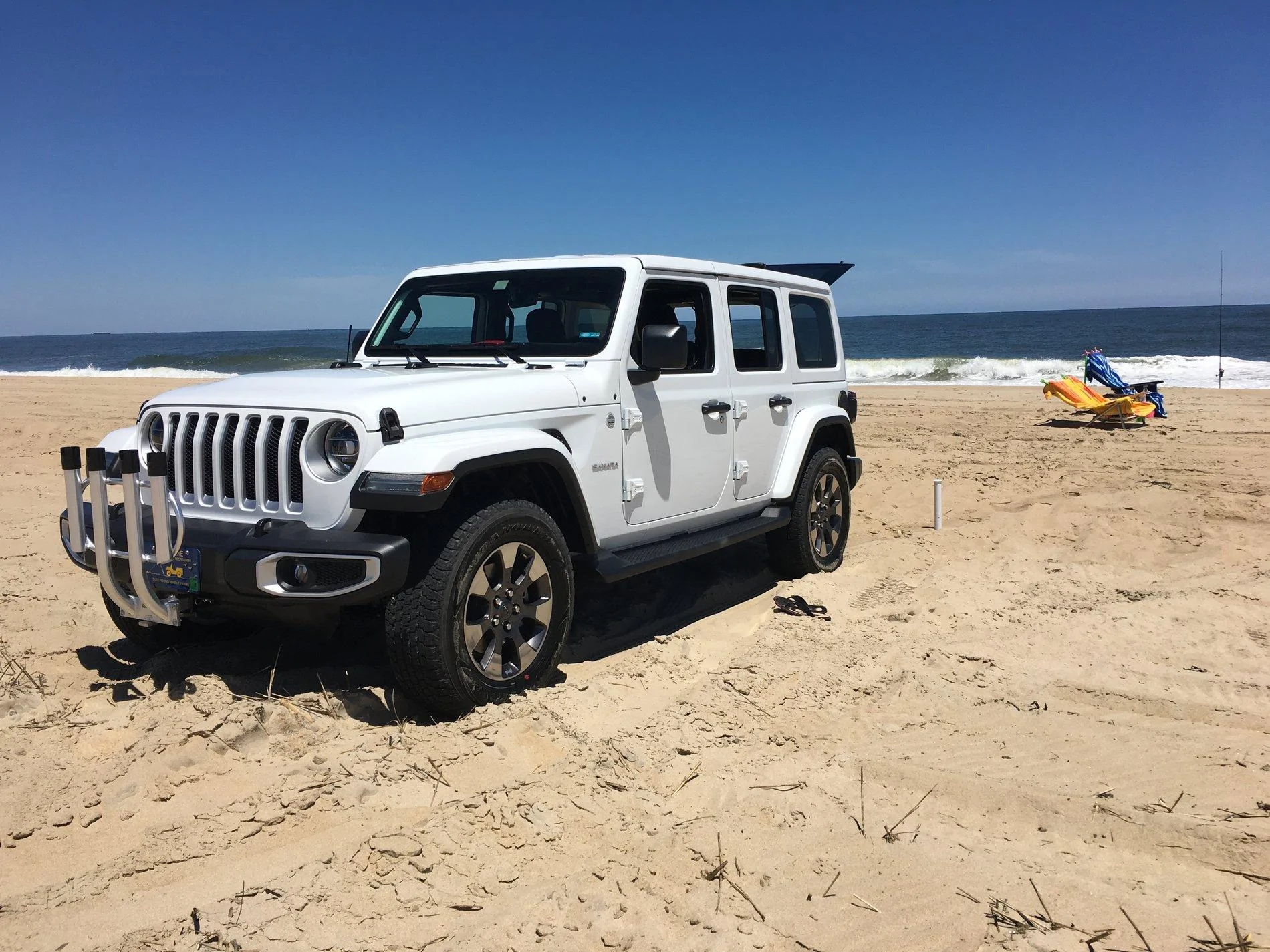

Sand Flea
Kevin
Apr 15, 2019
432
887
Lewes DE
2025 JL Wrangler Unlimited, Sahara
Federal Firefighter, Retired
you should really air down to less than 15 psi for desert sand.
beach sand is wet, its packed, the desert and the dunes its dry and sugary.
You did notice my photo, didn't you? :LOL:
Jeep Wrangler JL driving on the sand issue, traction control ? IMG_6014
