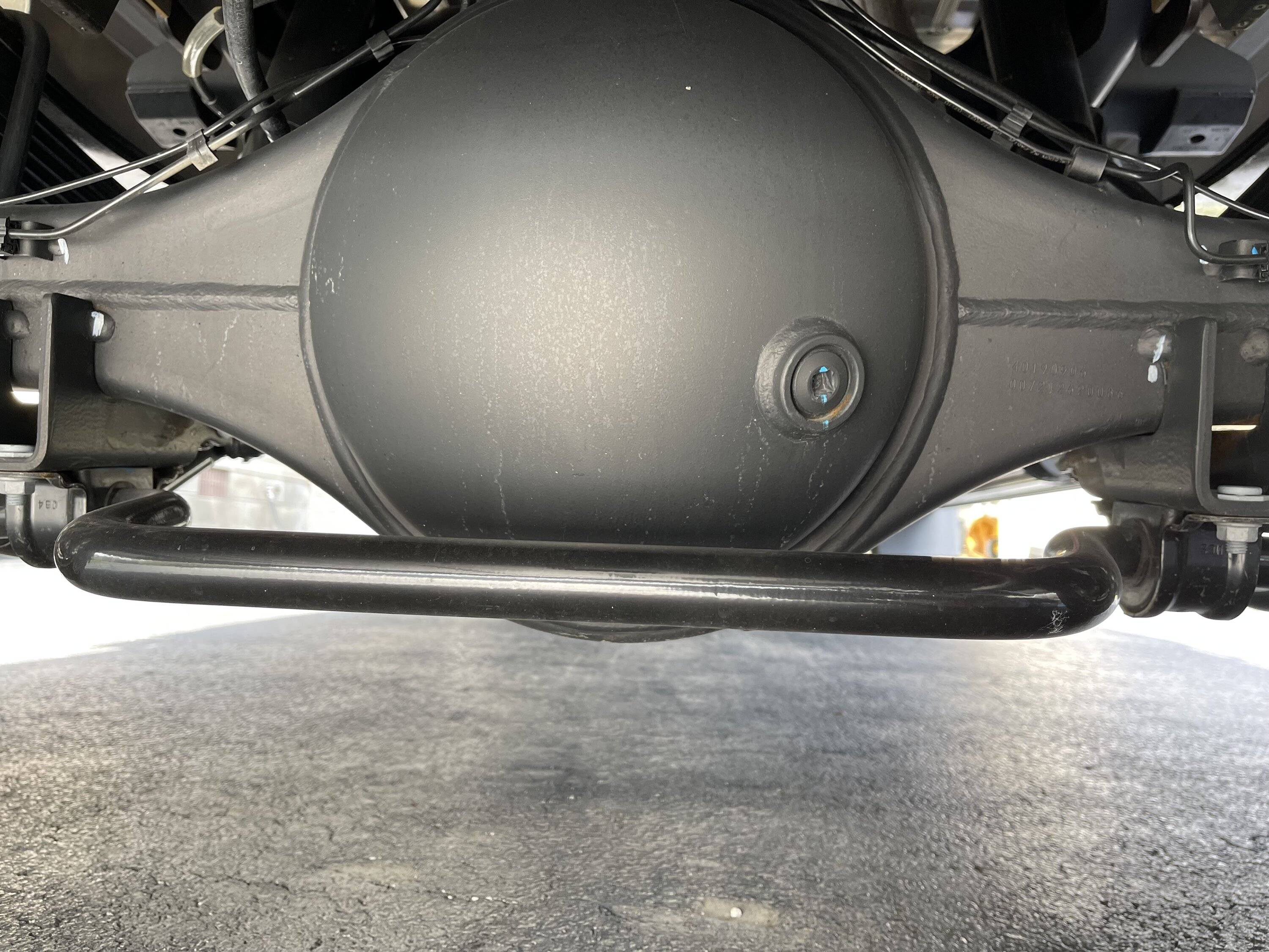

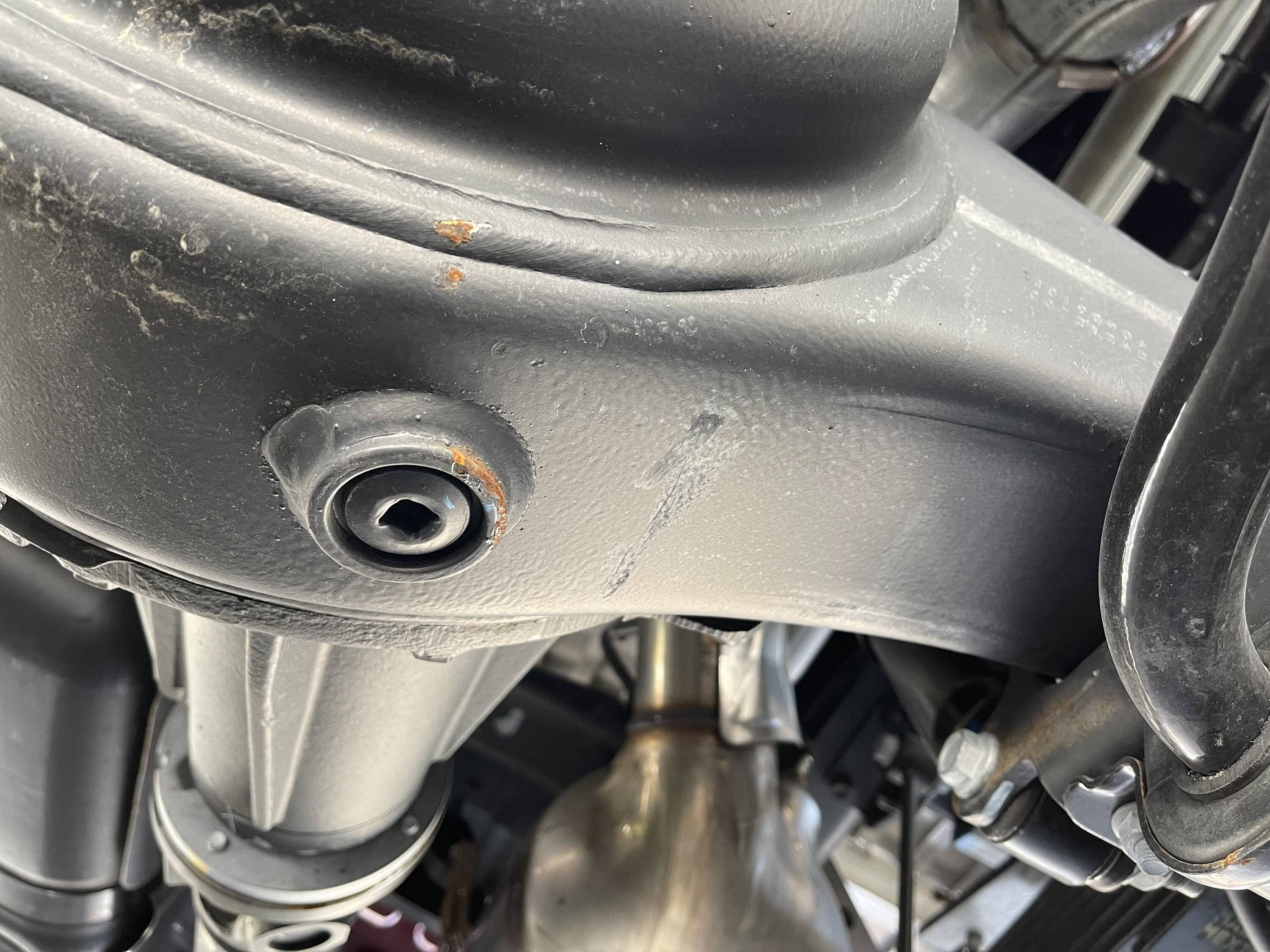

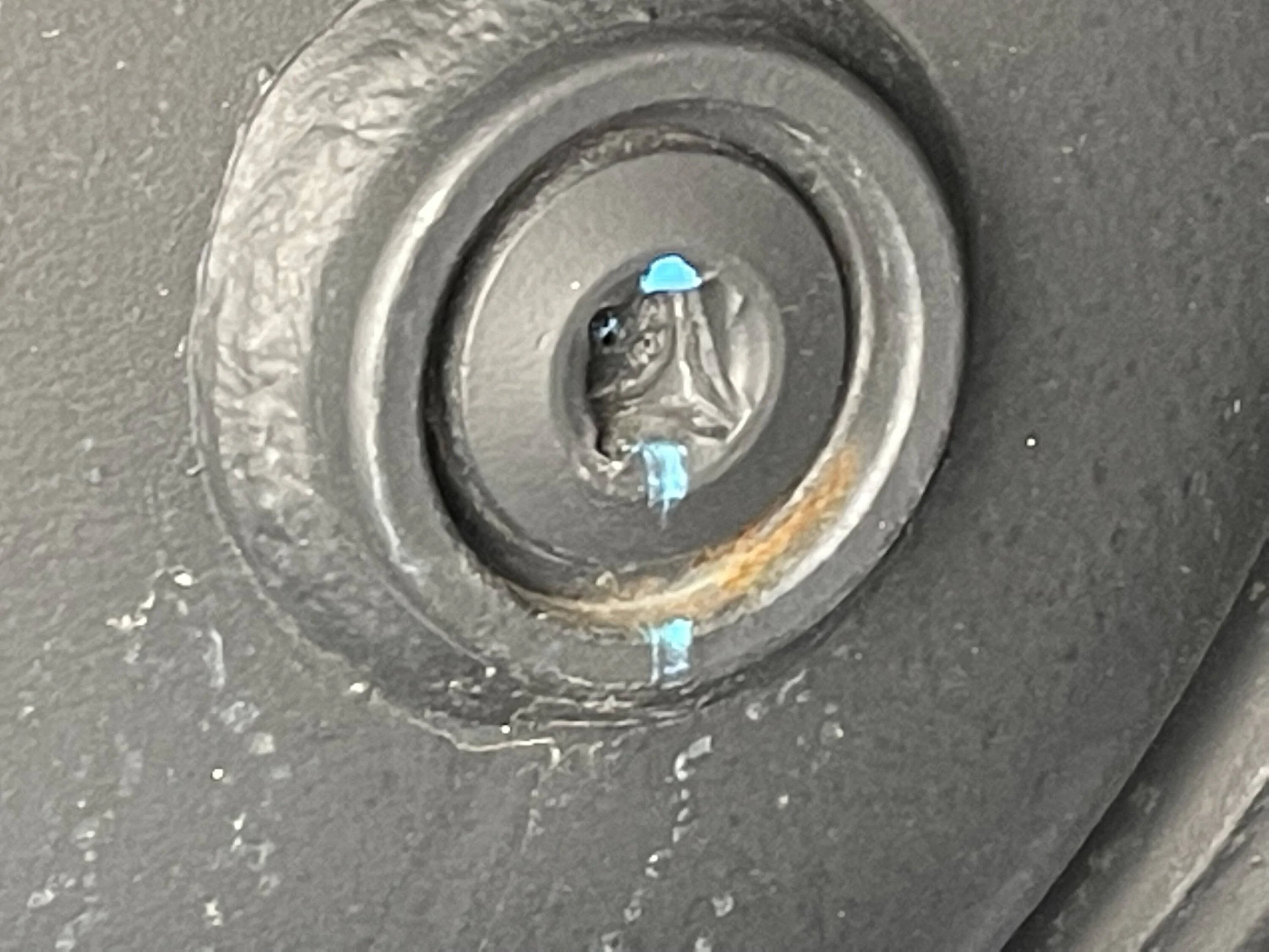

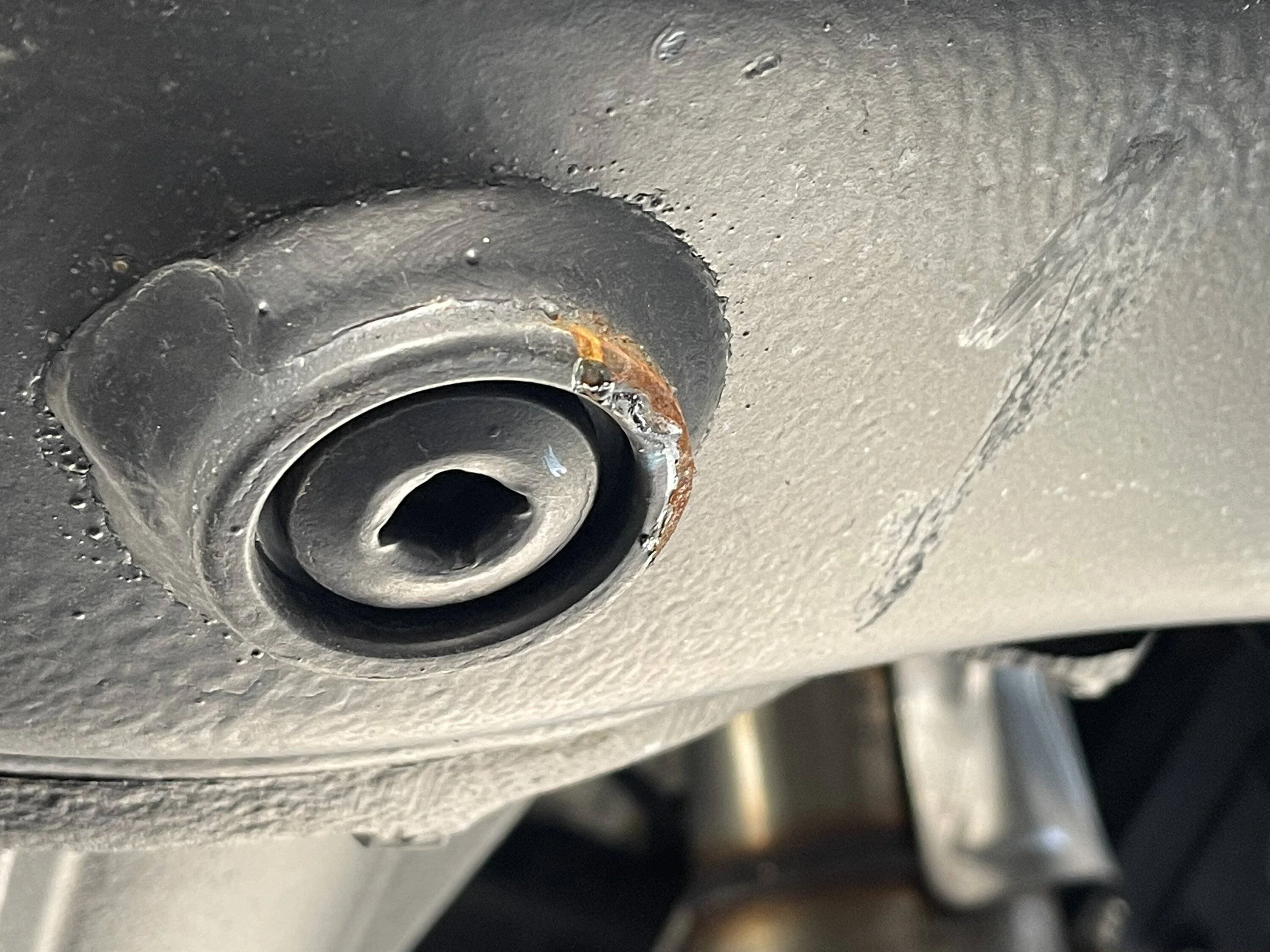

So does my 2022 RAM 5500; bad part is, it has no rear differential cover….so drain plugs are my only choice for fluid changes.
If you ever smash up the drain plug, something like this works well:
Suction Gun
These things are hard to find on parts store websites. Searching for "fluid transfer pump" usually won't find them. Search for "suction gun".
They're on the shelf at any auto parts store next to the oil change stuff.
And maybe get one for gear lube, and another for ATF, so you don't cross contaminate.
