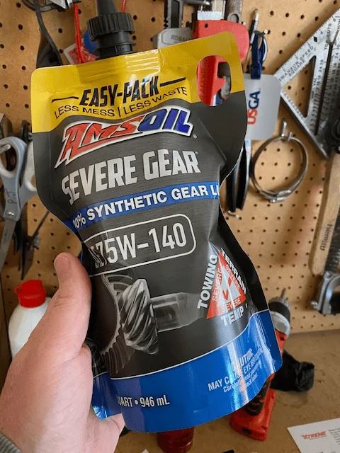

I don't know or care so much about MPG - my last vehicle was an '06 V10 F-250 w/ 4:30's..maybe saw 10 mpg or thereabouts. Here is what I am using for the diff:
Jeep Wrangler JL Differential fluid 1708798796374
Nice! I was between AMSOIL and Valvoline squeeze packs when I did our RAM 1500 last week. First time doing it and good practice for the Jeep haha. I read good reviews from both so figured I couldn't go wrong. I ultimately chose Valvoline because it was more readily available in town and was about 1/2 the cost as AMSOIL. I'm not sure yet which I'll use for my JLUR but at 2400 miles I have plenty of time to decide.
