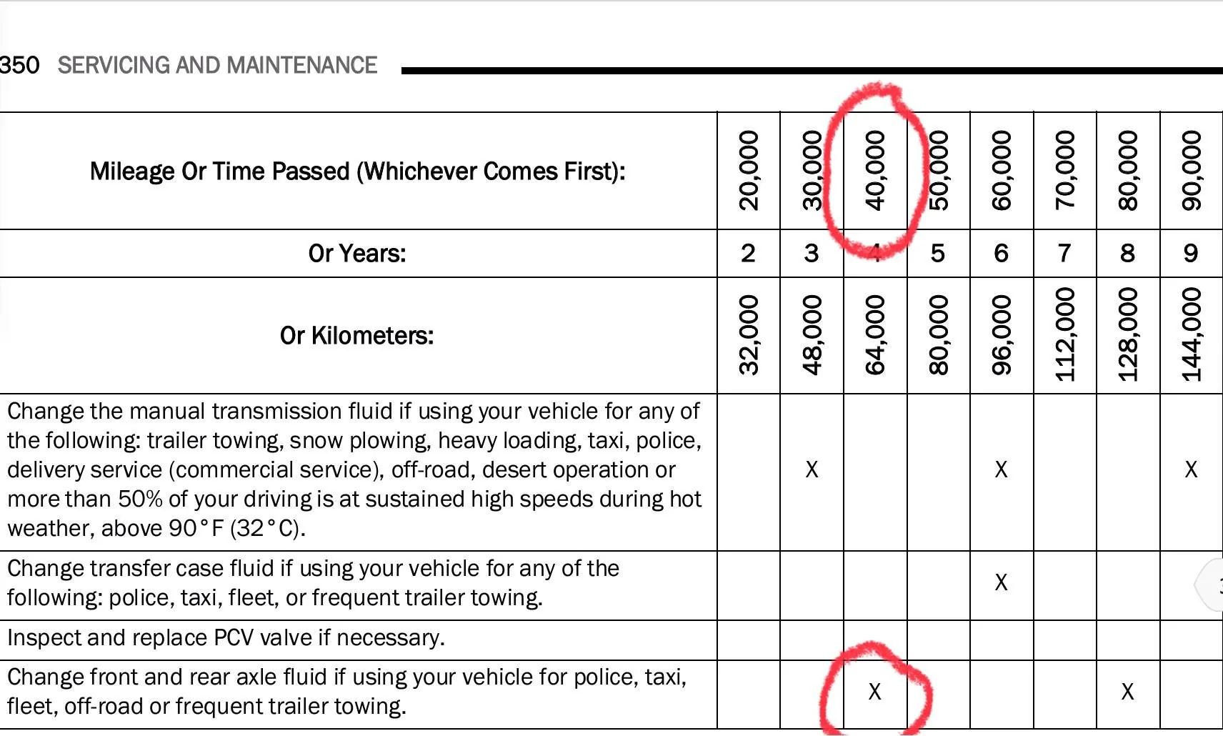

I live off road. Yes I do. Just what I have done with all my vehicles for the past 40 years.
I’m assuming you know the owners manual suggests a more frequent interval if towing or off roading. No judgement, it’s your Jeep. If frequently off-roading I would want to inspect and change the diff oil far more frequently than even the owners manual suggests, but that’s just me
Thanks for the information. I’ve never seen a vehicle owners manual that recommended that frequency of differential fluid changes. I will check that out.
