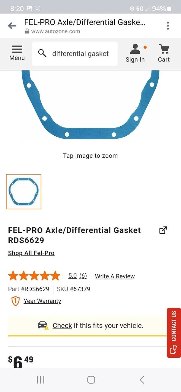

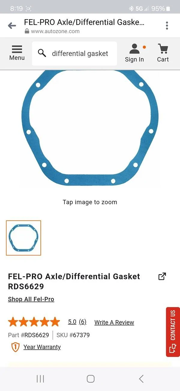

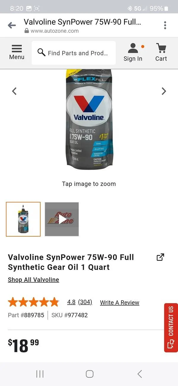

Hi, I have a 2018 JLUR 3.6L 8AT and going to change out the fluids out myself for the first time.
Are these the correct products I'll need?

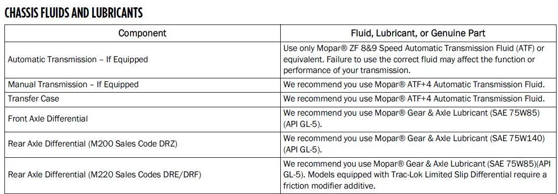

From 21 Owner's Manual, IIRC 75W90 is easier to source. Consensus seems to be 140 is preferred in the rear over the 85.

All you have to do is drain the fluid and fill it back up? So I don't even need new gaskets right?
Regardless, stock gaskets are reusable, similar to lube locker brand gaskets.

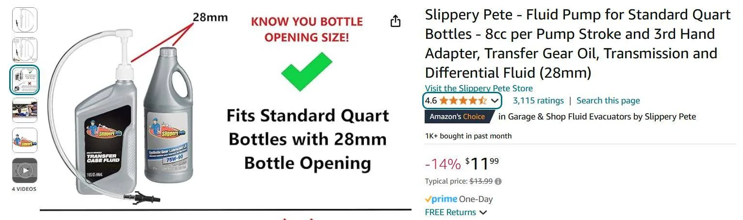

Yea you shouldn't need to open your diff, it was a few years later the drain plug was nixed from production.
Someone advised somewhere about using bottles with a pump and that made the job easy peazy.
The valvolone flex fill bags also work well without the pump.
I’ve always used the flex fill bags but the last diff change I got a good deal on the gallon jug and decided to try the pump. Maybe it was just me, but I felt like the pump made a bigger mess with the fill hose dripping after you pulled it out ( insert joke here). I’m going back to the flex fill bags.
