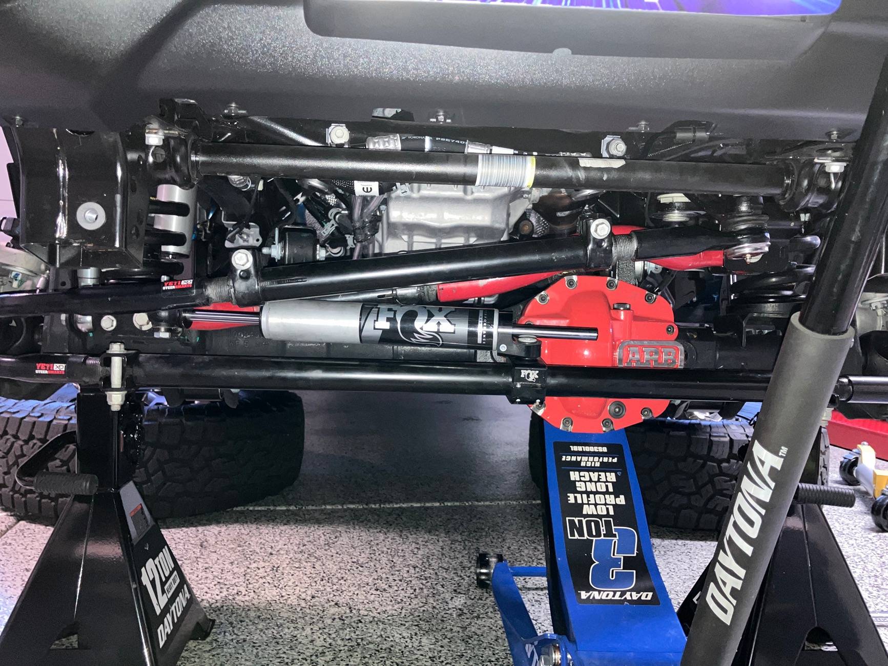

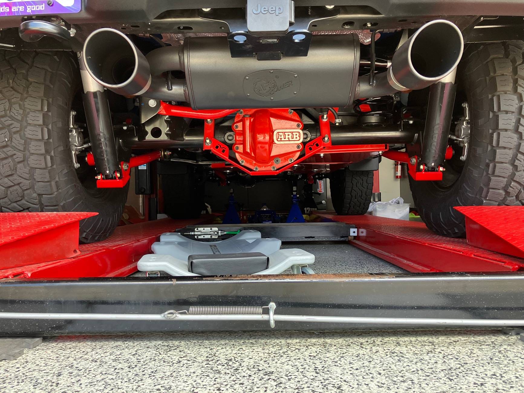

Fun thing to do, change out the stock covers for one with a fill and drain plug. That way you don’t have to make a mess next time you change it. I wanted the ARB differential covers, easy peasy
Jeep Wrangler JL Worth getting the differential fluids changed? IMG_3953
Jeep Wrangler JL Worth getting the differential fluids changed? IMG_3784
