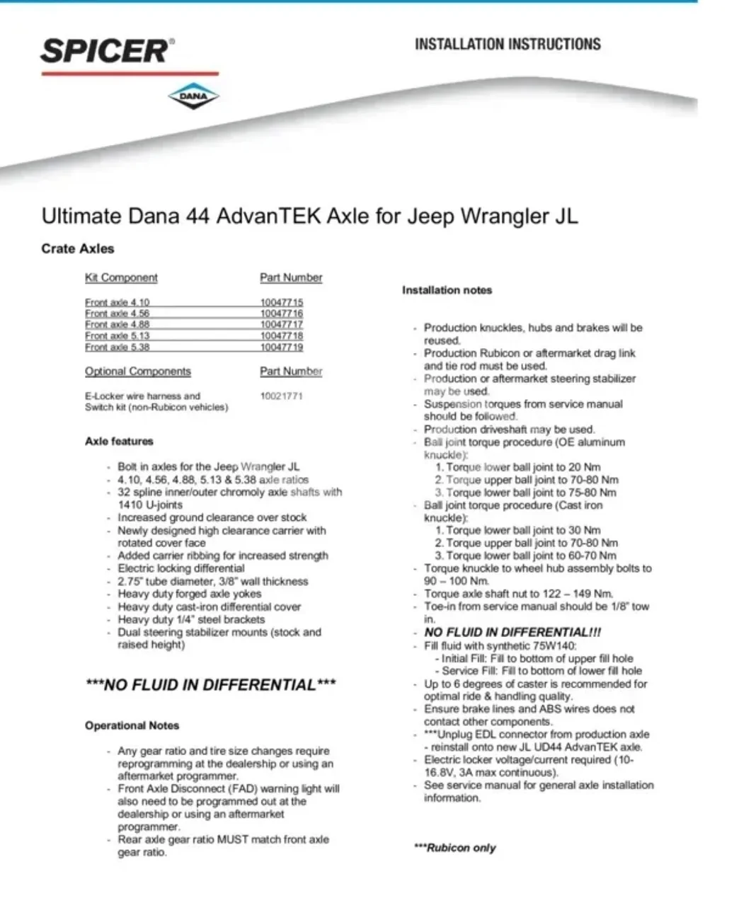

You see the gear oil weight suggested in the link though right? Or am I misunderstanding what you’re asking or trying to prove/disprove here?
https://spicerparts.com/parts/axle/...a-44-advantek-front-axle-for-jeep-wrangler-jl
yup. and perhaps.
wasn't necessarily about trying to "prove/disprove" anything; just couldn't find that spec online anywhere, and like to verify/validate. now appears it's a copy of a file someone saved of something someone else made years ago, so possibly no longer available online (and possibly no longer accurate).
Right? Like how is "rebuild specs" different from what they want it to run before it is rebuilt?
can't know without validating, and i wouldn't be assuming.
forgive the apparent skepticism, but i've made a living in part by validating or debunking stuff. getting to the source (and a second source, if you can!) is a Good Thing.

Or a crate axle if that’s close enough. Really follow the owners manual or follow Dana Spicer literature, get a diff cover that adds volume and takes a few more seconds for the gear oil to get hot, get super duper secret high tech axle covers I bet it isnā€˜t worth getting wrapped around the axle over…best bad joke on the spur of the moment.
https://dml.dana.com/assetbank-dana/action/viewAsset?id=78043&index=4&total=5&view=viewSearchItem#
Jeep Wrangler JL Rear differential fluid change IMG_0919

yup. and perhaps.
Ok I posted a better link for you. It felt like youā€˜re wrong but I don’t feel like proving why. I guess I read into it.

so far, links we've seen (that we can attribute to Dana) have sometimes called out synthetic lube, and other times they haven't specified synthetic or not. conflict, or just a lack of specificity?
even our J**p manuals specify 2 different weights.
Eaton will specify a non-synthetic if you use one of their gear-driven limited slips in the same axle.
not clear there's a huge difference in what you use if you're keeping it fresh and clean.
Whenever I’ve been that curious about something I usually contact tech support directly, usually by email just so I have something to go back to rather than when the question comes up just saying Joe at Dana Spicer told me blah blah blah. But in this case Iā€˜m not feeling like it’s that important to me at least. I change my diff fluid far too frequently and I am more concerned about my 3.6 grenading than what diff fluid I run…only partially joking.
