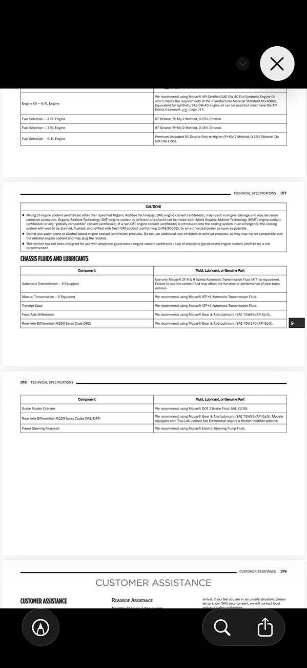

morning all, its time for my first diff fluid change on my 25 rubicon x, I have the dana44 front and m220 rear. Curious what weight diff fluid people are using. looks like according to the manual it says 75w85 for front and rear but would I be better off going with the 75w140? I know youre probably rolling your eyes at another what weight oil thread but i could definitely use the help!
