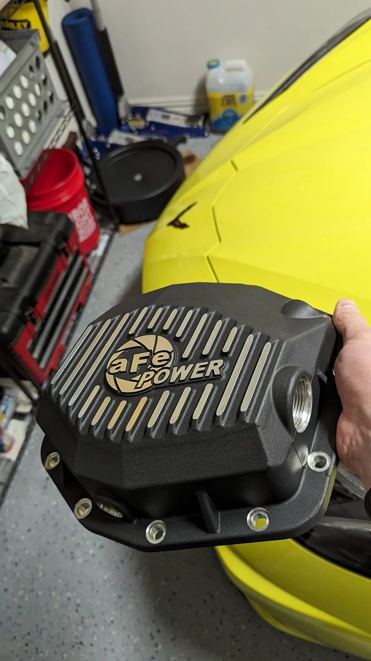

We have the aFe cast aluminum cover on the JL and have been all over the country without issue; run Redline 75W-85 in it.

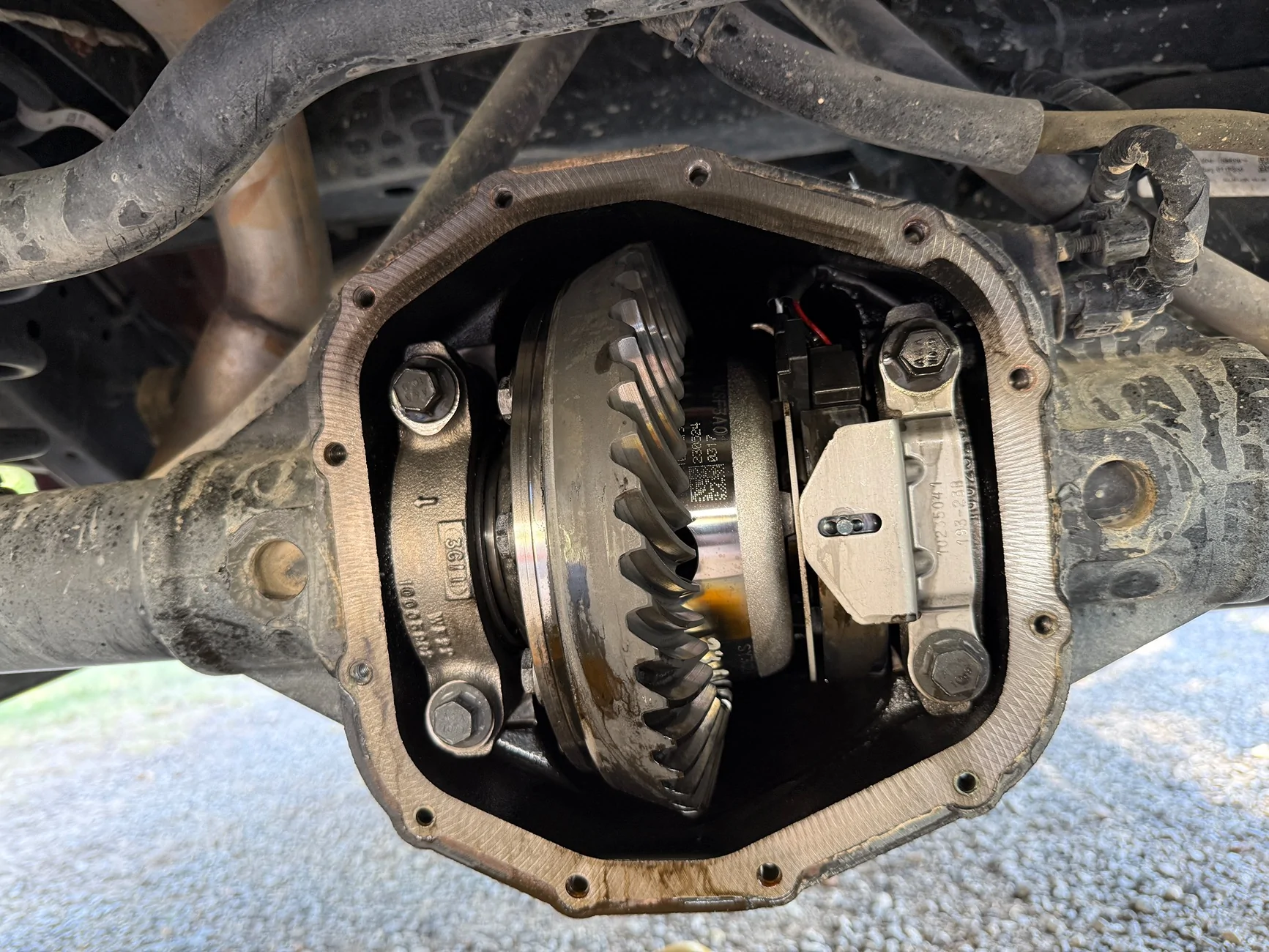

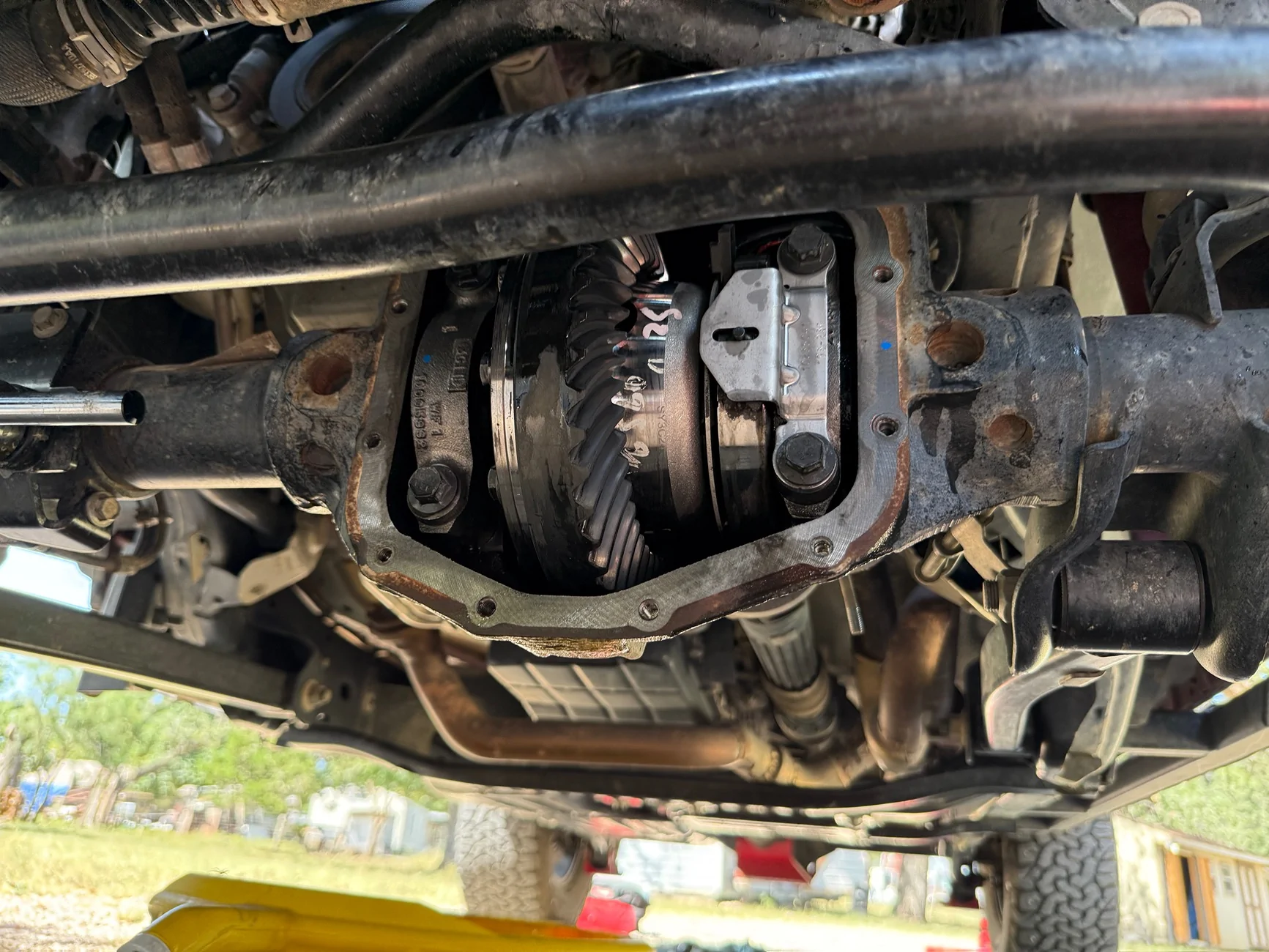

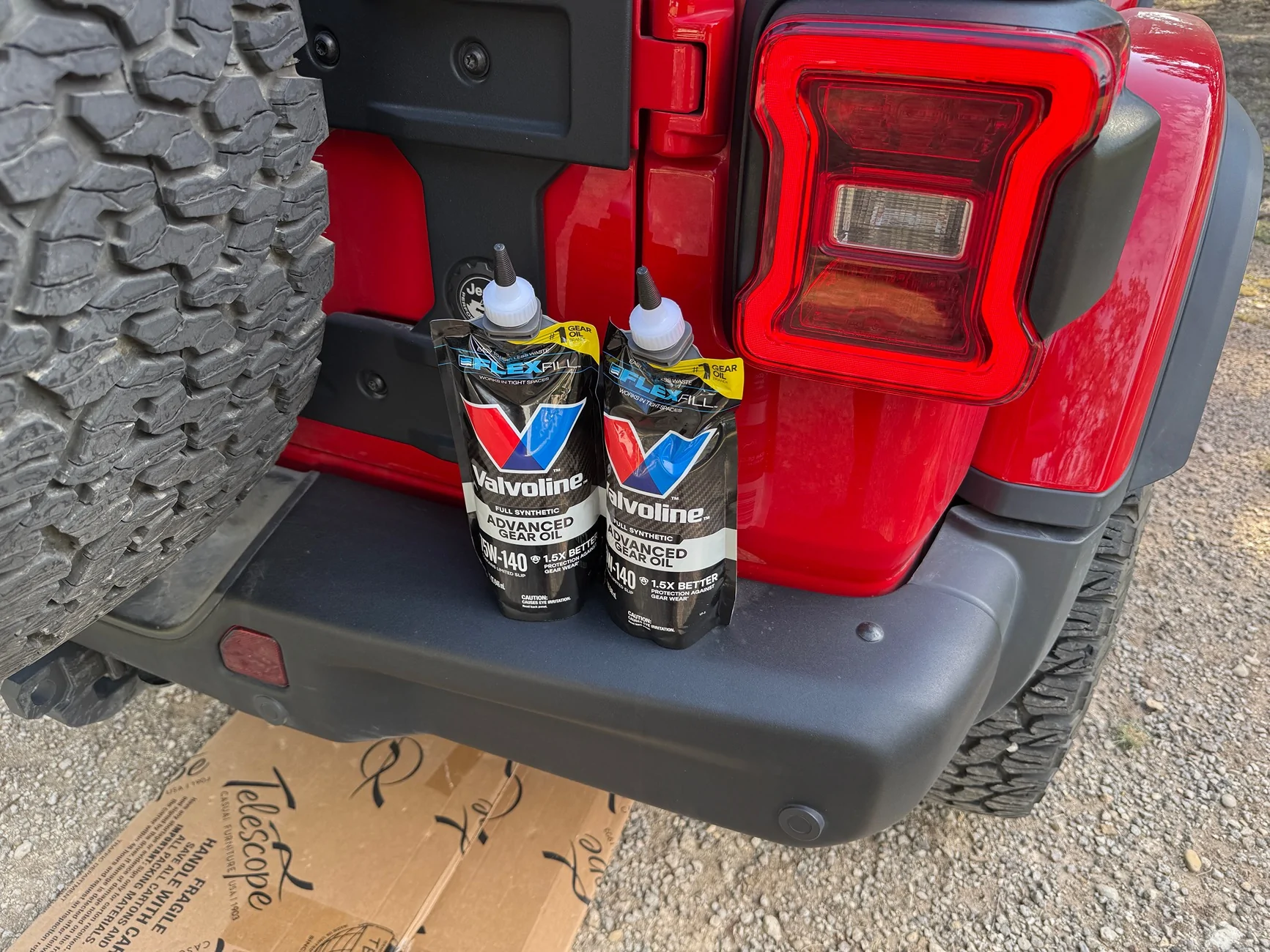

That’s weird. Just replaced front and rear for the first time. Currently have 42,000 miles. Everything looked good.

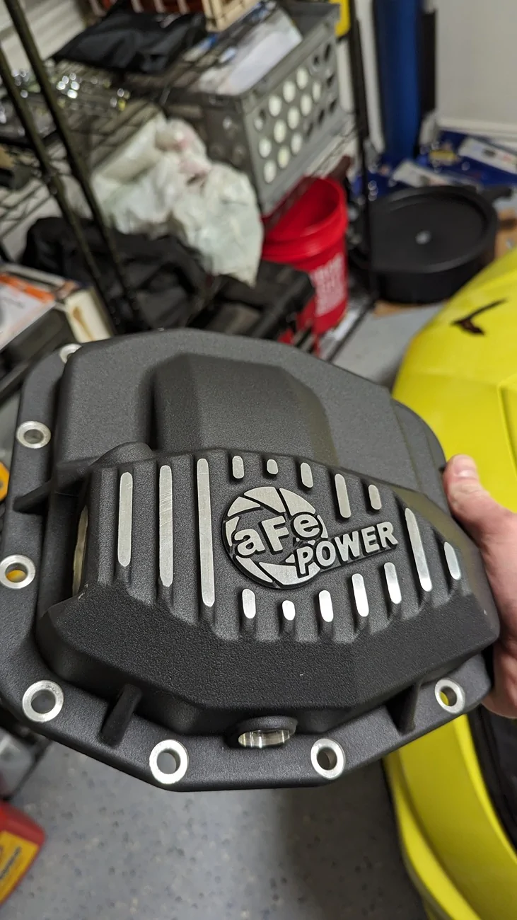

Kracka
Christopher
Feb 2, 2023
643
870
Oak Point, TX
C8 Corvette, 19 KL Trailhawk Elite, 23 JL Rubicon
It seems to me that towing and rear lockers are often a combo that creates a ton of heat and causes issues, not isolated to just Jeep. Full sizes see it too but there are a million options for housings that increase the volume of oil and provide some cooling in the form of finned covers in the full-size category. I haven’t seen any covers for the JL that advertise increased capacity. If there are any out there that may be the solution.

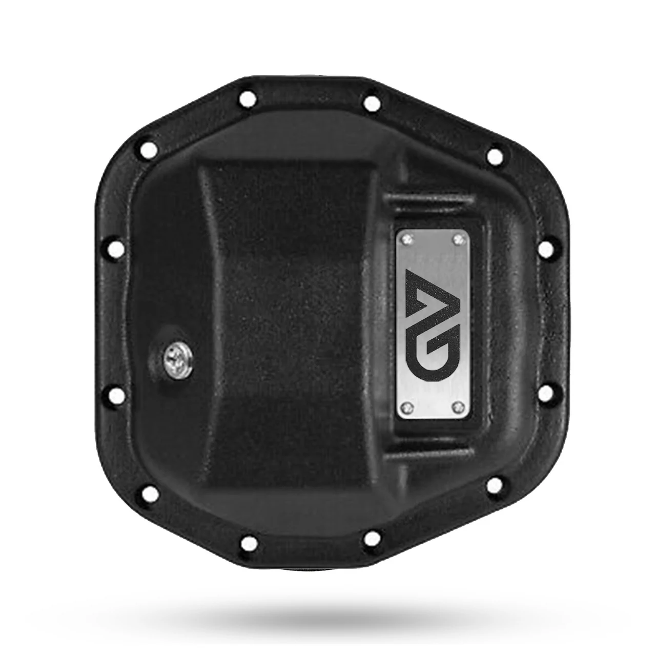

also worth mentioning I'm running aftermarket diff covers in the front and rear

i'm always suspicious of the oil flow in most aftermarket diff covers.
