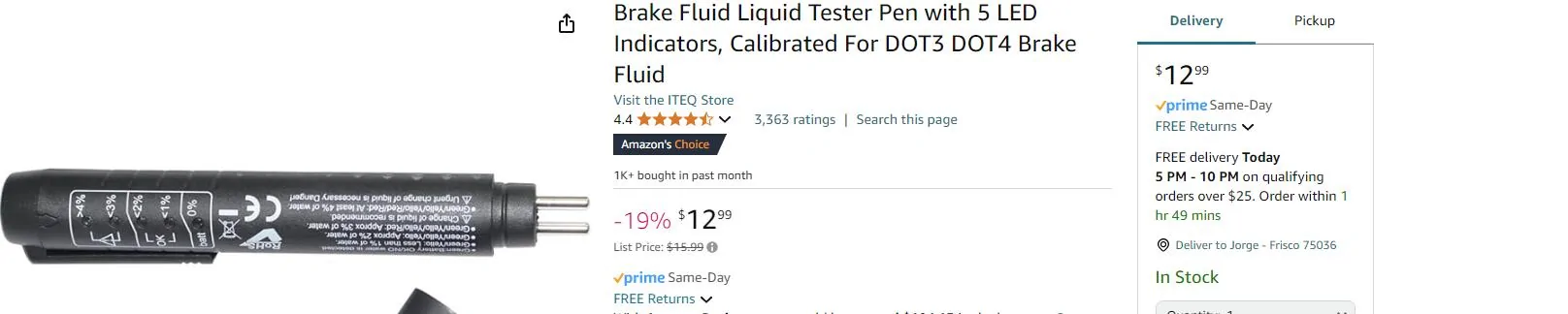

I’d test the brake fluid before changing; May on need it.

IT
You can purchase one of these to test the brake fluid.
