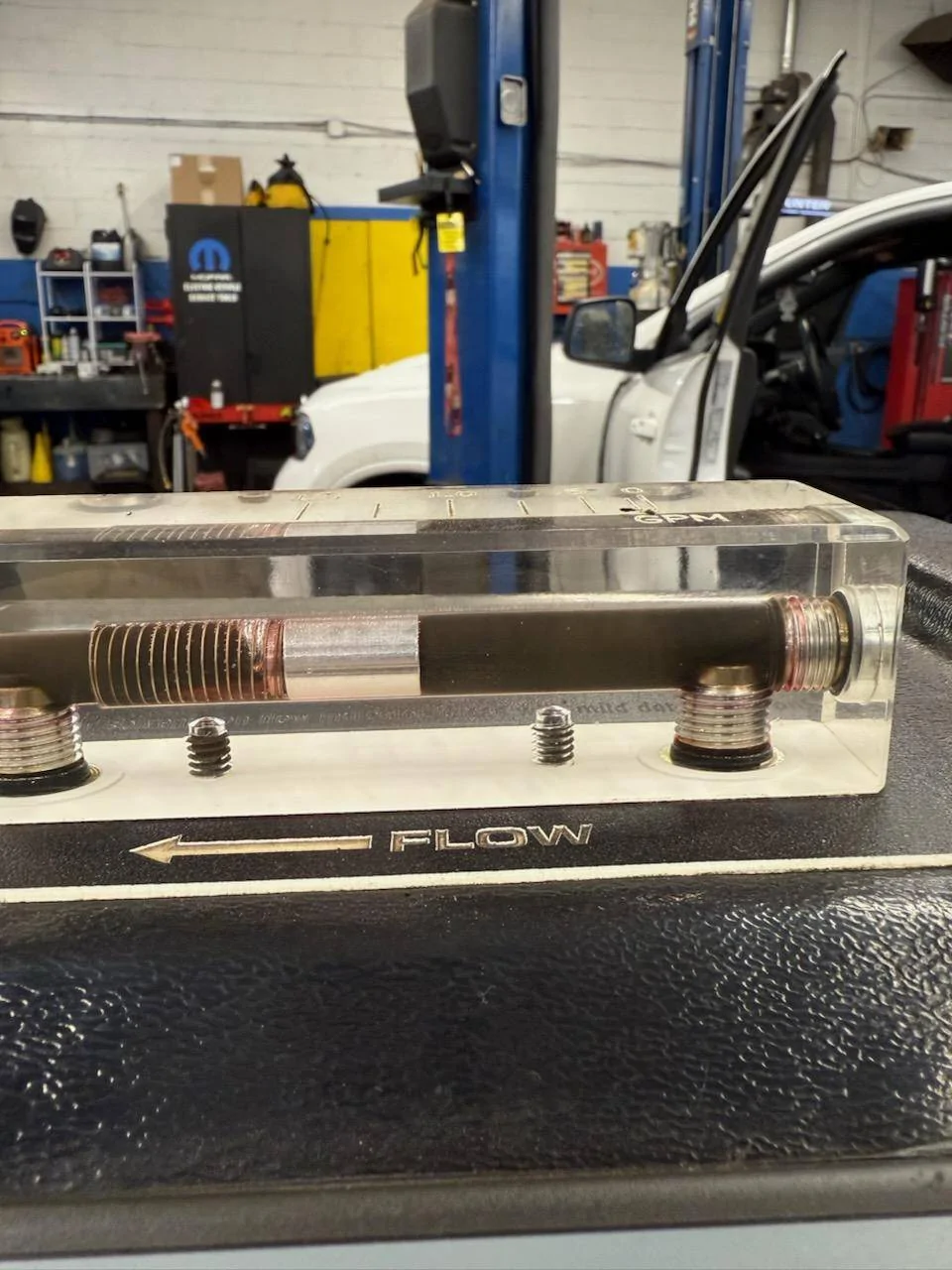

Just a follow-up to my earlier post.. The BG flush machine was only used as a tool lets say, to take the old ATF out and at the same time supplied new ATF to the pan .......while visually being able to actually monitor the fluid going in and out... The pump in the transmission did/does all the work to push ATF through all.
No BG cleaning solution was used for this service. BG machine was just used in the removal process of all old fluid in tranny and add of new fluid pretty much simultaneously.
Yes, BG fluid was used for the replacement fluid.
Anyway, actual BG Service was not performed, but I did use the BG machine and BG ATF. My first post with pics does give one the visual lets say that the fluid was indeed in need of changing..
Whether to use a machine to do the remove/add process is always a debated topic lets say... 8-)

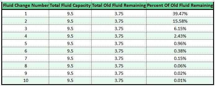

The system capacity the ZF 8HP (aka 850RE) in the Wrangler is approx. 9 quarts, of which only 5.5 quarts or so will drain out after the pan is removed. That's why at least two drain & refills (three is best) are recommended in order to maximize the replacement of old fluid with new. That's what I did, driving the vehicle 1K miles in between each DIY service.
Here is a matrix to visualize what you are describing:
Jeep Wrangler JL TRANSMISSION FLUID change or not? 1729958585870-gg
