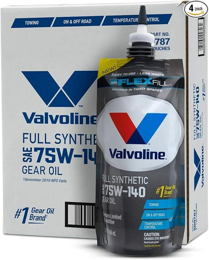

I just changed my fluids. Easiest thing in the world to do.
I use 75W-90 in the front and 75W-140 for the rear, just because I have the towing package and my LSD will be used more in sand.
Even if you choose 75W-85 or whatever the Jeep manual says you will be fine. Some here recommend using what Dana says - and that is no doubt good - and it may be different than what Jeep says in it's manual, but if paranoid (understandably) about any warranty issue.... it will be Jeep that will be analyzing and fixing it, not Dana.
Oh yeah, I used the bottle version and the squishy container versions - go with the squishy containers ;)
Oh yeah, I used the bottle and the squishy container versions - go with the squishy containers ;)
@Gunfighter
Your JL will be just fine with the gear oil choice you made for it... Were it me though I would run both 75-140 just because Dana recommends it.
Most JL's see little to no front diff use so diff fluid choice for front for those JL's is kind of a moot point.
Yes, diff fluid change is easy easy.... but a guy gal can have/see issues.... Example they drain the diff fluid and they then, cannot get the fill plug loose/off. They should have removed the fill plug first but they did not know that was a prudent thing to do.
As for warranty concerns.... dealer is not going to .... or will they bother to try to ascertain what fluid you actually used.
Tell dealer what they want to hear you used / what they/Stellantis wants you to use ....and that is all you need to do. Don't ever give the dealer any ammo for their gun.
Just don't spew you used something they don't encourage, as yes, the dealer will undoubtedly run with it so to speak.
Yes, flexi containers are terrific to use!
