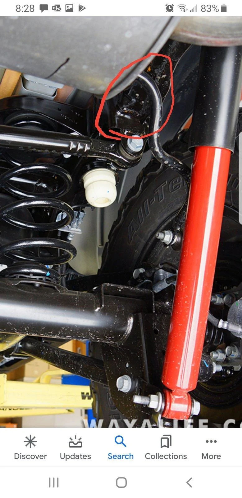

Its if rear frame rail is bent abit in the location circled - insurance will total it. I bought one that had rear frame rail pushed down from a rear end collision, granted had more damage to body (tailgate and quoterpanel)
Jeep Wrangler JL Crash Screenshot_20200722-202938_Googl
