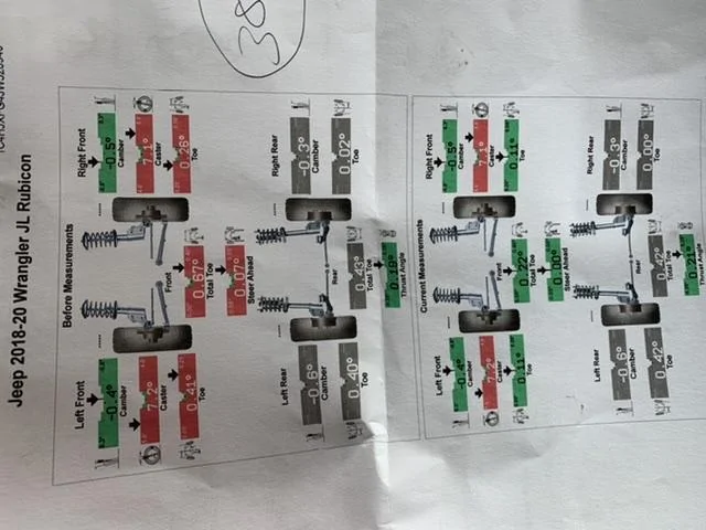

I just had my ‘18 JLUR aligned after installing 2.5” Teraflex ST2 lift. They said that the caster is not adjustable? It’s at 7.1 . I’ve seen others in this thread saying 6.0 is ok? How to adjust if it’s not factory adjustable? Caster kit?

Same reading with my 2door JLR , My caster is at 7.4 and they said its not adjustable...it drive straight and feels solid on the road. Will a new front driveshaft make a difference ? my lift is the danatrac euro 2 with .5 load spacer so exactly 2.5inch with new teraflex sport LCA..

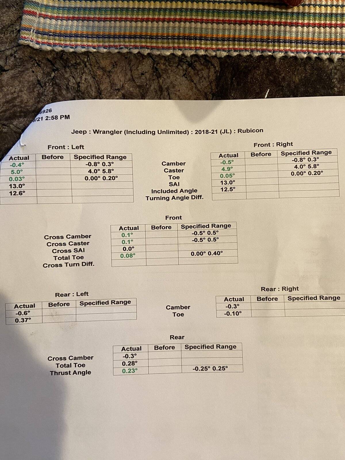

So I had the Mopar lift put on at the dealership. I have 315/70/17 KO2 with 33psi. I don’t do any wheeling just fire trails. I have the new sterling box and Fox steering stabilizer. My Jeep wonders much more than before. Here’s my alignment sheet. If I need to add longer LCA I would like to go with no maintenance LCA. Please help with suggestions.
Yeah, you’re in a Rubi, they are already low on caster, combined with you probably got more than 2”’of lift, those lcas are useless to you now. Get which ever brand adj. lca you want and get your caster to 6-6.5 degrees, it will show out of spec on alignment sheet but that’s ok, it’s what you want when it comes to caster.

if you're looking for easy use maybe check out synergy arms. They aren't jam nuts and they can be adjusted without having to drop and end of the arm and retorquing every time.
