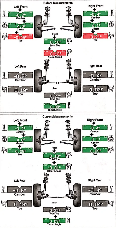

Is this good spec? With mopar lift.
I can't read them lol.
Jeep Wrangler JL Caster Specification for the JL 20190209_172019

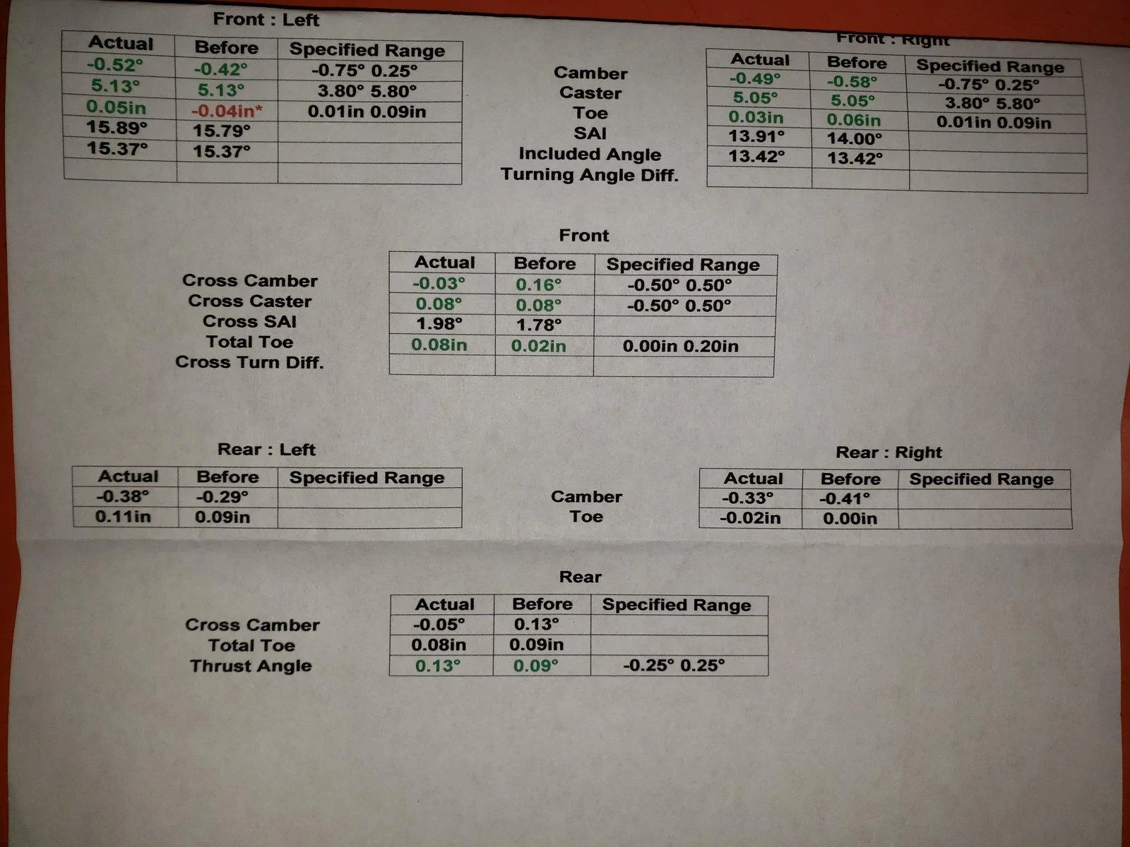

I have a 2018 JL Rubicon (so it's 2" higher then the Sahara) and I have 35" tires on it. I replaced my stabilizer with the Falcon 2.2 and I just had my steering box replaced because of my loose steering issue. Since then, I notice it seems to drift or wonder a little more then it used to. Below is the print out of my alignment. Should I invest in some new LCA's to increase my caster to help with the drifting? What LCA's should I get? I might end up getting the Yeti XD adjustable track bar, Would this be a problem with the new LCA's?
Jeep Wrangler JL Caster Specification for the JL upload_2019-3-8_16-13-53
