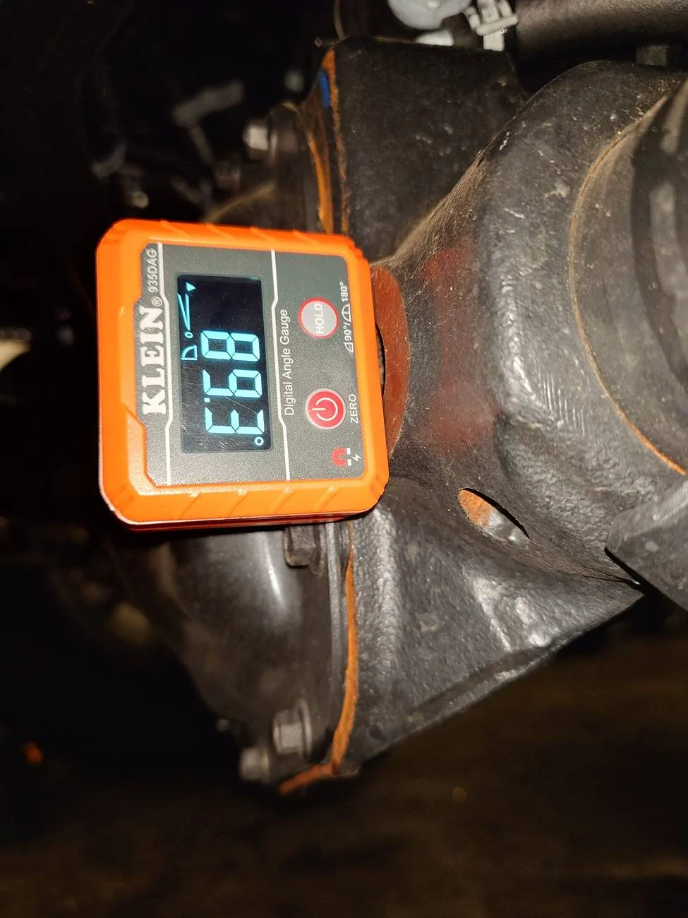

I installed the Mopar lift LCAs on my stock Rubicon and took a caster measurement.

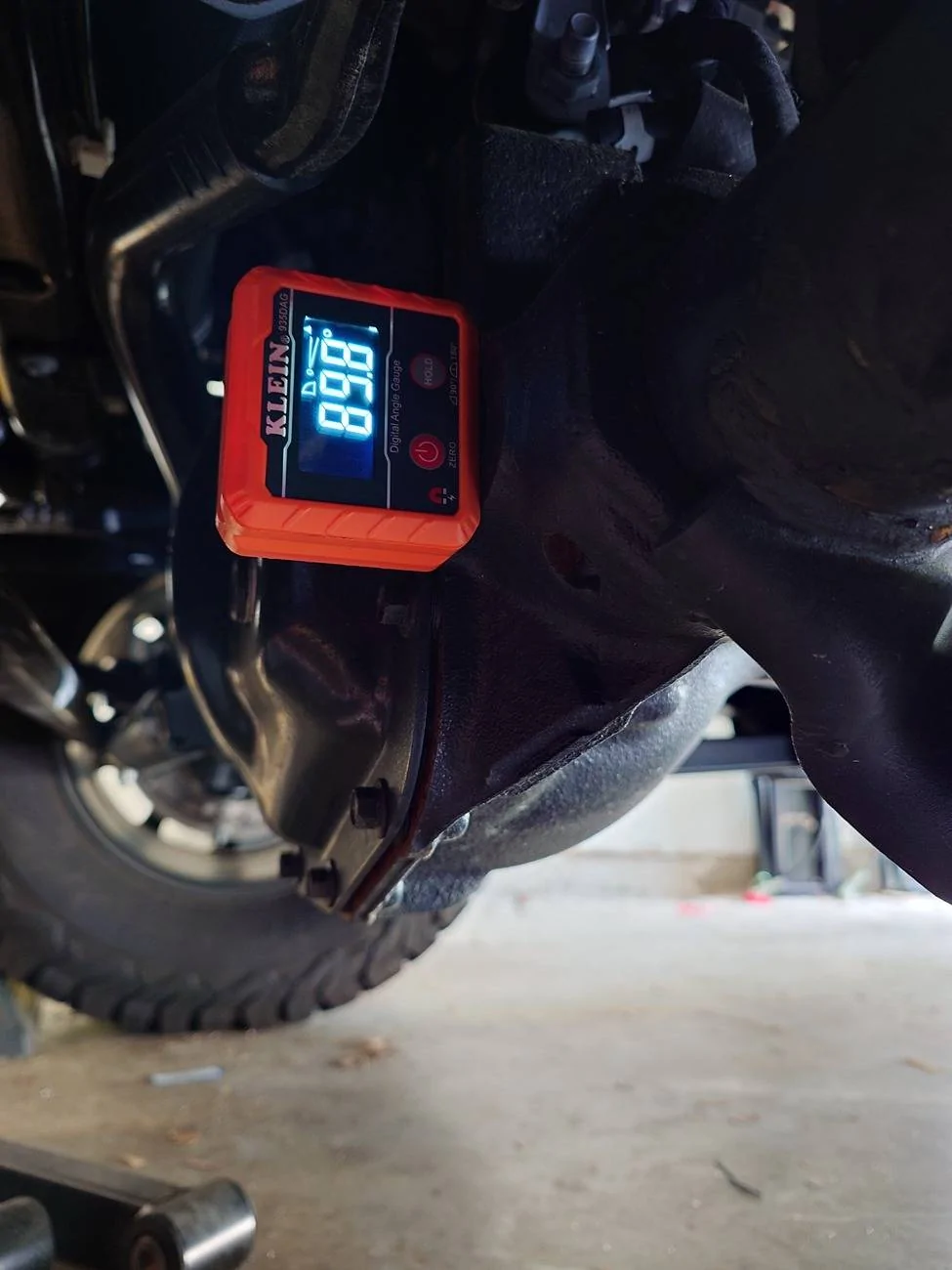

Then installed the 392 XR FE springs and shocks, then measured again.
Stock springs with Mopar lift LCAs.
392 XR FE springs and Mopar lift LCAs.
Even if my angles are wrong, I at least took measurements the identical way. So looks like I lost half a degree of caster with the 392 XR FE springs.
