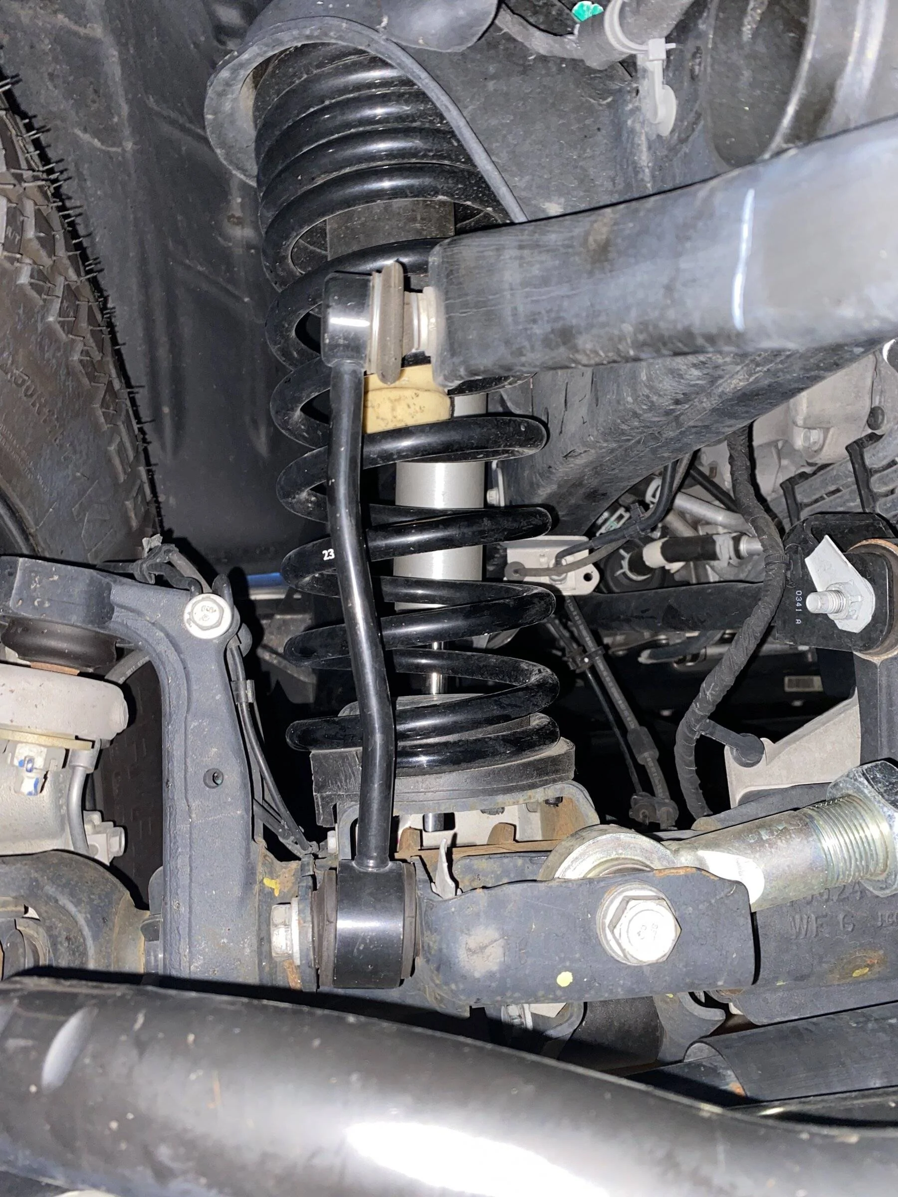

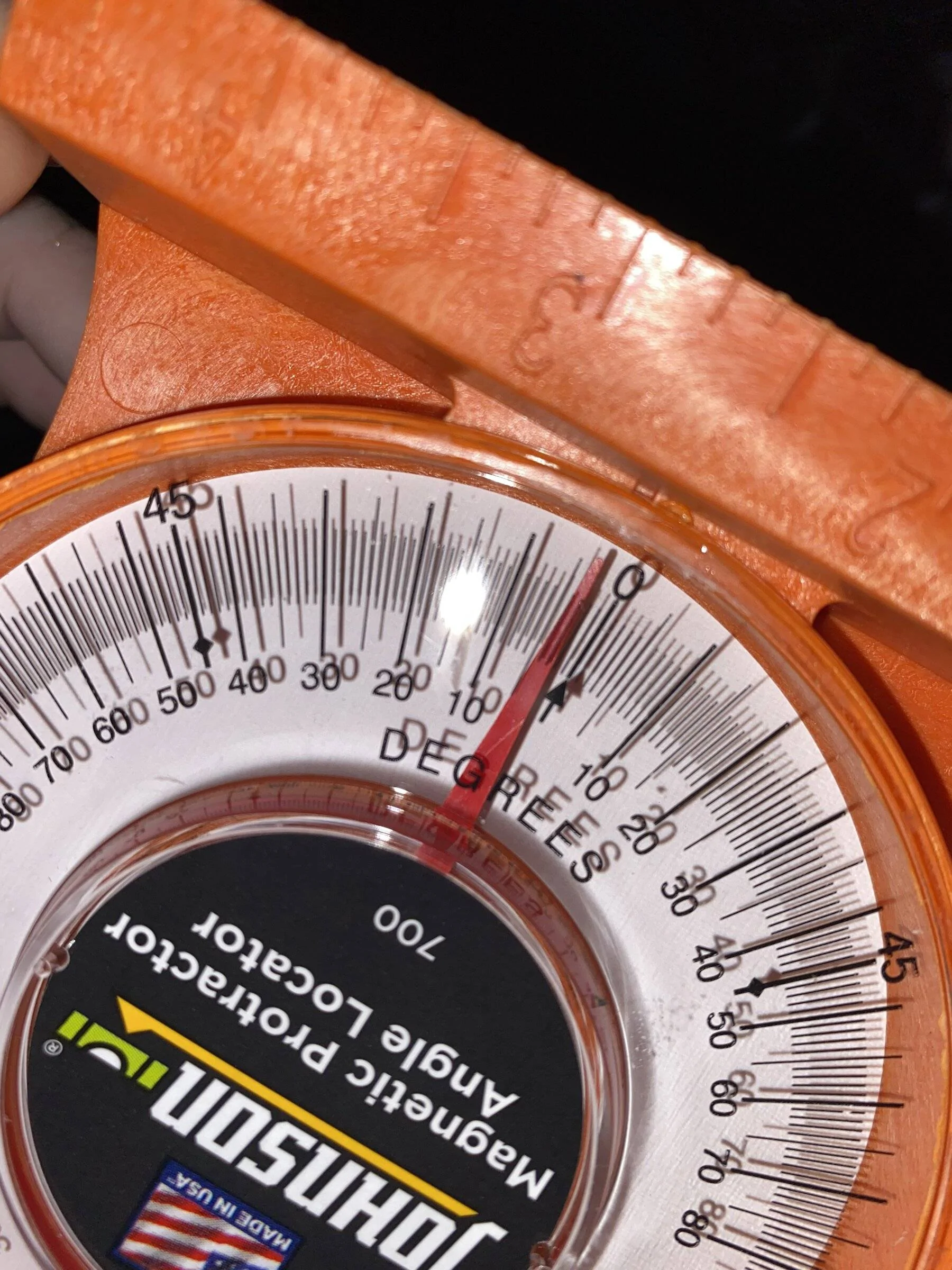

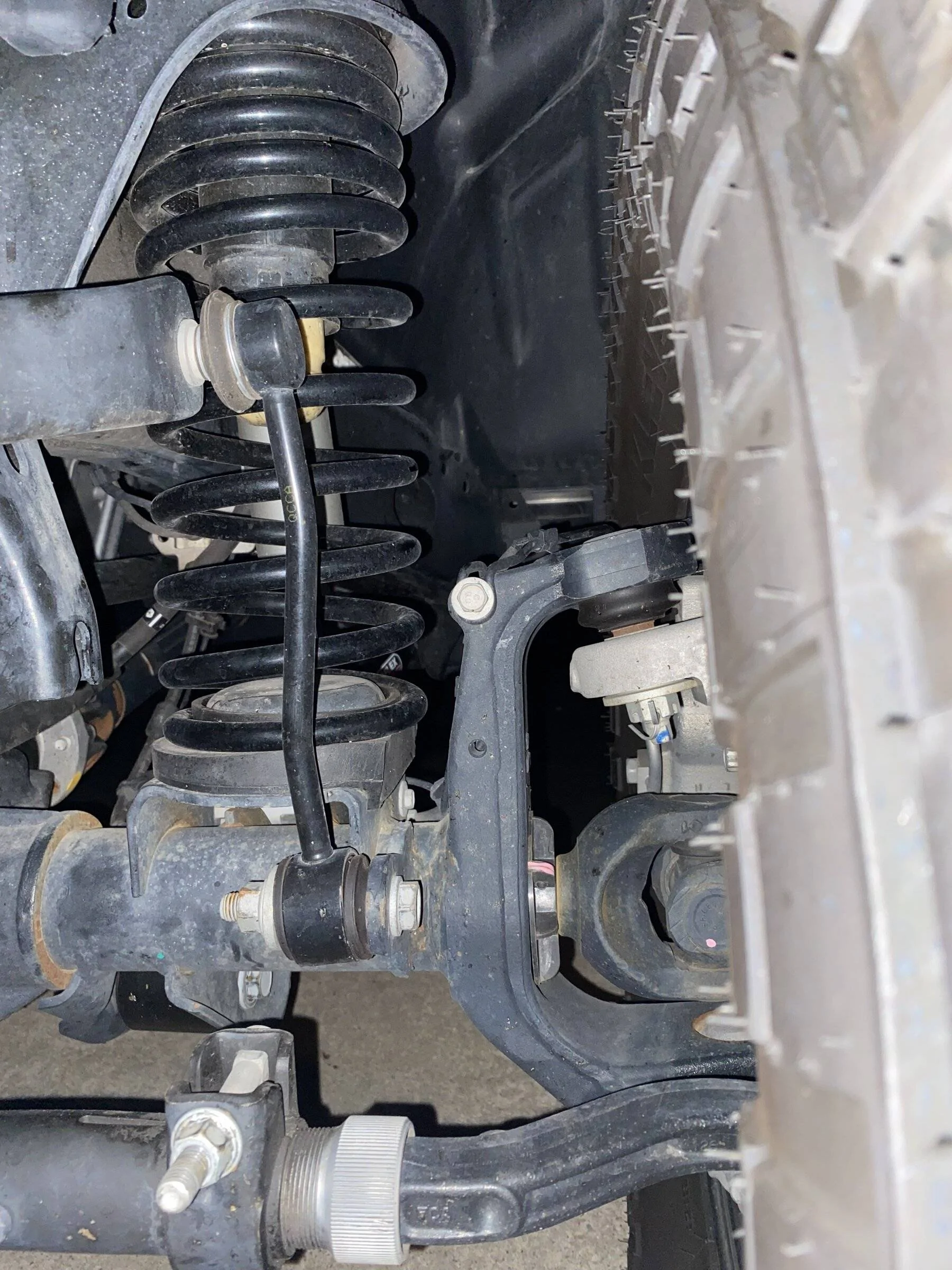

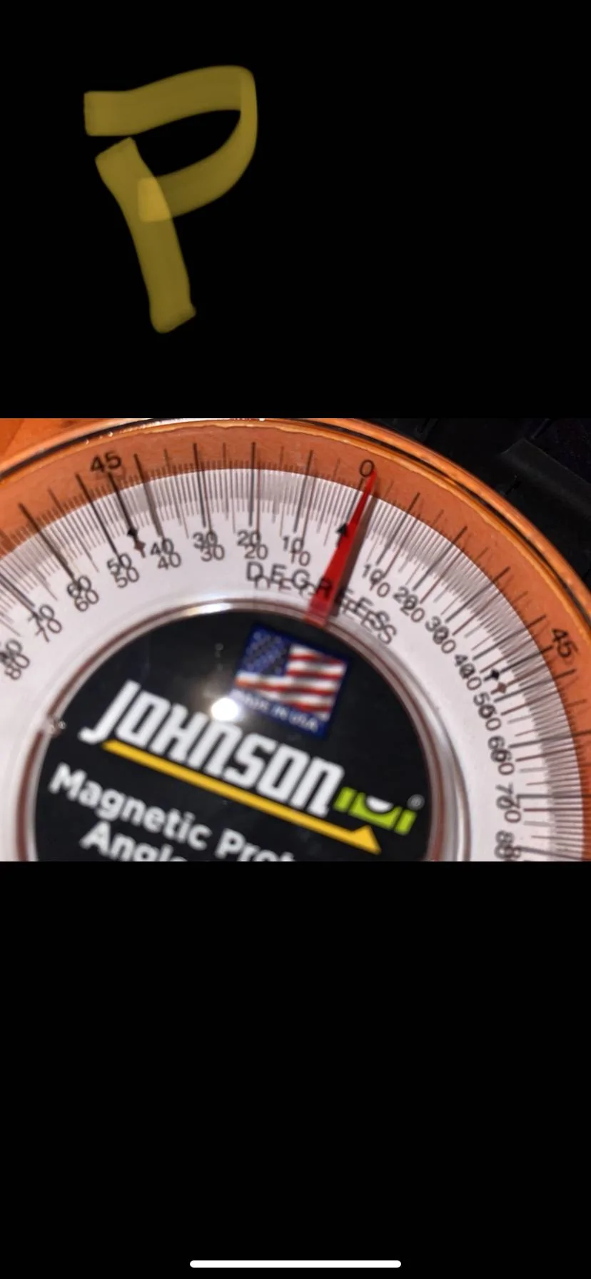

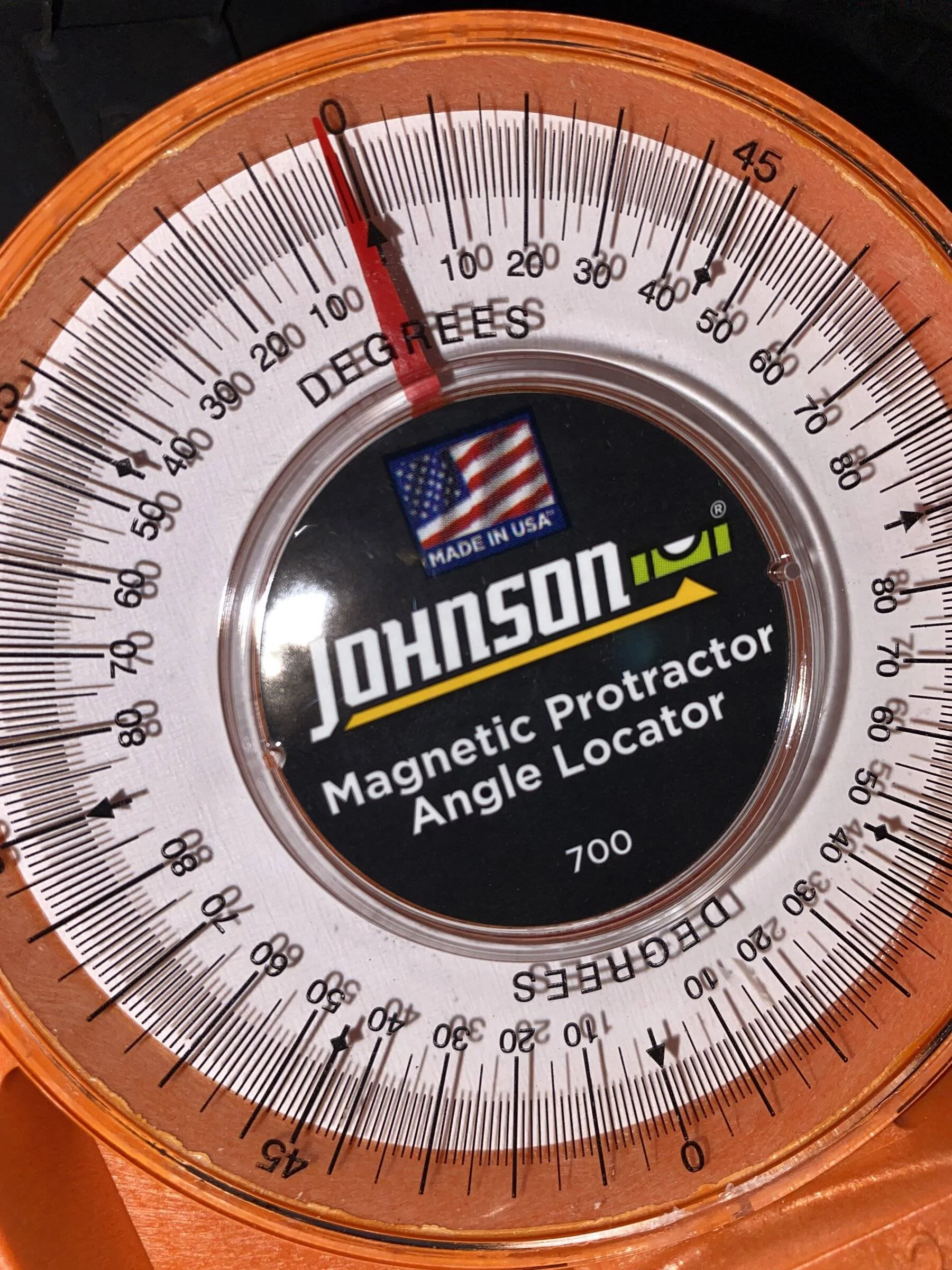

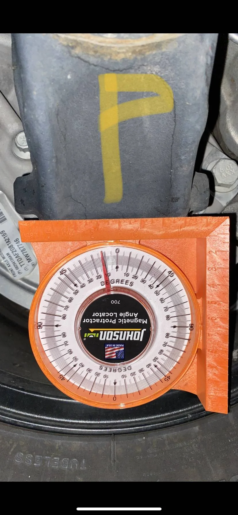

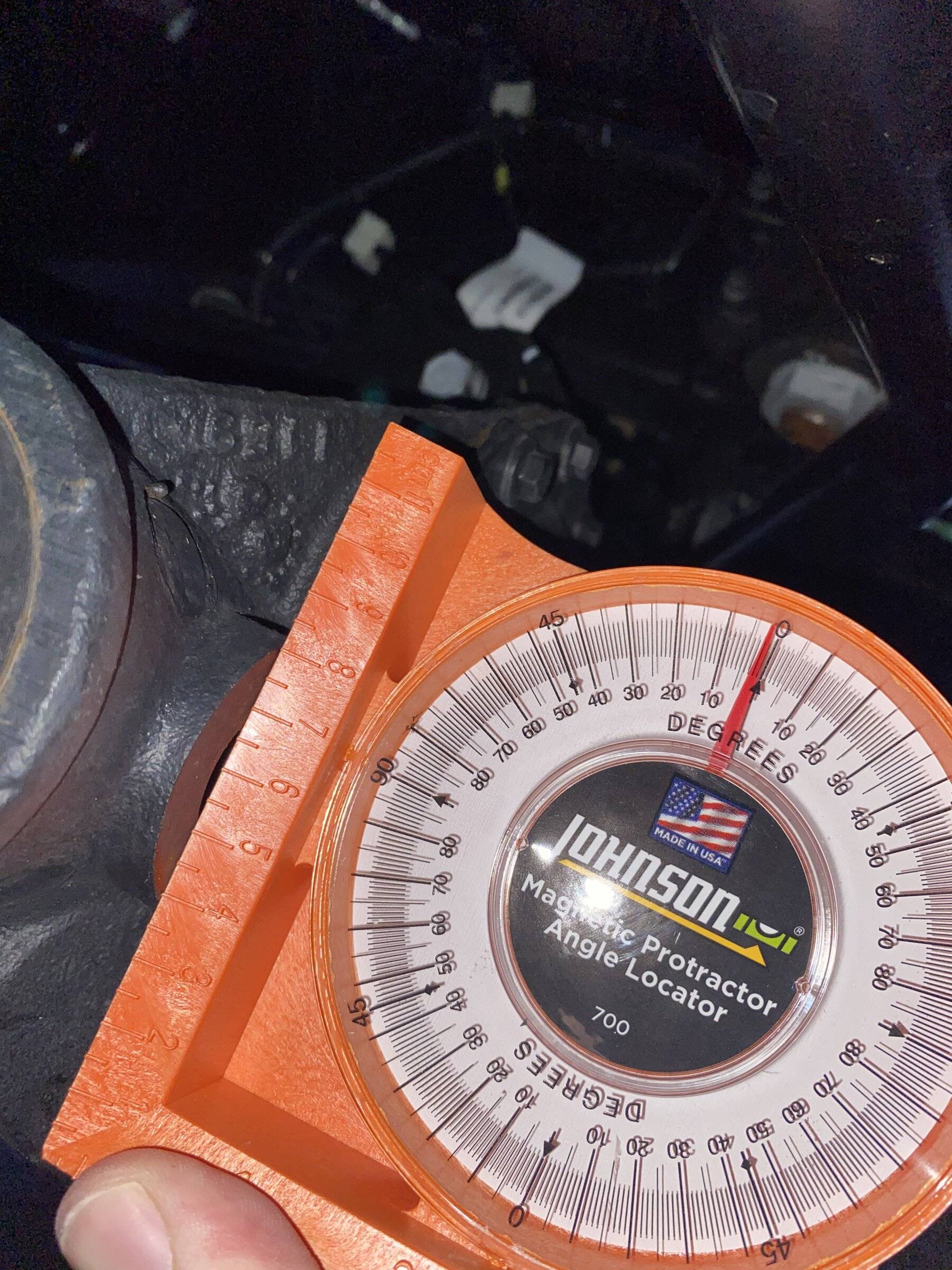

See my original post below, tried to get as level ground as possible. I did notice about a 5* difference in sway bar angle on the front, 12* driver car 17* passenger.
Here are photos of my pathetic attempt to measure caster…
Bottom 2 are off the diff holes

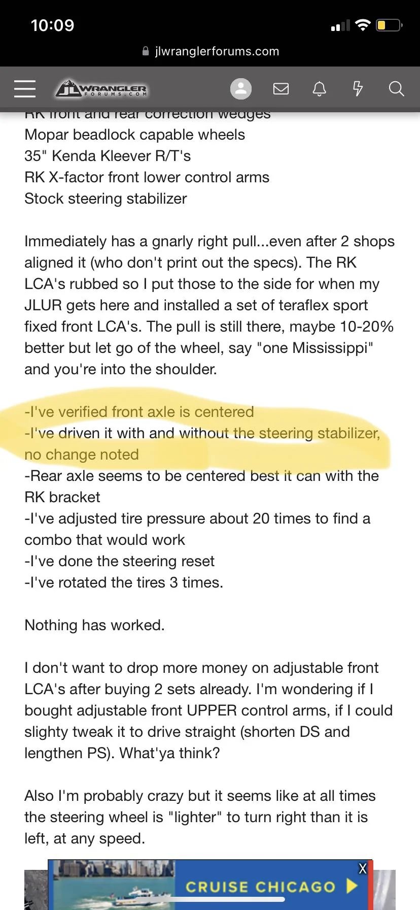

Immediately has a gnarly right pull...even after 2 shops aligned it (who don't print out the specs). The RK LCA's rubbed so I put those to the side for when my JLUR gets here and installed a set of teraflex sport fixed front LCA's. The pull is still there, maybe 10-20% better but let go of the wheel, say "one Mississippi" and you're into the shoulder.
-I've verified front axle is centered
-I've driven it with and without the steering stabilizer, no change noted
-Rear axle seems to be centered best it can with the RK bracket
-I've adjusted tire pressure about 20 times to find a combo that would work
-I've done the steering reset
-I've rotated the tires 3 times.
Nothing has worked.
I don't want to drop more money on adjustable front LCA's after buying 2 sets already. I'm wondering if I bought adjustable front UPPER control arms, if I could slighty tweak it to drive straight (shorten DS and lengthen PS). What'ya think?

On top of the knuckles I was getting about 2-3.5.
