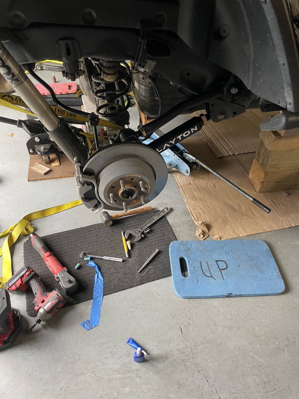

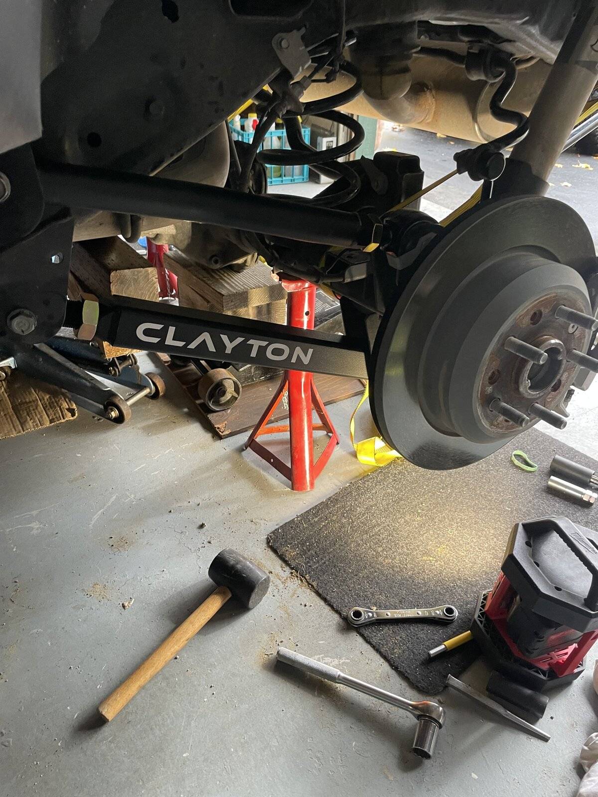

Got the rear adjustable control arms (all four) on yesterday.
already had the adjustable lower front on.
I have been told I should be shooting for 6.5 on the front.
what should I be setting the rear at?
having her aligned today and want to tell them first, as they set my fronts to 5.8 last time.
2021 JLUR Mopar 2” lift (netted closer to 3.5”)
37x13.50r20 mud grapplers
Clayton overland rear four adjustable arms. rc front lower adjustable control arm and track bar.
rc adjustable rear trackbar and evo relocation bracket.
Thanks guys.
forgot to mention, I set the rear uppers to 17.75” and lowers to 20.25 (thanks again Roky)
