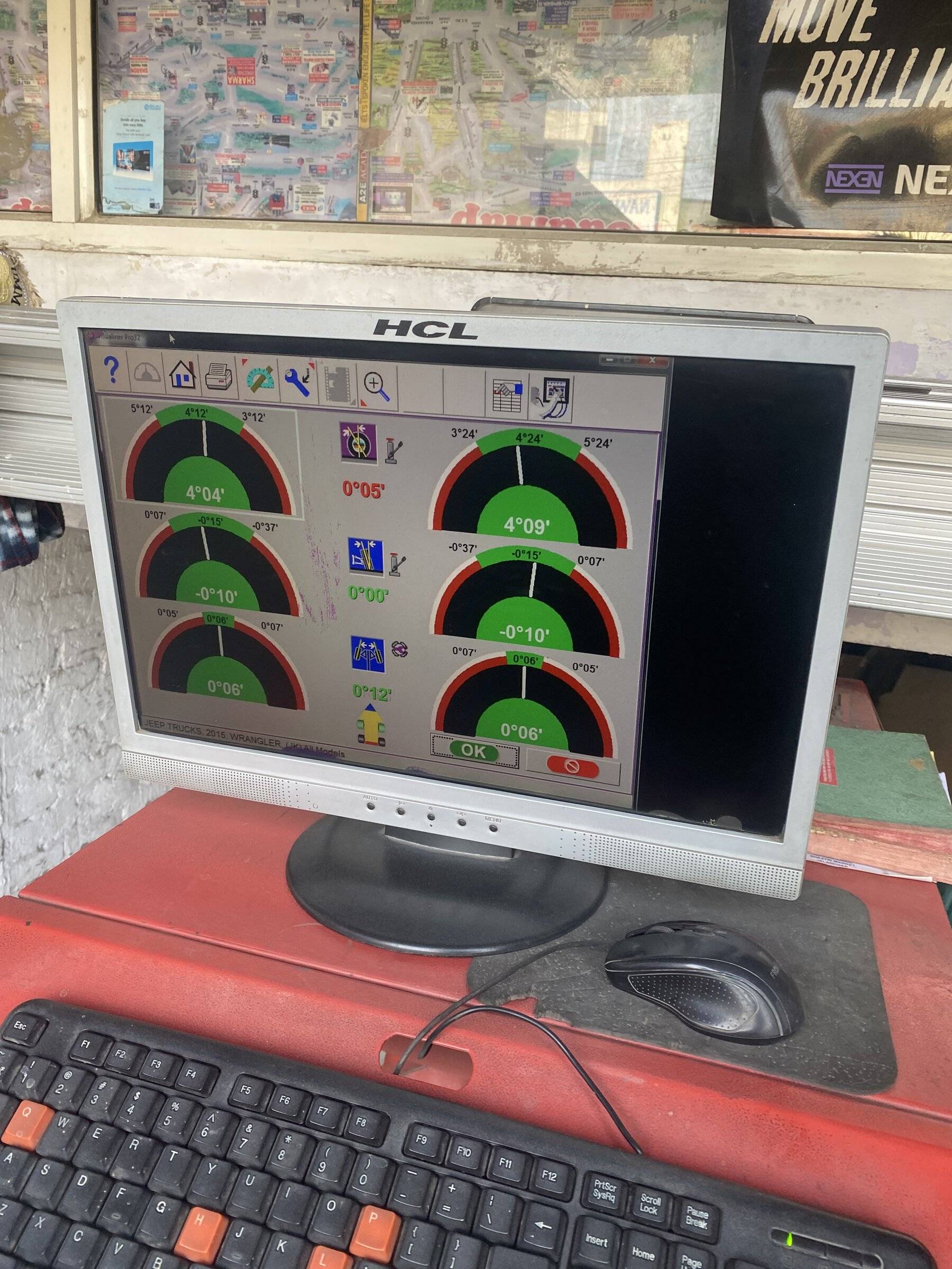

Get some Mopar lift lcas…….I have a jeep rubicon jl 2021 My caster specs are 4.04 for left and 4.09 for right is this okay? And if not how do i adjust the caster because I haven’t lifted the jeep it’s completely stock please help meee!
^^^^^^Get some Mopar lift lcas…….
My car pulls to left dues these specs because i drive it india and the roads are slanted to left and these specs make it worse and yeah so you mean the caster specs are completely stock nothing’s wrong?Those are the stock specs for a Rubicon… and the stock specs are BS. Jeep gave the Rubi a lift and instead of including longer control arms, they just revised the caster spec to make whatever it ended up the “norm”. Shitty thing to do to a car that regularly pushes $50k.
Your options:
- get used to squirrely steering.
-get the Mopar lift kit lower control arms (lca). This will get you a little under 6. Not great, but tons better than 4 degrees and cheap!
- Just go to adjustable lca. More expensive, but this will get you where you need to be. This is the route I went.
The side to side difference most likely means that your axle tubes weren't welded to the carrier parallel to each other. The bottom ball joint on one side is rotated further forward than the other. There is no fix for that other than cutting the tube off and welding it back in the proper position.My car pulls to left dues these specs because i drive it india and the roads are slanted to left and these specs make it worse and yeah so you mean the caster specs are completely stock nothing’s wrong?
My car’s brand new and the dealer checked it and said evrything is completely fine i just want to know are these caster specs same as the factory specsThe side to side difference most likely means that your axle tubes weren't welded to the carrier parallel to each other. The bottom ball joint on one side is rotated further forward than the other. There is no fix for that other than cutting the tube off and welding it back in the proper position.
That said, I don't know that .05 difference would cause it to pull much. Maybe, but I don't specialize in alignment. I agree with the others that advise a control arm swap to push your caster into the 6 range. Side to side will still be different, but overall stability should improve.
From a dealer perspective it is within specs. This is how the Jeeps are built.My car’s brand new and the dealer checked it and said evrything is completely fine i just want to know are these caster specs same as the factory specs
ALLDATA says caster specs for 2021 JL are as follows:My car’s brand new and the dealer checked it and said evrything is completely fine i just want to know are these caster specs same as the factory specs
