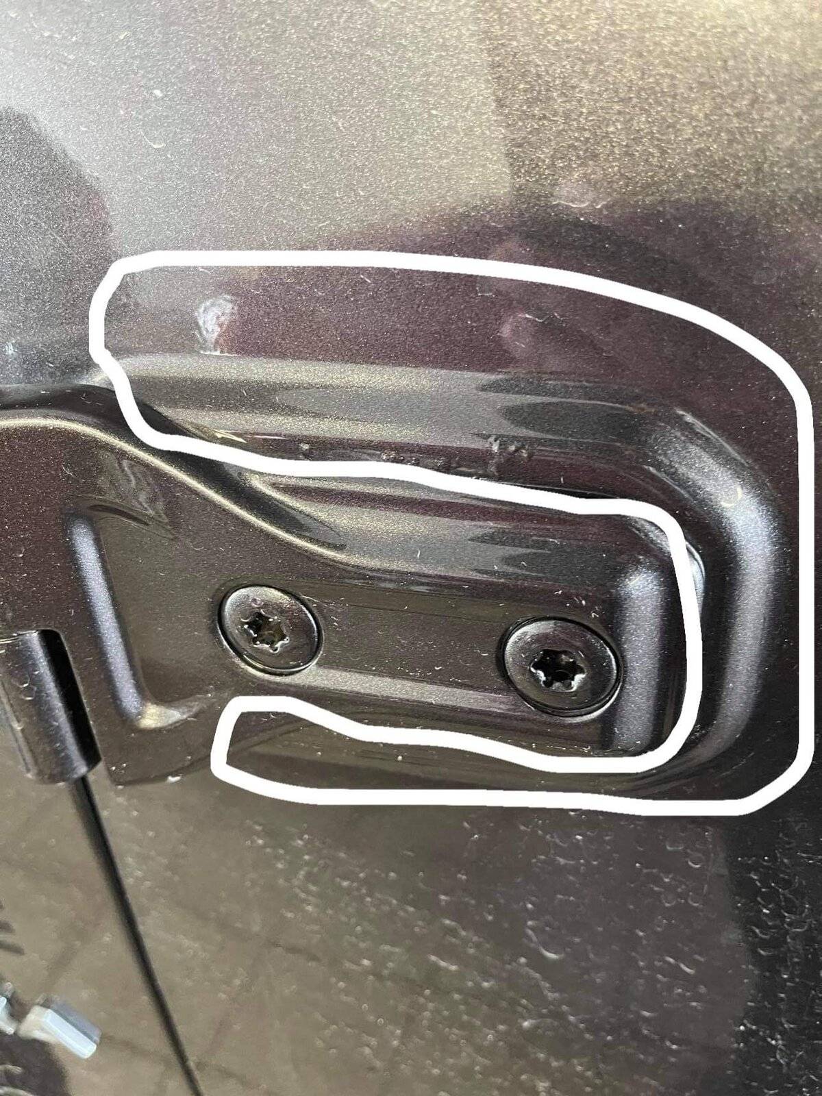

My Jeep is at the body shop for the paint corrosion on the hinges. Luckily, Jeep cares came through and they are covering the cost. I got an update today saying they ordered new hinges. But the corrosion is not the hinges themselves, or is the outer part also part of another hinge attached to the door? Thought it was part of the door. I attached a pic for reference.

I have a ‘21 red jlur and I don’t yet have any visible corrosion at all and I have also been wanting to unbolt the hinges from the doors and add custom thin rubber gaskets in between the door and hinge but many are rightfully saying that the hinge bolts are steel and are therefore still an issue and so the gaskets alone (or any other method of separation between door and hinge) will not stop the corrosion.
