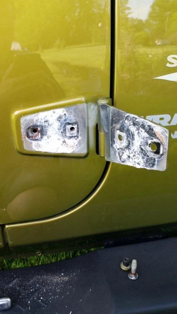

Past hinge corrosion problems were due to the crappy metal hinge bushings that would quickly corrode and spread to the surfaces of the hinge. Today's issue really isn't a problem with the hinge itself. It sounds like the fasteners that attach the hinge plate to the aluminum doors and hood might not have been coated correctly and are propagating corrosion to the doors and hood.
My JK had it start on the hinges where it met the door. I bet if you remove a JL hinge it looks like this underneath.
https://www.jk-forum.com/forums/stock-jk-tech-12/2007-jku-door-hinge-repaint-pics-corrosion-322591/

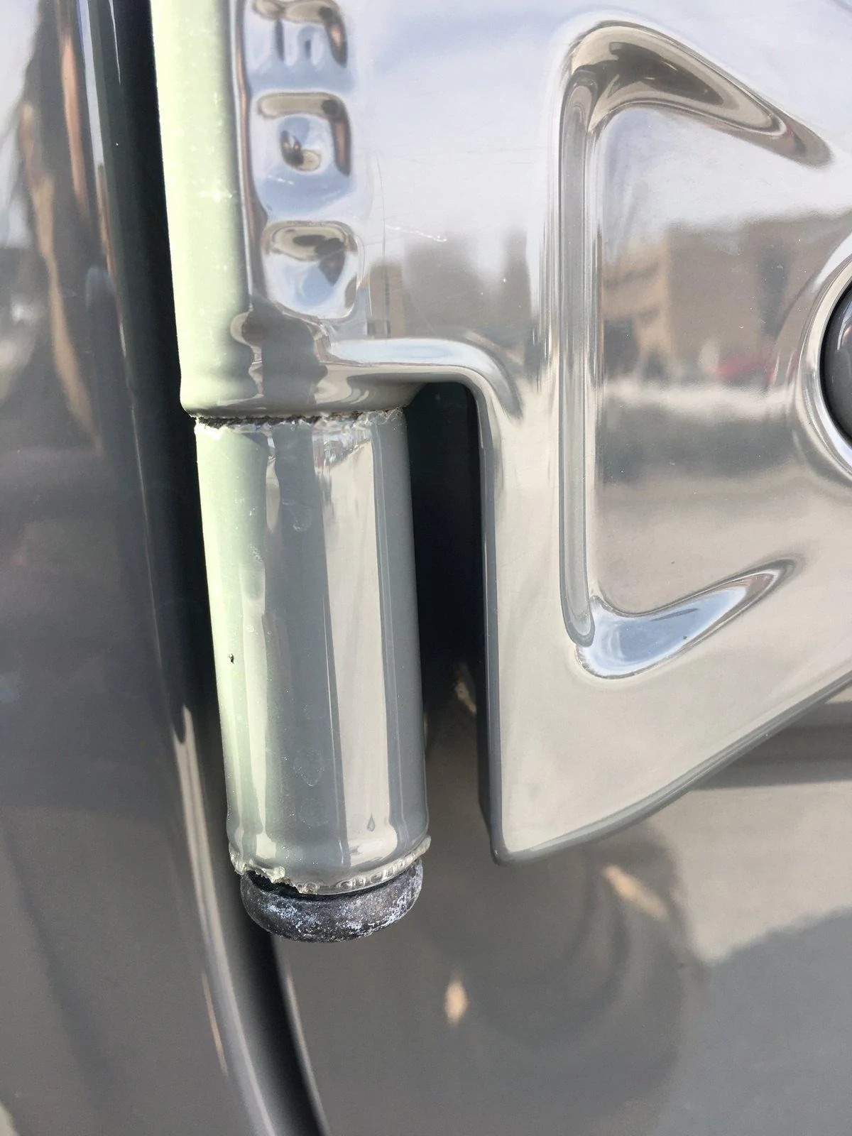

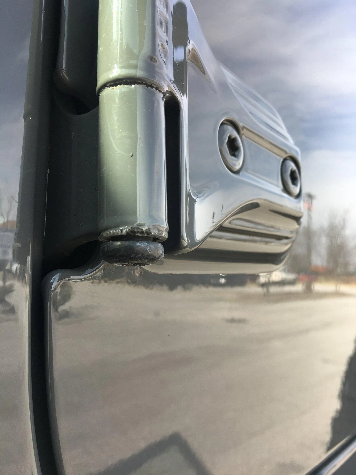

I have a 2019 JLU Moab sting gray and all the door hinges are bubbling like the jks did. All my hinges except the tailgate. Anyone have ideas or suggestions. I took it into the dealer but they haven’t contacted me back and its been a month. I ordered the derlin sleeves that go inside the hinge but whats the paint solution? Id rather not have all 4 doors repainted since im afraid the paint wont match
