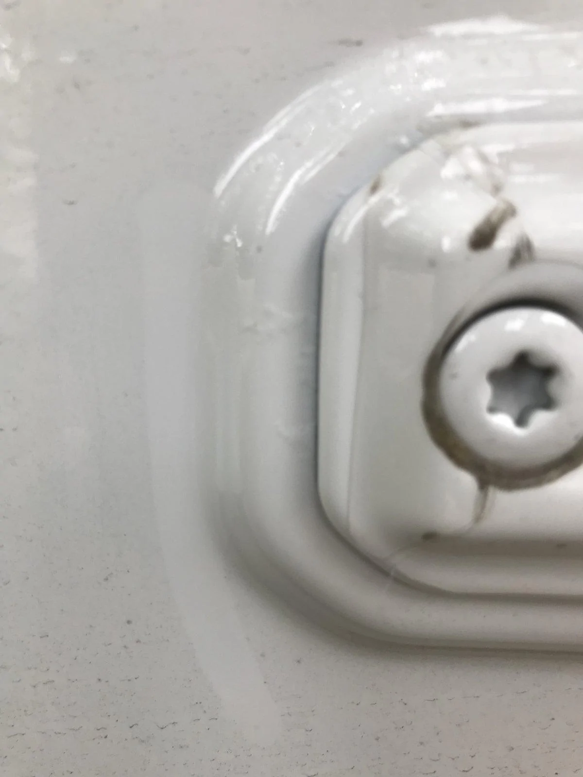

So the first go around. They stripped at painted everything separate. Then installed the torx bots and you can just about imagine how that looked with touch up paint after the install.
I sent it back and said take it apart, paint the doors, then install the latches and new bolts, then paint and clear again. From what I can see they painted the 3M primer or whatever material per the TSB under the hinge. Then painted the hinge and bolts together installed on the doors. It ended up being all 5 doors and the hood.
On the rental JL I had, which was a 2020, it looked like the paint was not able to get behind the original hinge? There were spots were it was missing. It was cleared, however the spray was not as complete as what I have now from the factory.
On another note. It sounds like Jeep will be reimbursing my payments for the time it was in the shop, as well as paying to reapply the ceramic coating I had done locally.

Bubbled up paint at or around all my door hinges as well. I bought my JLUR in 2018 and have since put on ~27k miles.....so this is quite the unexpected 'feature.' I'm not even going to bother trying to bring this into the dealership for any type of work, those idiots (from management down to the guys on the wrench) have no clue. Too much miscommunication, lack of listening to the customer, and $$$ drives their thought process...which ultimately leads to a customer going for a long ride of wasted time.
I have to say, between purchasing the JLUR up until now, I've had a myriad of issues ranging from: dead alternator, an ECM recall, the oh so awesome steering damper recall (which the dealer installed improperly on first attempt), what seems to be a brittle windshield, mass corrosion of all frame welds, alignment out, and the above paint issue.

I posted I had the same problem on my 2018 JLUR. The dealership finally got around to scheduling me to get in the body shop. Covered under warranty. My opinion is that the problem is dissimilar metals. The hinges are steel (to my knowledge) and the doors are aluminum. I’m surprised they don’t have some sort of insulator between them.
I’ll post the results when they’re done.

The hinges are Aluminium as well. The issue is they paint everything after it is assembled like a normal vehicle and not one with exposed door hinges. No paint can actually get behind the hinges, which means every surface under a hinge or say the under body itself are bare primer. this causes moisture to get in between the paint and the surface of the doors which causes the corrosion. The simple solution from the factory would be to paint the panels sepirate and than assemble, unfortunately that is additional steps and time for the manufacturing process and that wont fly so.

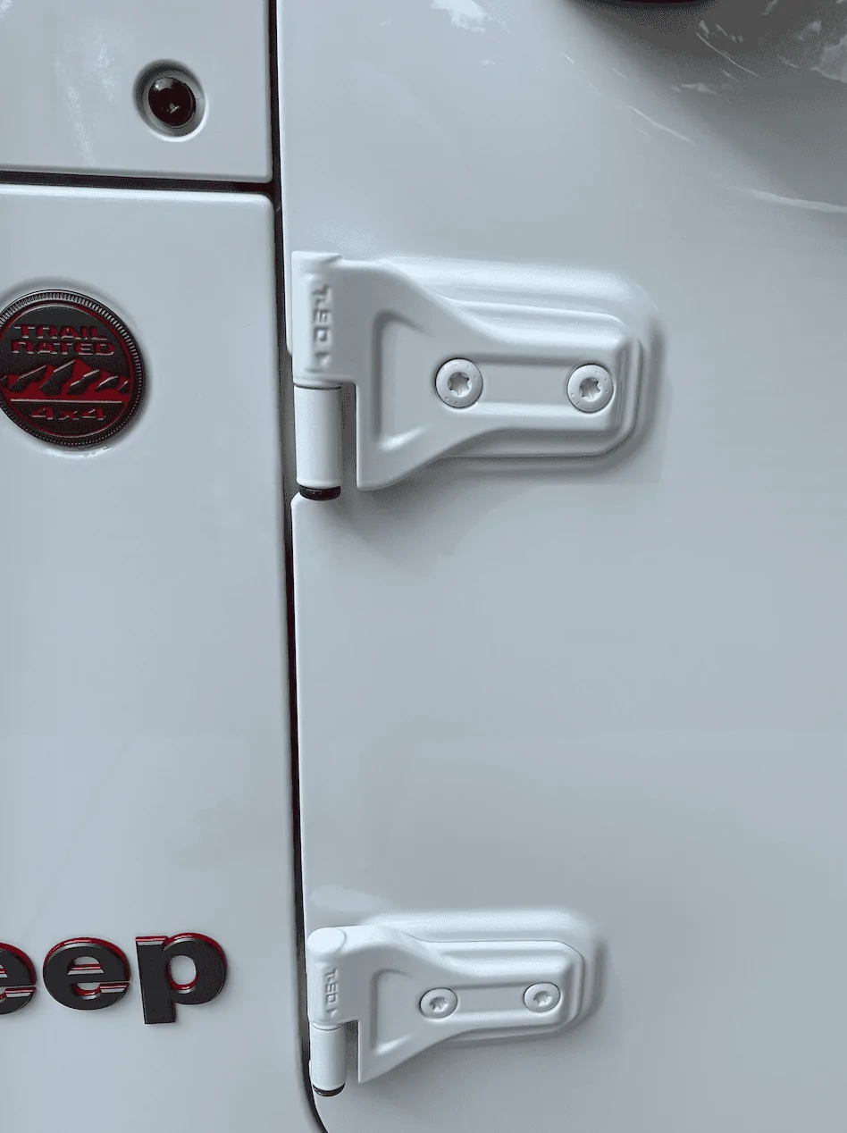

I am experiencing the same issue on two of my doors. I currently have my Jeep at the dealership to have the doors painted. This is starting to become an issue as seen from the multiple posts. Interested to see what Chrysler may to say in the near future.
Poor paint preparation is the problem .

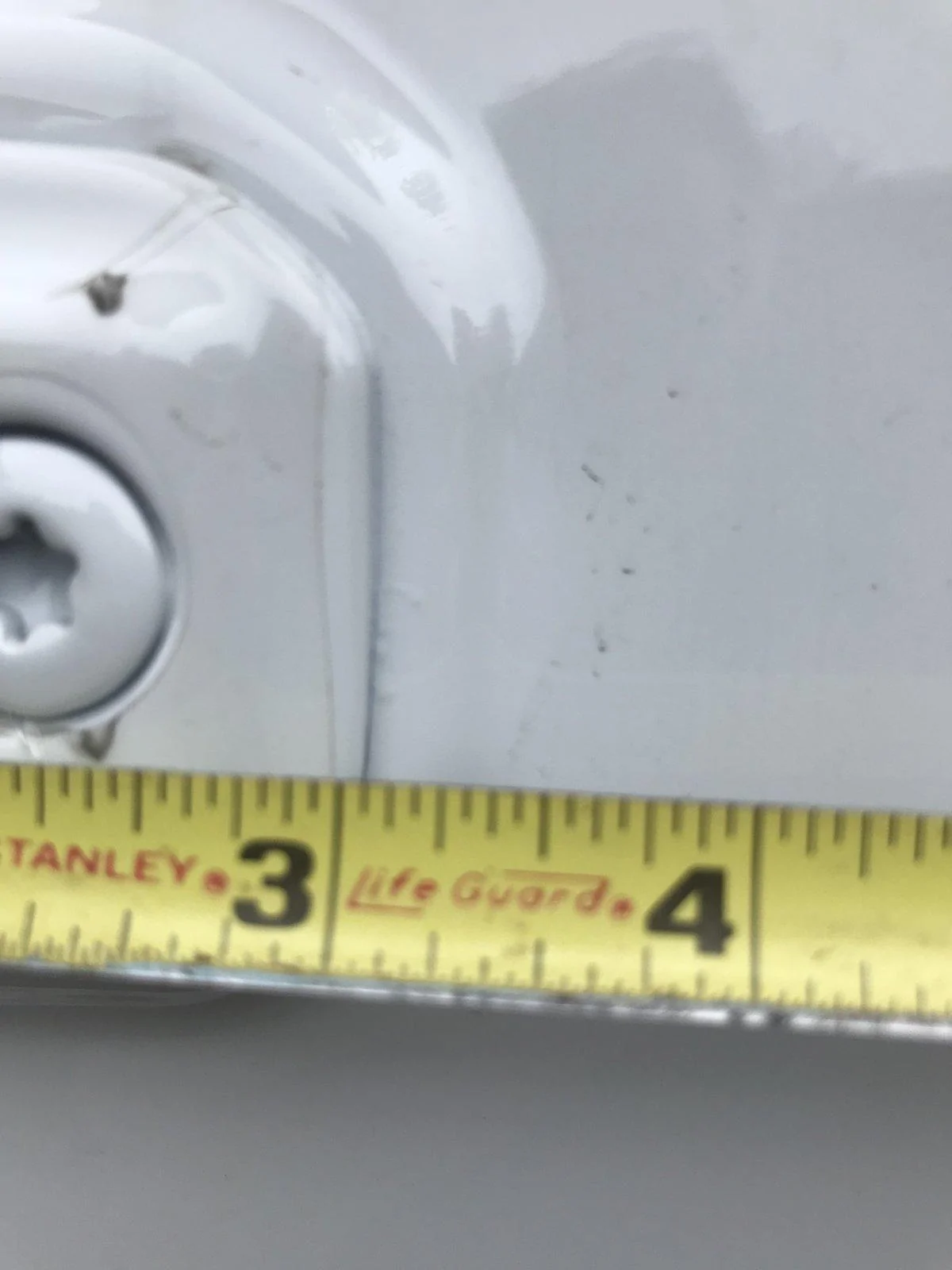

Washed the jeep over the weekend and noticed small bubbles in the paint at one of the rear door hinges. I am over a year and have roughly 27k miles.They are hard underneath and the paint is not loose and pretty sure they were not there last time i washed the vehicle. It cant be rust under the paint since the doors are aluminum. All other hinges are fine. Has anyone seen this issue?
...looks exactly like mine, same granite paint too on 2018 JL Sahara in 8 spots on/around several hinges and door corners & bottom. Bummer reading the same/similar problem from so many owners. Brought it to dealer today to start the process of submitting to FCA for approval to do the fix ... if a permanent fix can even be had, based on some reviews here! Really irritating on a $50K+ Jeep only two years old and just under 30K miles.
