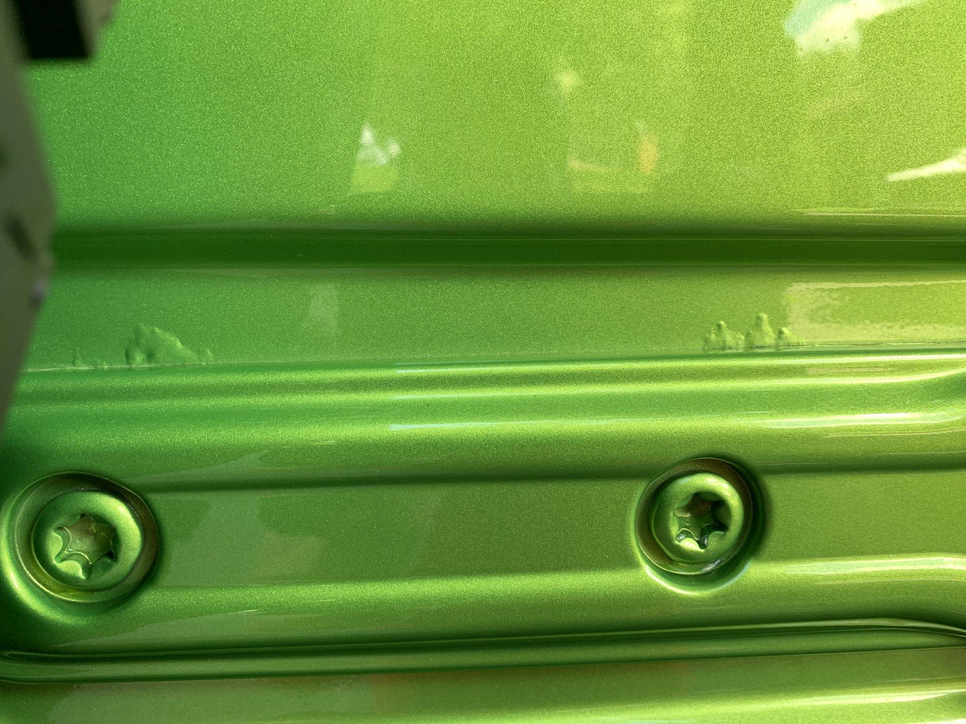

I don't, but I was in the Coast Guard and we had many aluminum boats and ships. It is very common to have a zinc anode on anything aluminum, especially in salt water. The zinc gives off it's electrons more easily, thus sacrificing itself for the sake of the aluminum. The issue is the doors and hinges are bolted together with steel fasteners before paint. There is a solid metal to metal interface between them. The different metals create an electrolytic reaction and the aluminum corrodes, sacrificing itself for the steel. The solution is to paint the door hinges and door skins before bolting them together. The paint should create enough of a barrier that this is no longer an issue. Same for the hood. All that said, the best course of action is to find an out of the way, obscure location, remove the paint to bare metal and bolt on some zincs.
Also what about attaching something to the inside of the door by taking off the interior door panels? Or does it need to have contact to the outside surface?
Jeepsk8
May 19, 2018
2,802
20,360
Sierra Vista, AZ
2020 JLUR
It could be inside the doors, but that would make servicing the anodes a pain. Regarding the painted bolts and such, they could have maybe coated the bolts before assembly and then painted them. I don't know, but they could have referenced the marine industry to mitigate the corrosion. I don't think they thought too much about it.
Yep - sorta seems like the (lack of) plan was just - slap it all together then spray it all with paint...

The main issue is the plate the hinge bolts screw into is steel and it is attached to the aluminum skin. Many manufacturers use steel and aluminum but FCA is BY FAR the worst when it comes to cross contamination. The F-150 has virtually no corrosion issues.

This is a WIDE SPREAD problem. It started in 2007 when jeep went to Aluminum hinges on the doors.
Yes I realize aluminum itself does not rust. This is not a "rust" problem its a problem in the way Jeep anodized its aluminum. If its not done perfectly with zero imperfections then the anodized aluminum causes oxidation under the paint, even with the absence of air and water.

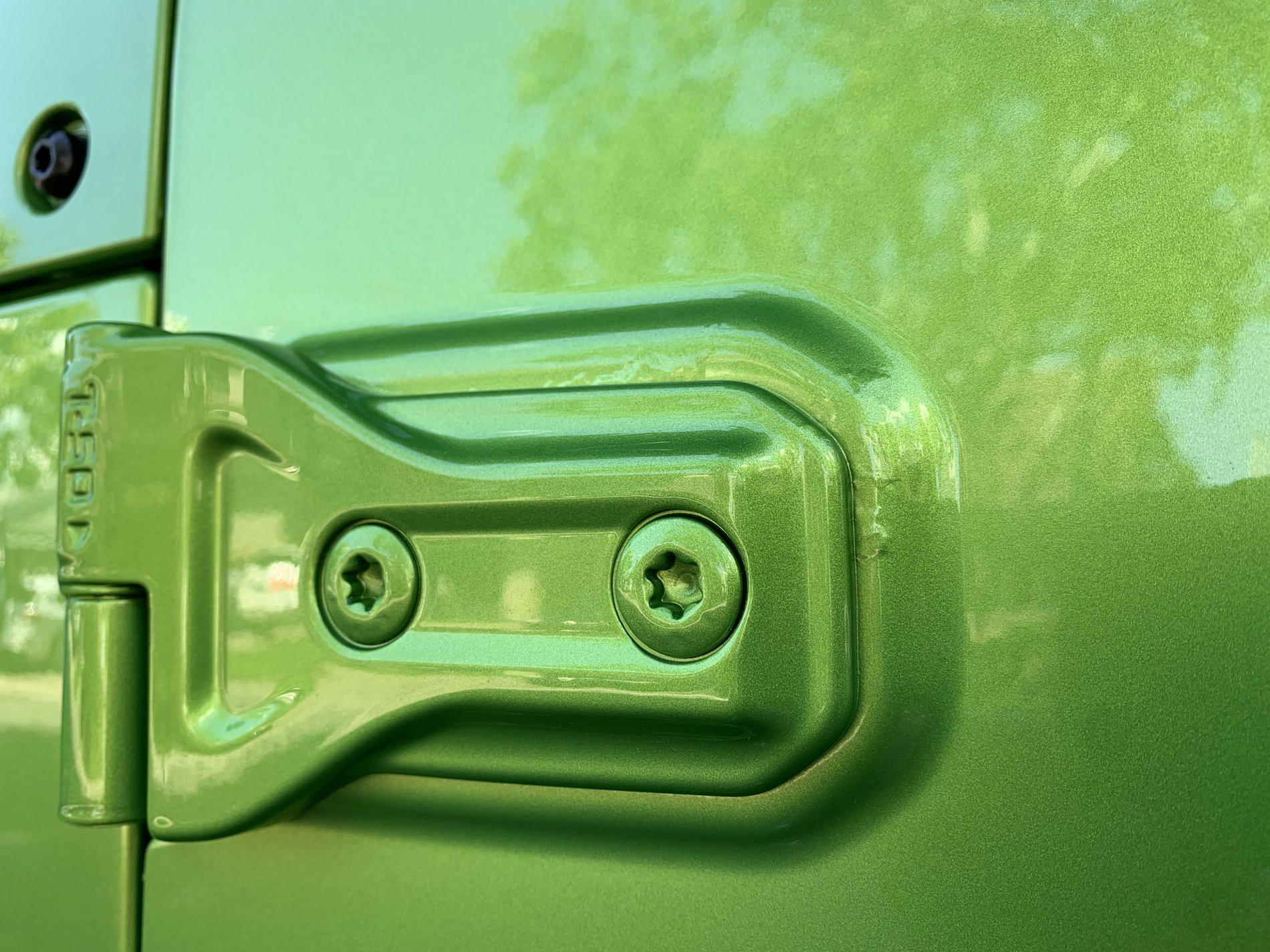

I have this problem on all 5 doors of my 2018 JL in addition to the hood. The dealership sent my JL out for a respray of all 6 pieces, however it was returned with clear coat issues and sloppy touched up torx bolts. It literally looked like someone took brush and just swirled it around in the bolt. When the general manager asked me how they were expected to align the doors without scratching the bolt paint, he seemed perplexed by me explaining to him the new hinges and bolts should have been adjusted and prepped prior to the spray and clear. As it sits, I know for a fact they were not all replaced because the bubbling on 2 of the hinges was missed.
I received a call today, letting me know they received the jeep back for a second time and would be sending it to the auto body shop for a third time.
I have expressed my frustrations, it seems like there is a clear disconnect between how this should be handled and what is actually happening at the auto body shop.
Has anyone else experienced this? What steps did you take to make sure everything was done correctly?
