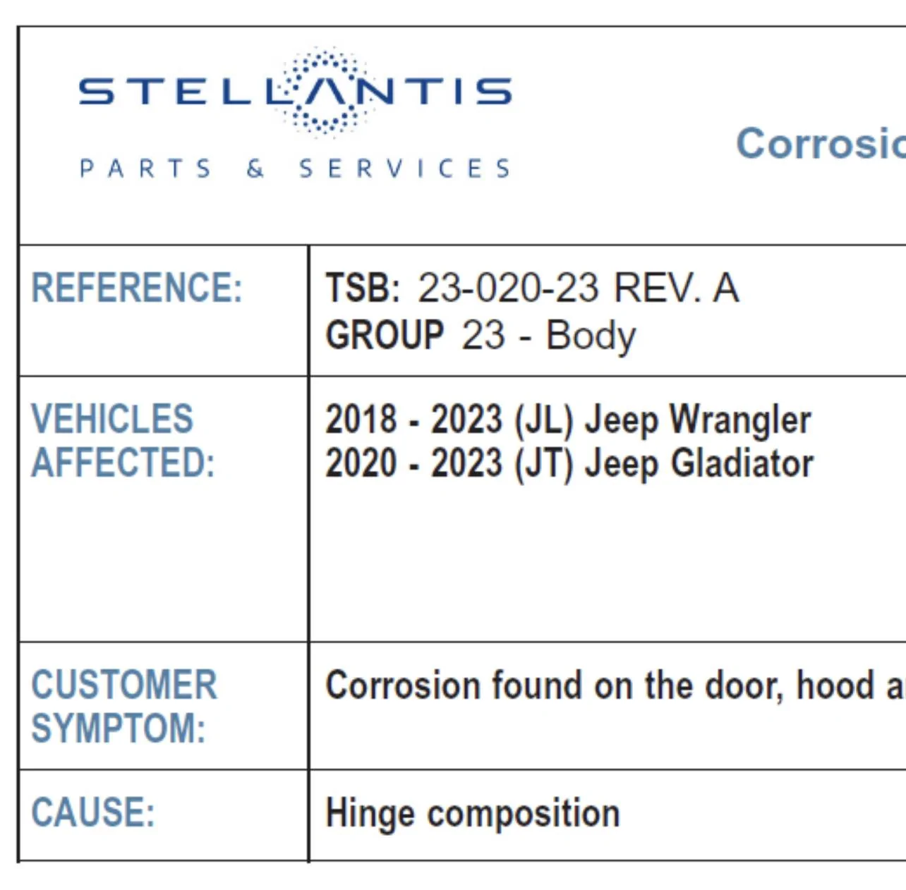

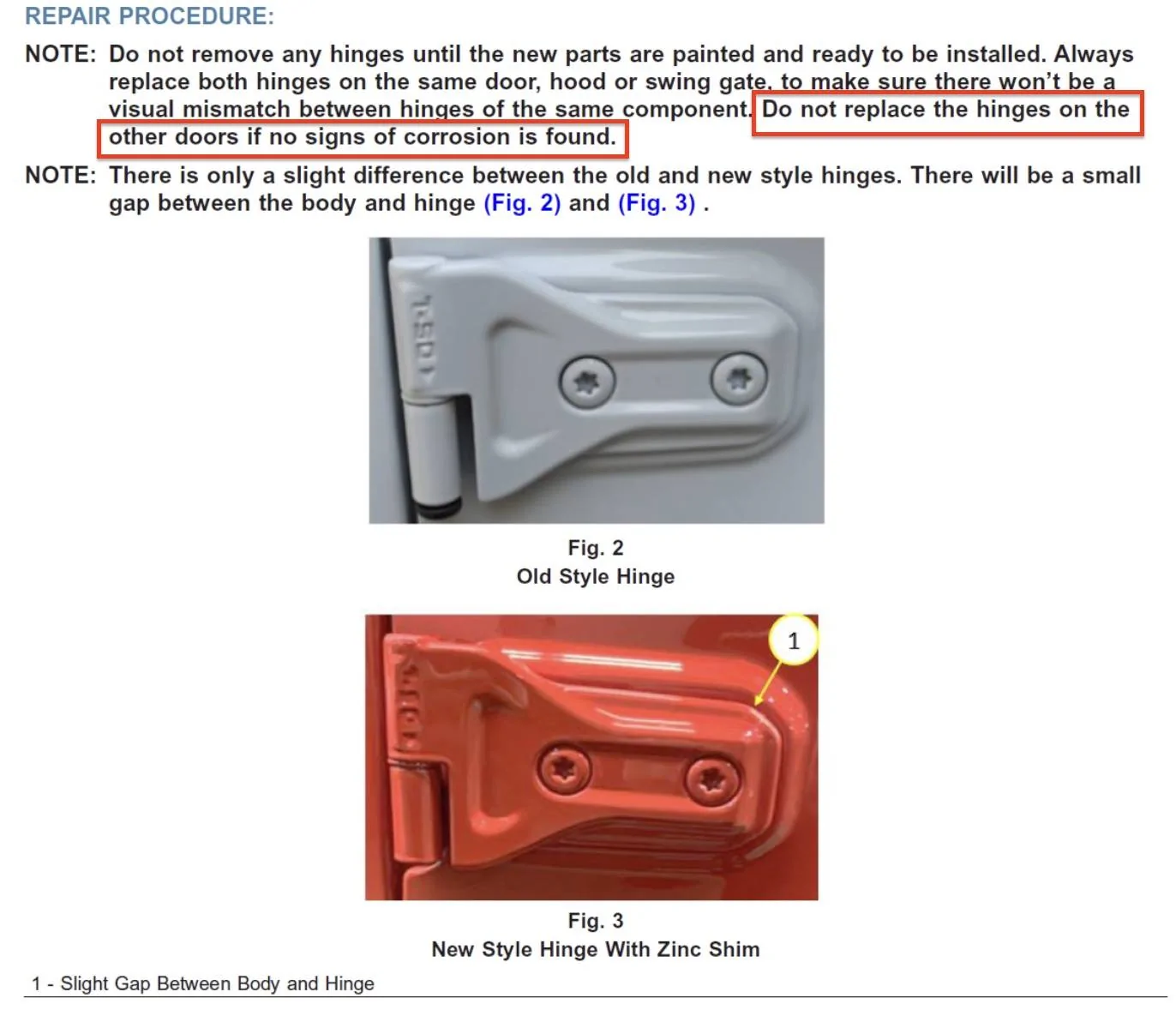

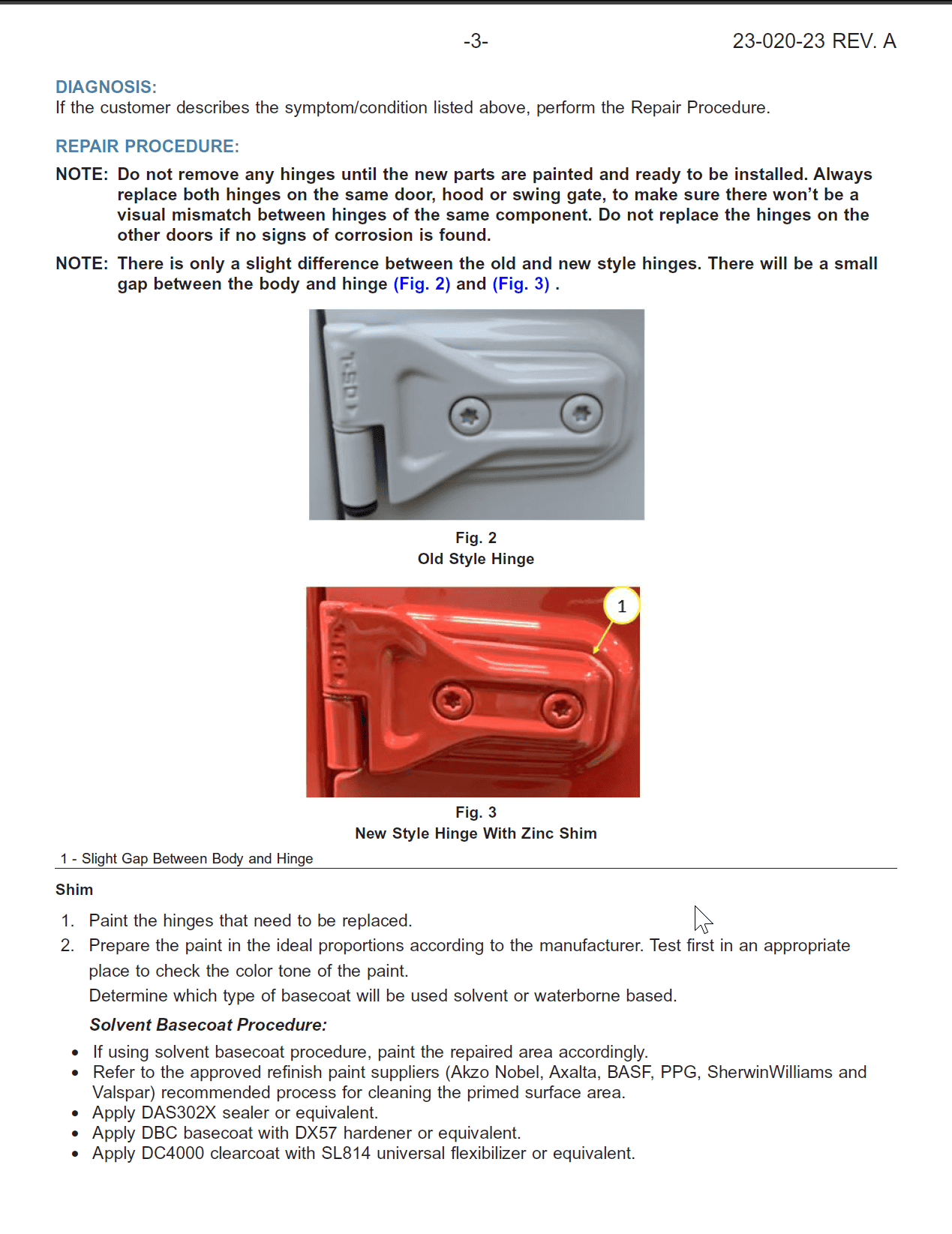

The latest revisions of the hinges have a zinc shim, not a gasket.

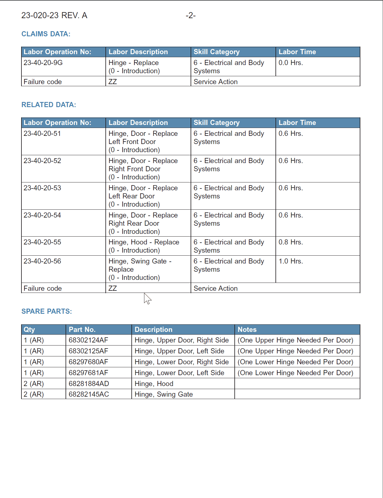

1 (AR) 68302124AF Hinge, Upper Door, Right Side (One Upper Hinge Needed Per Door)
1 (AR) 68302125AF Hinge, Upper Door, Left Side (One Upper Hinge Needed Per Door)
1 (AR) 68297680AF Hinge, Lower Door, Right Side (One Lower Hinge Needed Per Door)
1 (AR) 68297681AF Hinge, Lower Door, Left Side (One Lower Hinge Needed Per Door)
2 (AR) 68281884AD Hinge, Hood
2 (AR) 68282145AC Hinge, Swing Gate

Sadly, it appears that they are not installing these hinges on new products.

Well heck, that only took 5 years for them to figure out a band-aid
So what about all the fixes out there that didn't get this "improved" symptom treatment?
Still need to fix the cause and fully paint from factory the area - sealing all bare metal and fix the contamination issues causing bubbles away from hinges on edges of panels!!

Are these available separately? Part numbers? I know it says to do only affected hinges but maybe good preventive maintenance to install them BEFORE there is an issue?

If it really is a sacrificial anode (which it is), you would think they will have to make replacements available eventually.

I wonder if the shim itself is replaceable like most sacrificial anodes or if we would have to replace the entire assy once the shim gets eaten up?

I just stopped at the body shop and asked them to order all of the hinges in the new TSB. I don't want mismatched hinges and I'll happily pay for the ones that weren't on the estimate.

I think I see a gap already on my '22 hinges, but it's probably just wishful thinking. I doubt the fix was figured out a year ago (built Jan '22).
But check out the fine print... Why not do all and be done with it. Kinda BS.
