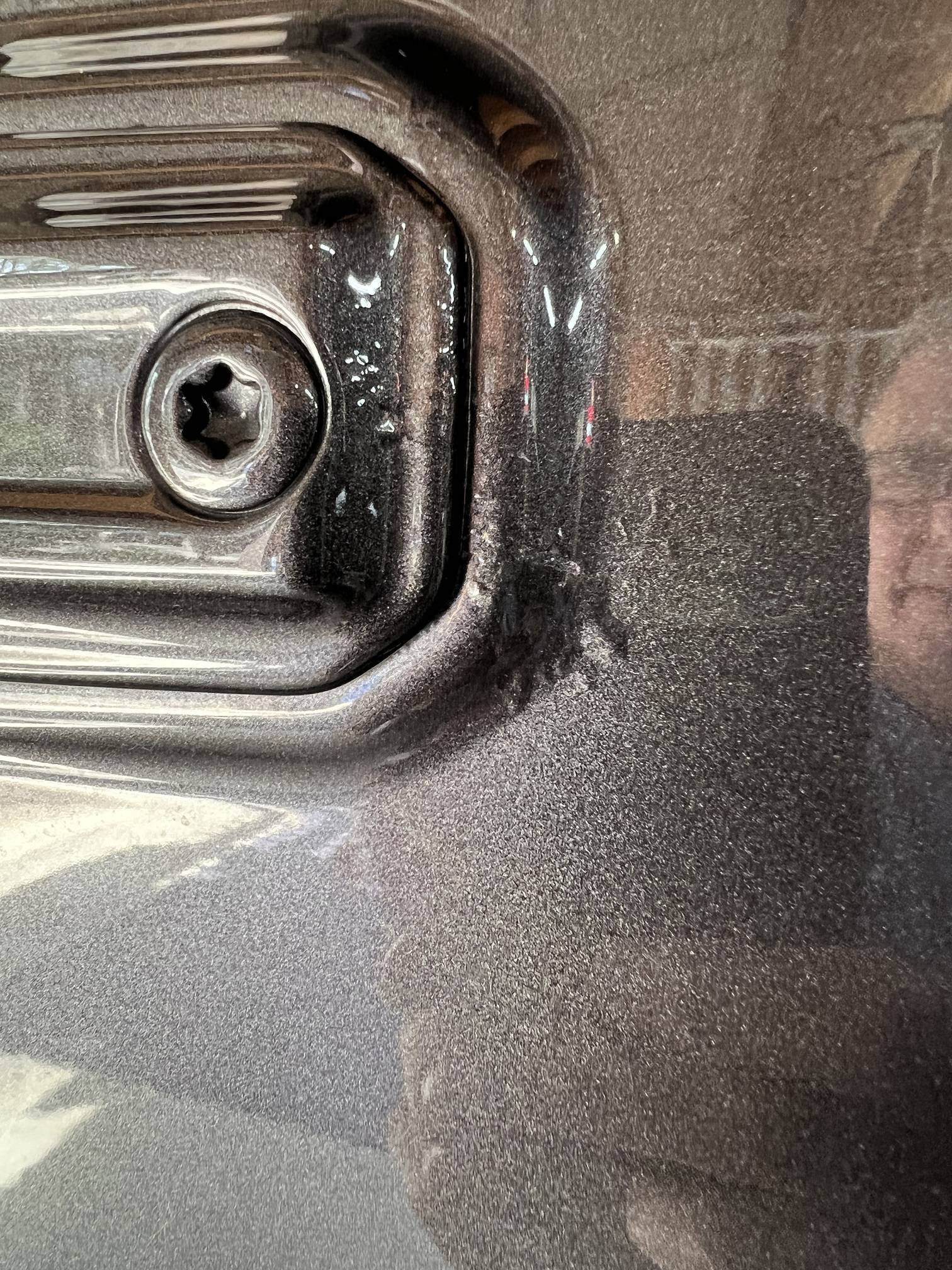

Another spot showed up at the bottom of the drivers door…
I have emailed Jeep Cares with updates and photos, I have called and left messages with my customer care rep who managed the repair the last two times and no one has responded.
I guess now the warranty is out (33,455miles) I am S.O.L…

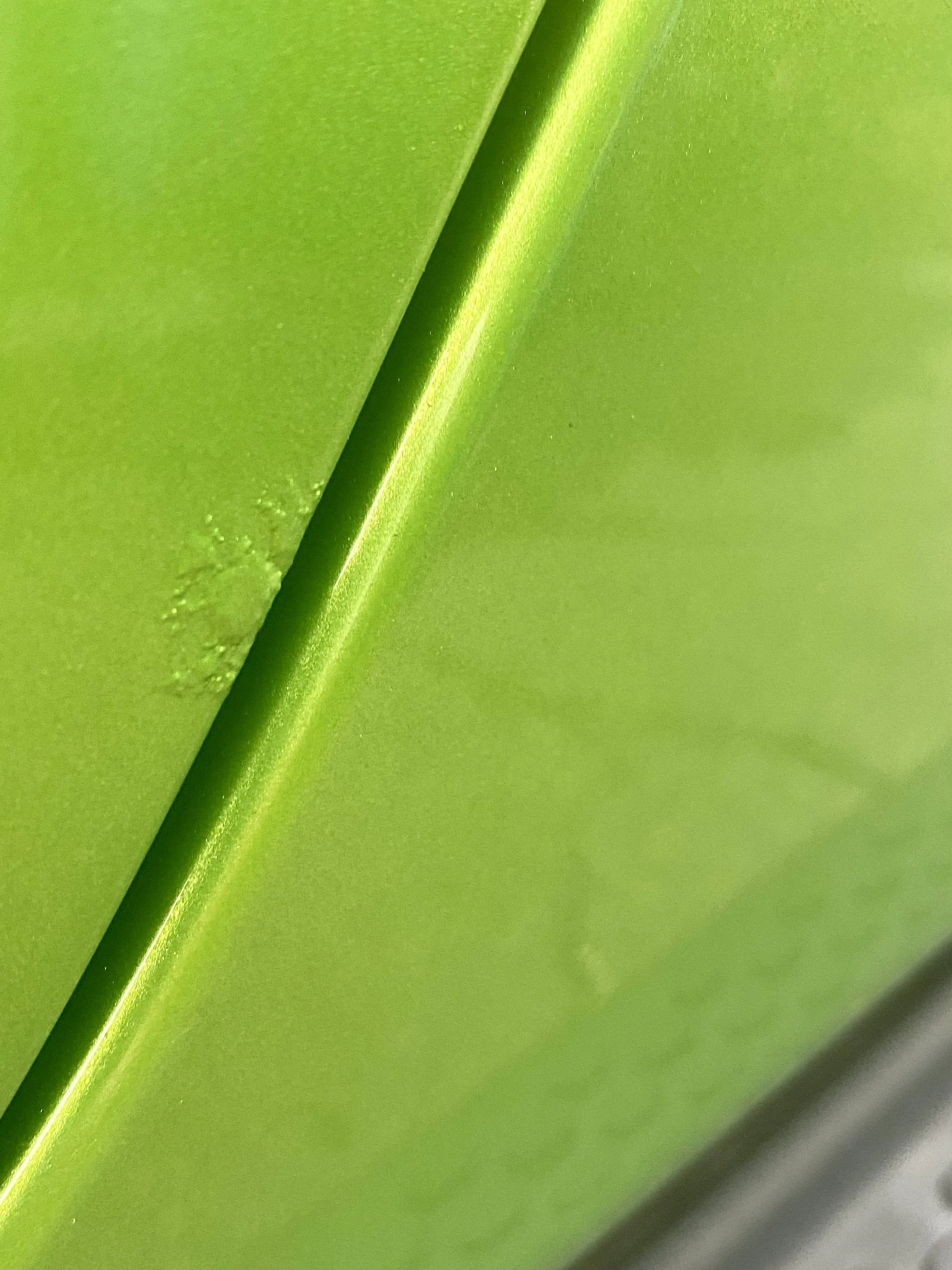

There is a spot on each of the doors on my 2 door JL and a little bubbling on the passenger side hood hinge. I took the Jeep to my dealer and the service manager photographed the spots and submitted the photos to FCA. It has been about 2 weeks and have not heard anything yet. I will call next week to see what is going on.

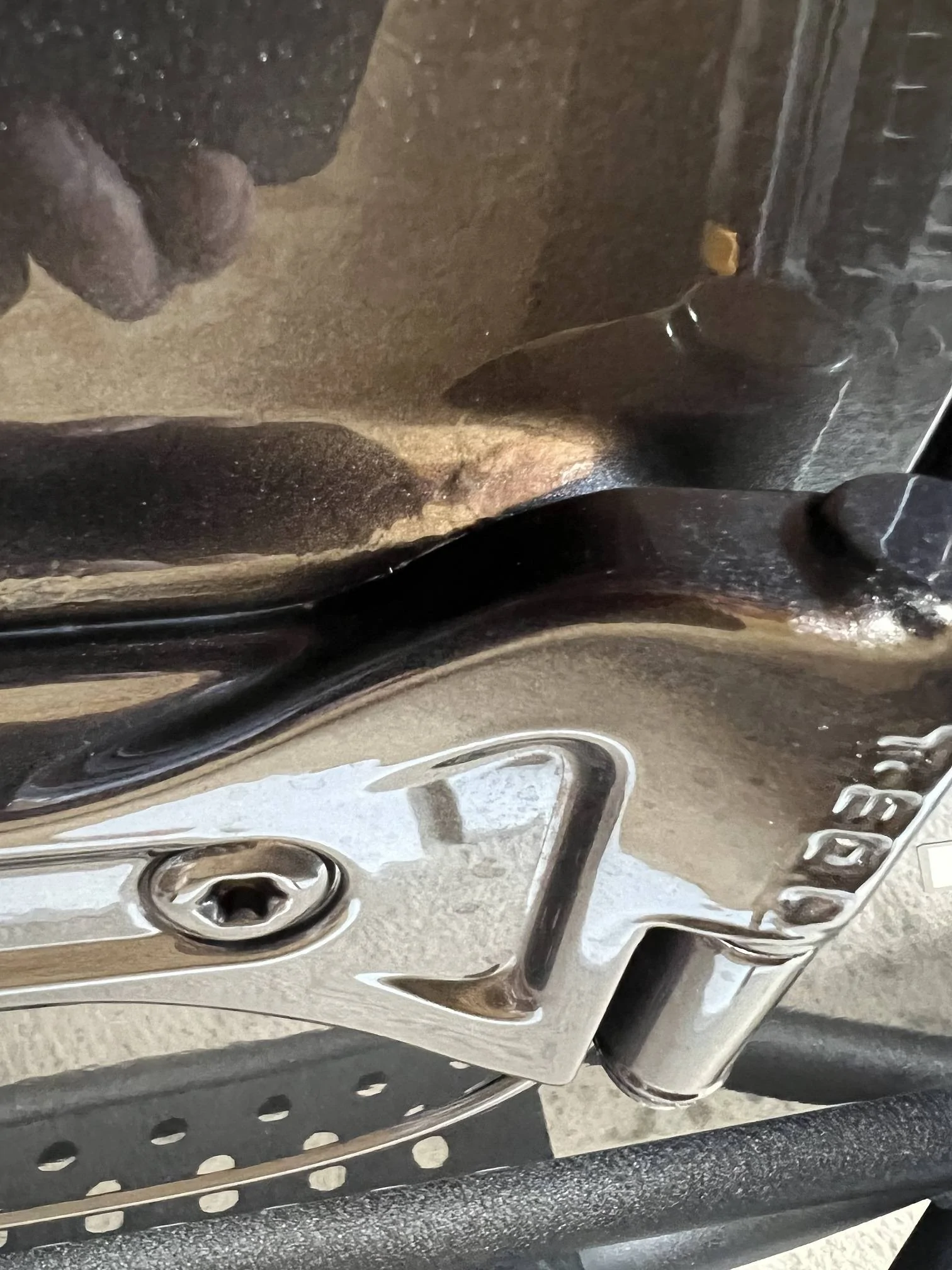

Washed our 2018 JL Sahara (24,000 miles) today and noticed early stages of corrosion around the front door hinges.
Took it to my dealer back in July. They inspected it and scheduled the repair for 8/1. So we dropped it off Monday 8/1 and are waiting for it to be done. Dealer said two weeks and gave us a ‘21 Cherokee loaner.

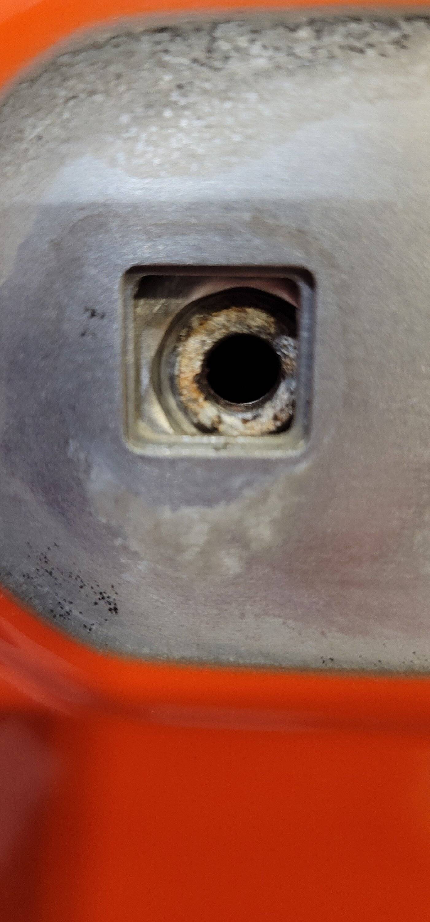

I decided to take off all my hinges and have them powder coated Also ordered all new bolts and will apply some Tef-Gel on the bolts as the new bolts will stainless. Maybe that will help.
All of the hinges have primer on the back but there was no paint on the hangers or on the door jams under the hangers. Most of the bolts had signs of corrosion. Attached a couple of photos from a door that the shop did not do any repairs because there wasn't any signs of corrosion on the door or hinges.
