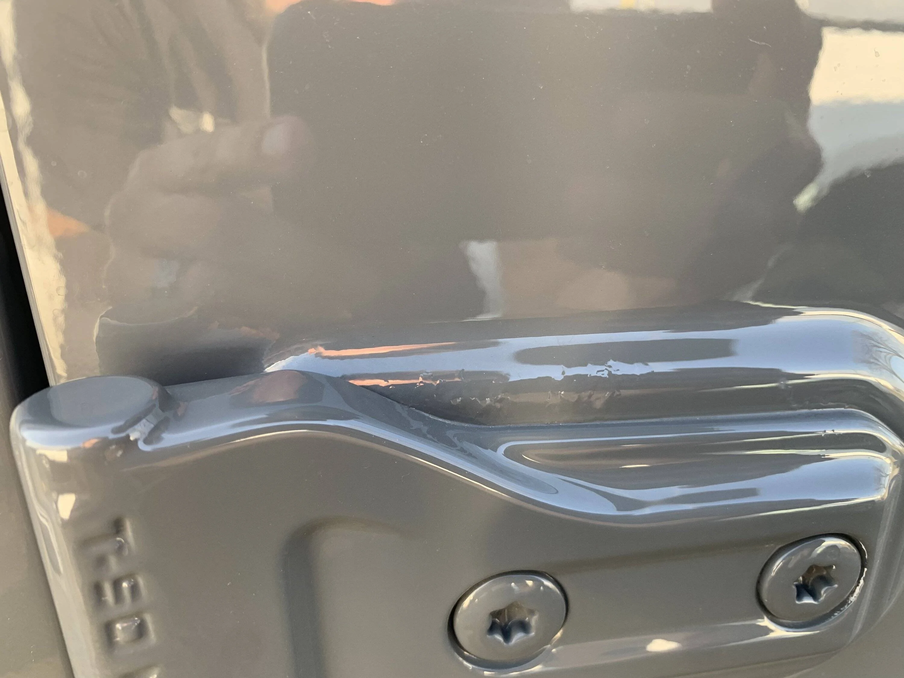

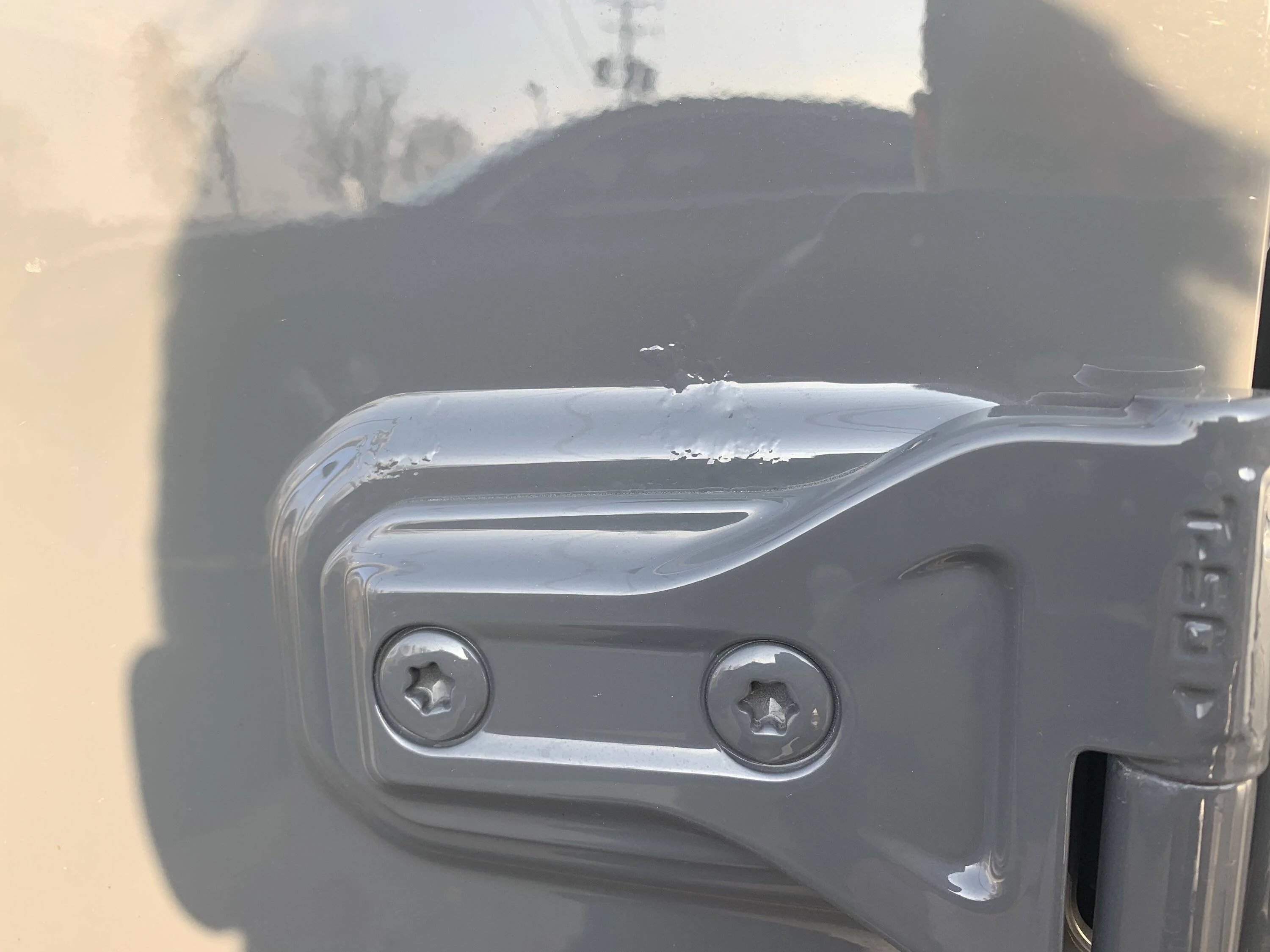

Just took mine into the dealer. The service advisor said they get about 10 a week!! And that their body shop has literally become devoted to repainting them. He was pretty shocked on how bad some of the corrosion is Around the hinges that was spreading even further into the paint. Every panel besides the two rear fenders had some sort of corrosion. Luckily they were super awesome about taking care of it. I did contact them back in December and again in March and again in June when i was finally ready to take it In. They provided a loaner said it would take about 7-10 business days. Some images attached.

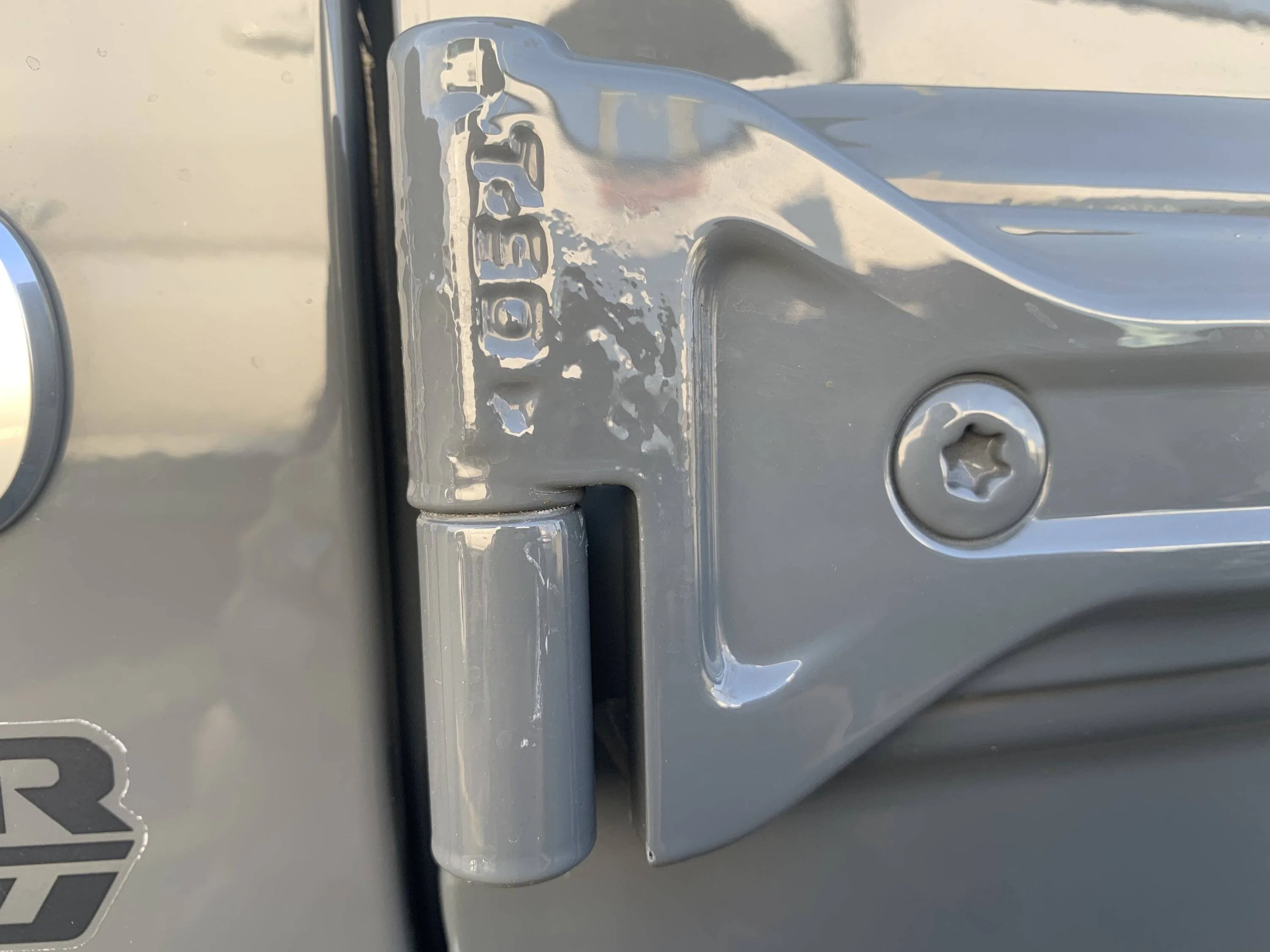

Very sorry that you also have this. But amazing how your corrosion lines up almost perfectly to where the torx head steel bolts are connected.

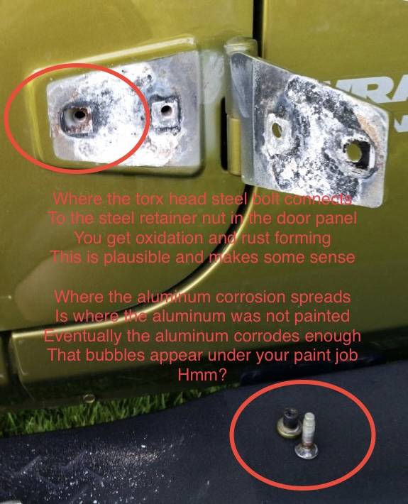

After a bit of research:
1 Ford has a big aluminum corrosion problem
2 Audi has a smaller aluminum corrosion problem
3 Jeep JKs used steel doors with aluminum hinges - so similar problem but different
4 Ford class action is very similar to the FCA one
Ford looks to admit that aluminum corrosion starts from steel fragments landing on the aluminum:
[In the TSB, the suit says, Ford again warned technicians of the aluminum corrosion on certain cars’ hoods, stating that testing had revealed that “aluminum corrosion was caused by iron particles working their way into the aluminum body part, prior to it being painted.”]
This aligns with the JL corrosion problem at the hood and door edges far away from hinges. Iron particles floating and landing before painting.
At the JL hinges - the steel retaining nut welded to the aluminum door panel looks to be the most likely culprit causing the inherent galvanic corrosion. Plus the torx head steel connecting bolt contact areas do not help. Unfortunately once the battery cell is created with any moisture completing the circuit - galvanic corrosion will start and not stop.
Super dry climates with very low humidity should do much better than wet and salt/brine covered areas. Separating the hinge with a barrier should slow the corrosion from migrating as fast. Unfortunately this looks inevitable due to how JLs are manufactured on the assembly line.

I did ask the service advisor “ Am I going going to be coming back every 3-4 years to get my JL repainted? He did say they repaint the correct way, but if it somehow does rear it ugly head again I am now not only covered by Jeep but also the body shop. So I guess a couple hours of driving for a brand new paint job every few years, by a top notch body shop, and getting a brand new Durango with 70 miles on it as a loaner isn’t too bad of a deal lol. Im just very happy I wasn’t given a hard time as others have been experiencing. I will update the results once the job is completed. Wishing everyone the best of luck with their issues.

While I fully believe this is a corrosion issue, personally, I think it has more to do with the hinges and doors being painted together. I think that microscopic cracks at the joint are letting in some water and corroding the aluminum. Same with the random ones at the bottoms of doors and hoods.
I've had the hinges off my year old JL and they're definitely doing something different than the JK. I had them off my year old JK back in 08 and Chrysler back then used some sort of compound or something in-between the hinge and the door. It was a creme coloured stuff. The JL has no such thing. Just bare aluminium.
