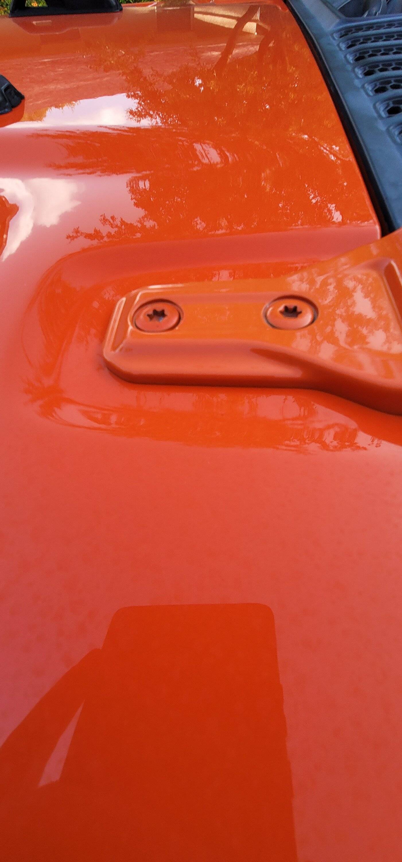

Picked up my jeep yesterday and I would have been much better off taking to a shop and paying to have it fixed. Its not that the shop did a bad job, Jeep just decided to approve paint for this area and not others. For example, they replaced the entire hood but not the hinges. I have a freshly painted hood and the hinges look way off. They replaced some of the hinges, for example of one an upper hinge that was replaced but not the lower. This jeep will never ever go back to Jeep for warranty work. Its not worth the time and hassle. Jeep's customer service is below subpar.
I hate to say it but this makes me think powder coating all my hinges black is the way to go. Did that on my TJ. Wasn’t going for the look on the JLU but Jeep may be forcing my hand…. My sympathies for you having to deal with this. I don’t think I’m but a couple weeks behind you.
Ya I will probably go that route or line-x. I might even have the entire jeep coated in line-x.
