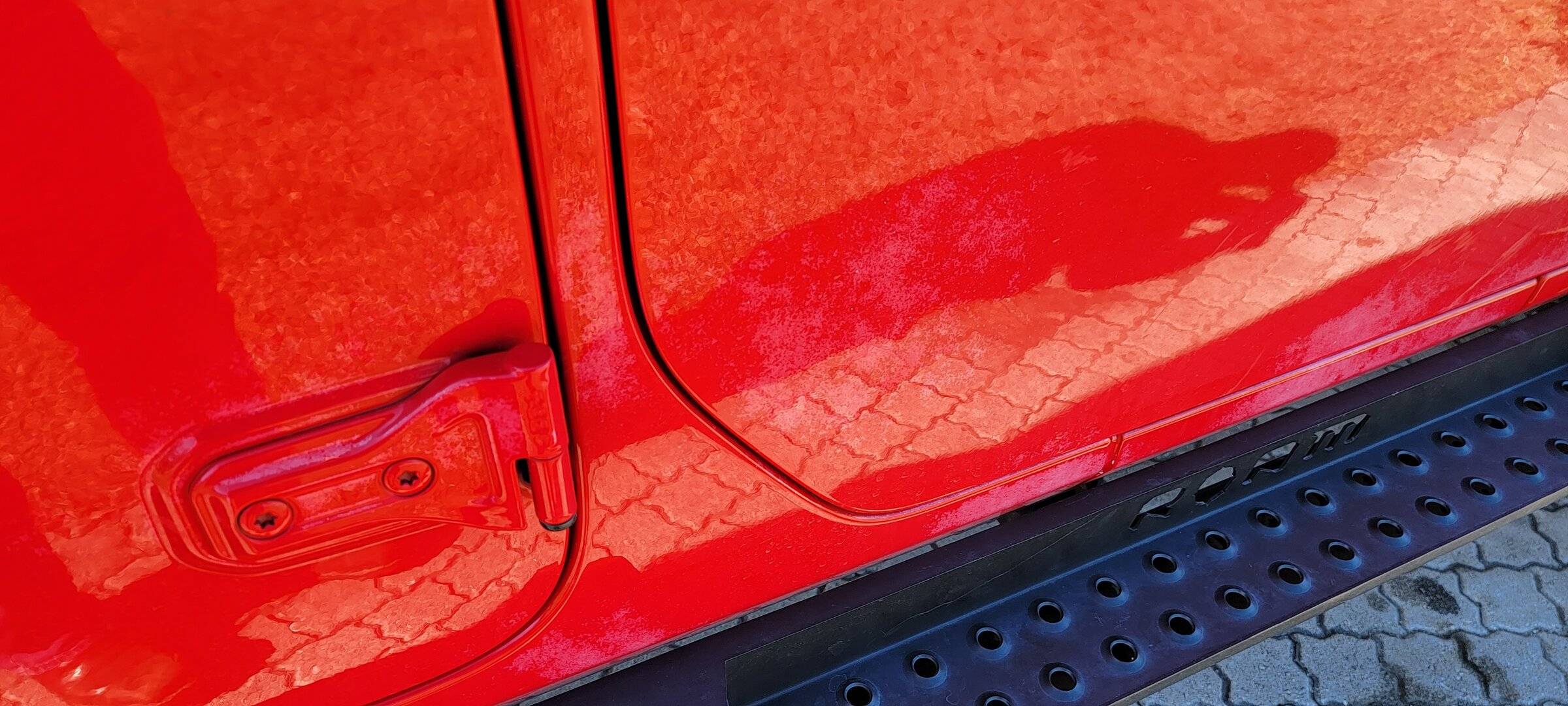

Hi,
until now, there aren't any problems with the doors, while the bonnet and the rear gate are starting to build bubbles around the hinges.
So, yes.. I think this method works Well, and I soon have to take care of the other hinges I didn't replace yet.

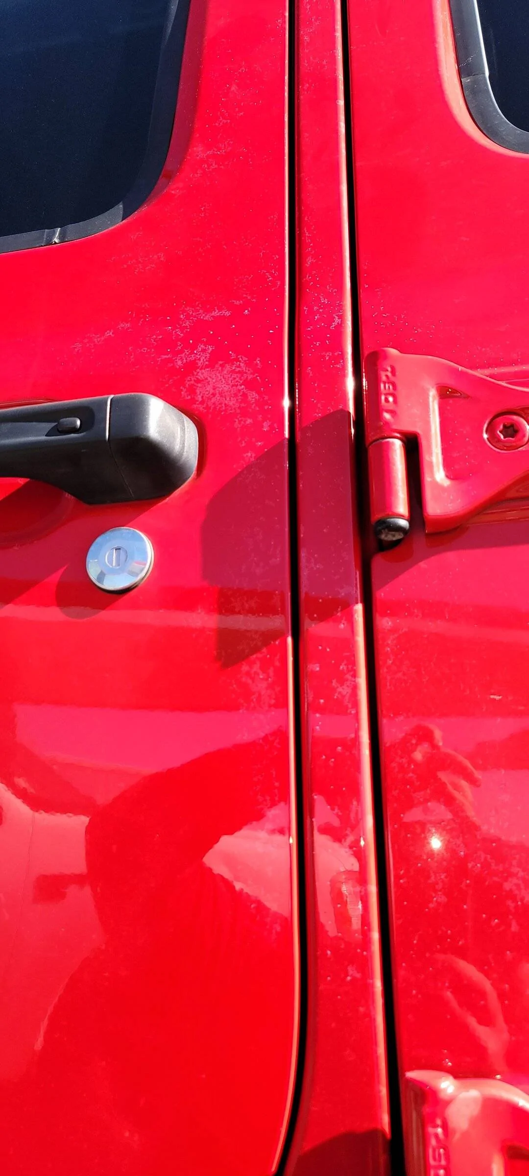

I have minor corrosion bubbles on most all hinges (x12). Working with a 2020 Rubicon. Most area of corrosion have been there for past year or so. Ironically, my work vehicle (2017 Grand Cherokee) has a fairly major corrosion spot on the front of the hood. I've been watching this "active" corrosion on the Grand Cherokee as my test specimen. Honestly, it sucks and is the size of a half-dollar, but it's not my vehicle and will be replaced soon. Note: all paint has remained on this corrosion and most would never really notice.
Now back to my 20' JLUR.. It's black and like I said, all 12 hinges have very minor corrosion/bubbles. I'm very skeptical to even report this issue to FCA (dealership) as they may insist to "fix" the matter now vs. waiting. After following this thread for past year, I'm thinking my best approach would be to just wait it out till last day to file complaint/open case through dealer (warranty expiration @ 3yrs/36k mi for full sheet metal and 5 years/ 100k miles outer-body sheet metal ). So, the question is do i wait till just prior to 3 yr/36k or 5 year/100k?
Some may ask, why wait at all? Well, I can live with corrosion with paint on top but i cannot live with mismatched hood, 4 doors and rear tailgate. The chance of a shop matching all 6 panels to tub...well..let this thread answer that question....

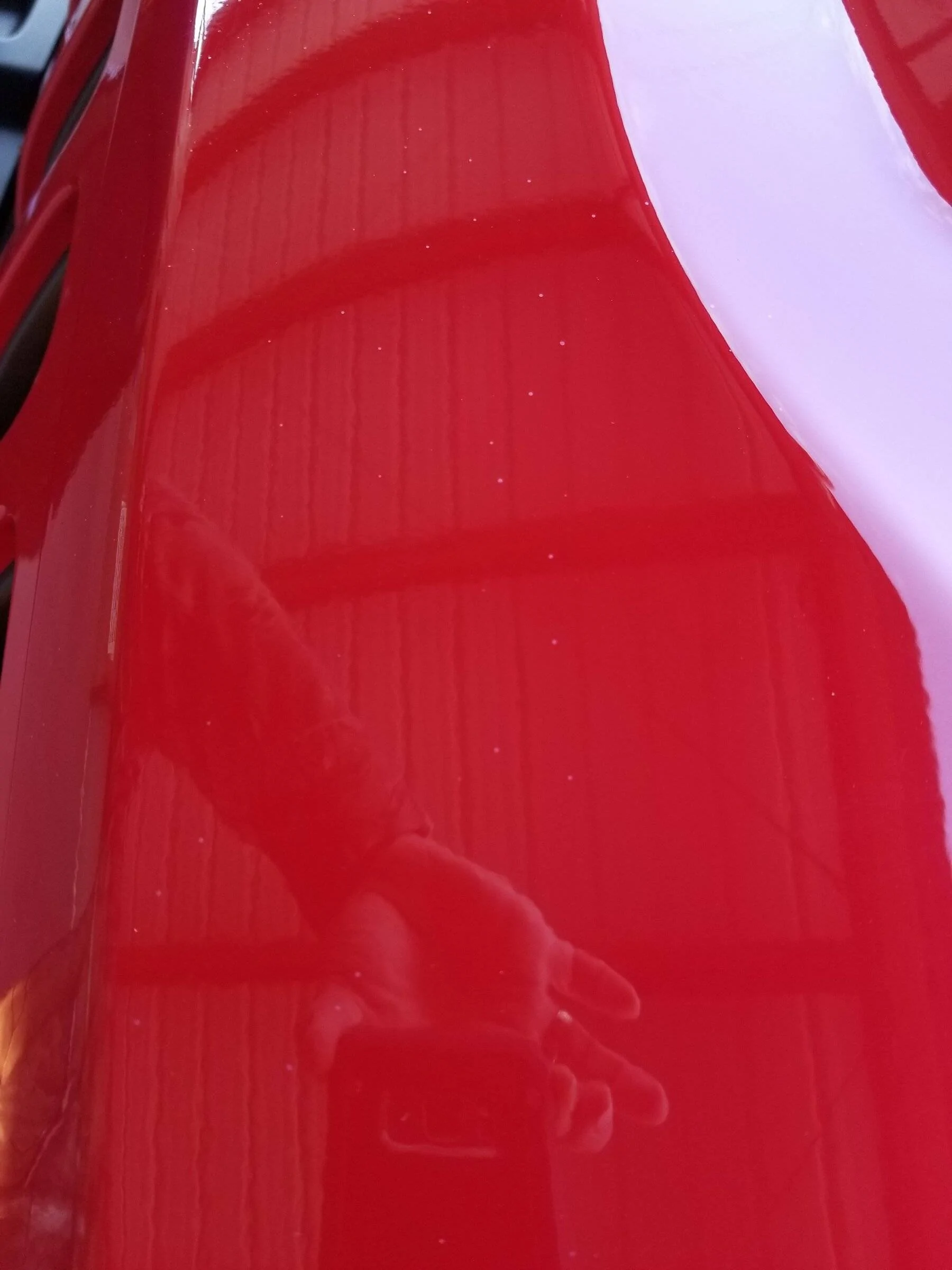

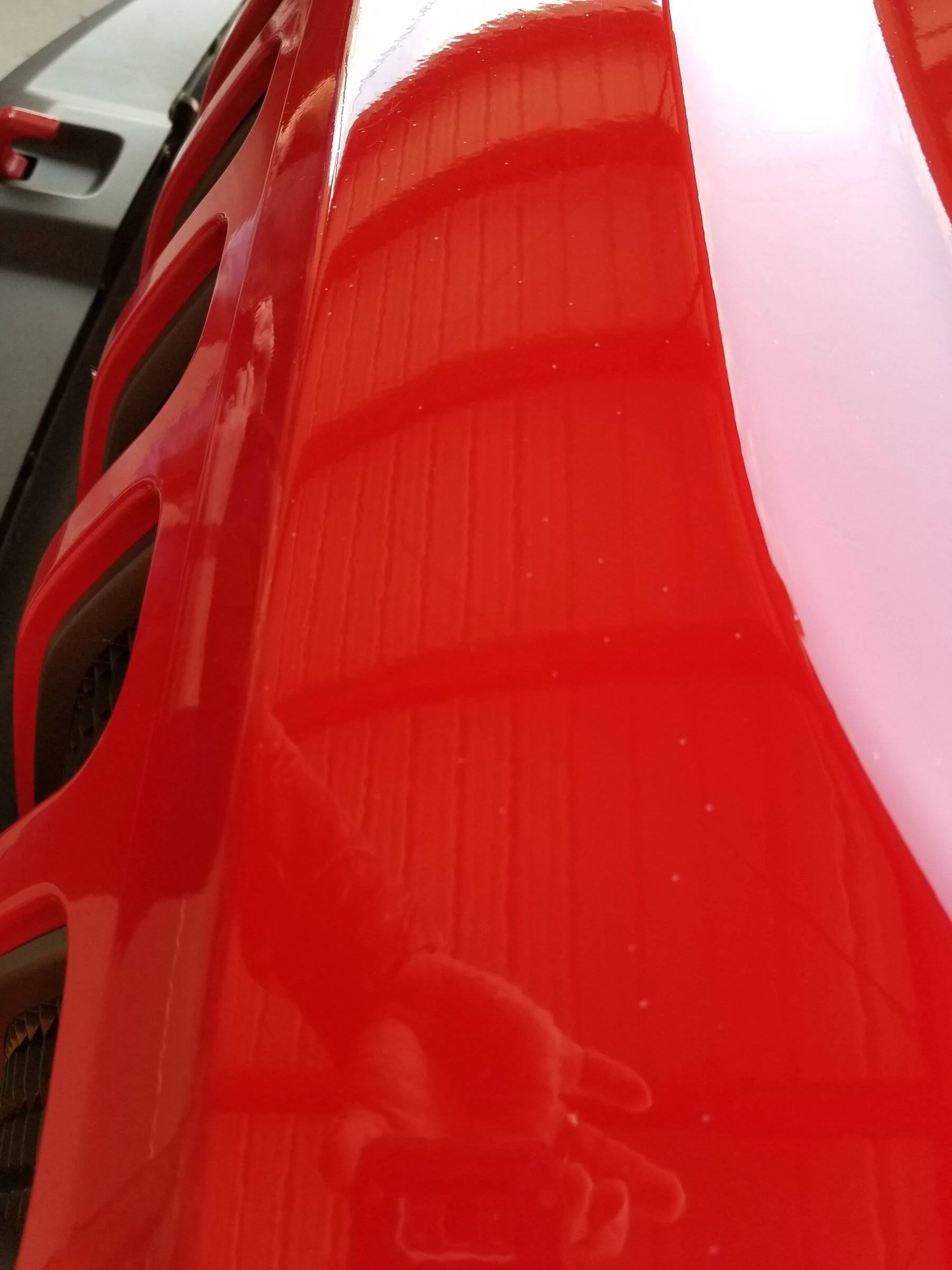

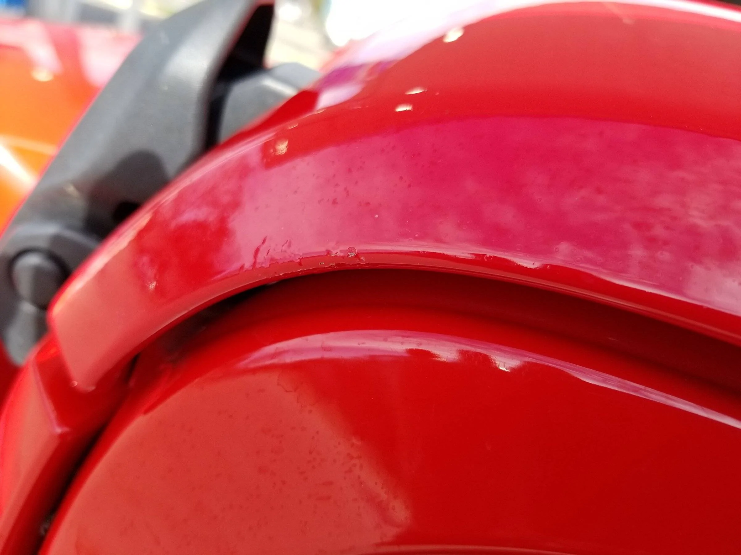

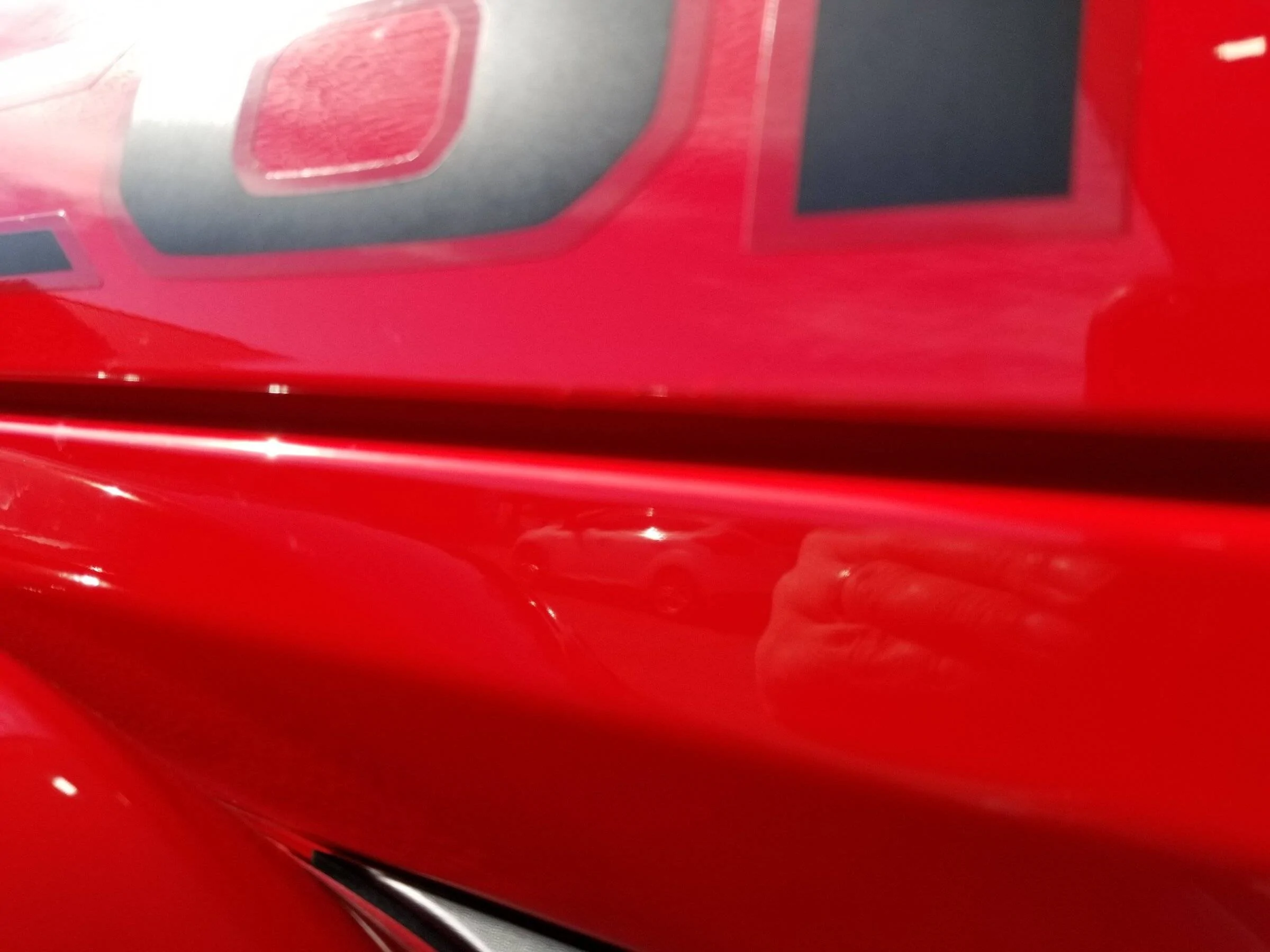

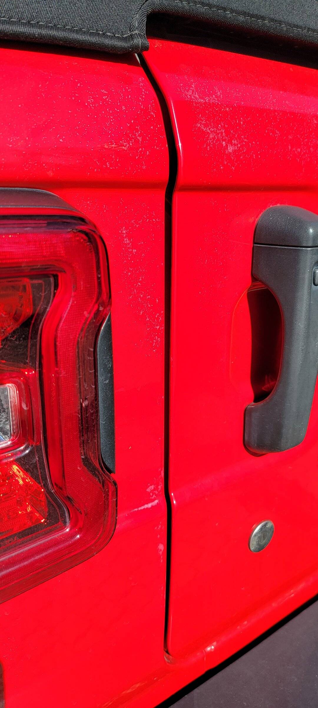

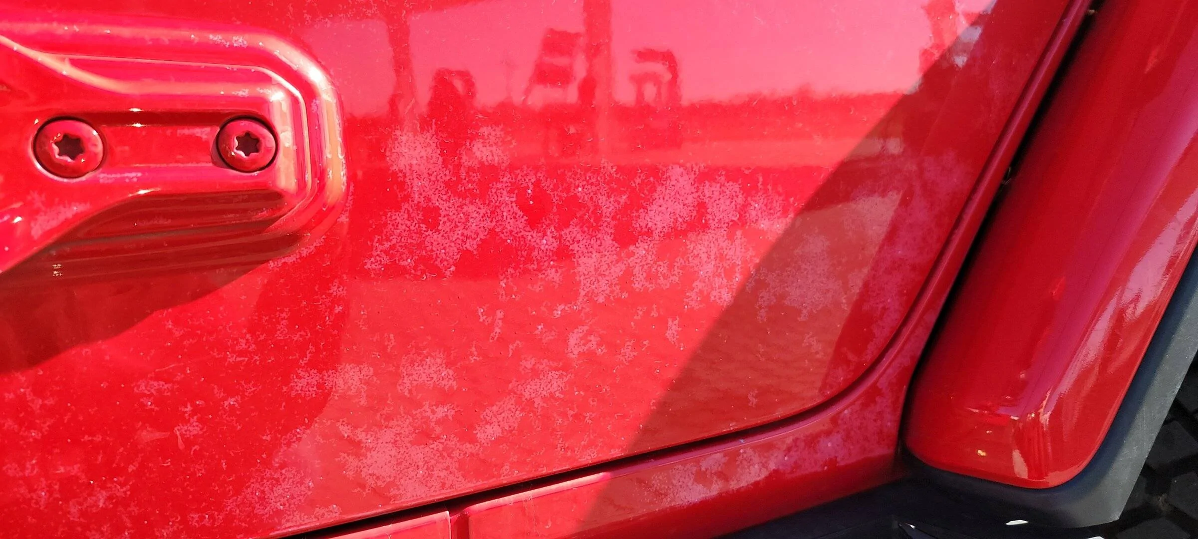

So I'm currently dealing with a unique situation. 2019 JLUR firecracker red with 28k miles. 2 weeks outside of 3 year bumper warranty. Last year hood and hinges had to be completely replaced due to corrosion. Less than a year later and while I was away at work for 10 days the entire jeep paint is separating underneath the clearcoat. In some spots already flaking. Dealership had someone from out of town come inspect it and said it's not corrosion and denied all warranty. Upon going back to pick it up I found corrosion bubbles just like the hood had last year on door hinges. Early stages. The same thing that happened with the hood just looks much worse around the entire jeep. Every piece of factory painted metal panel on the jeep had this happen. Within 10 days of me being away at work. I have just started a case number to begin the process. 3 year old year and this is the 3rd time it will need paint work.
