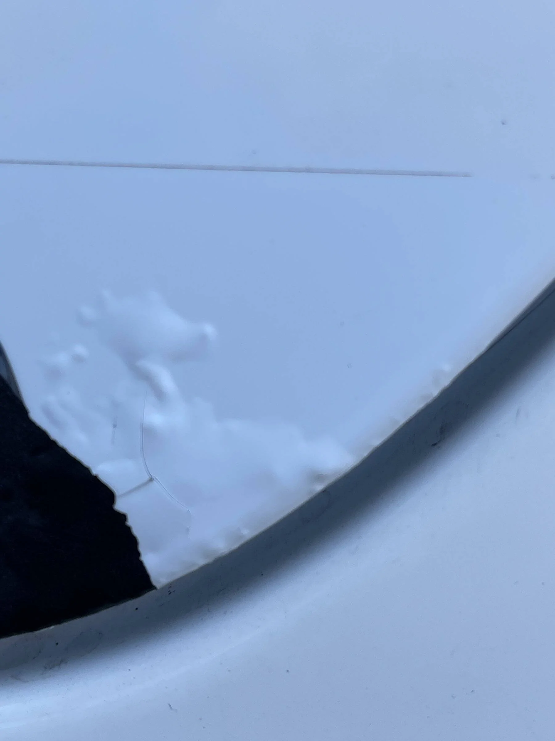

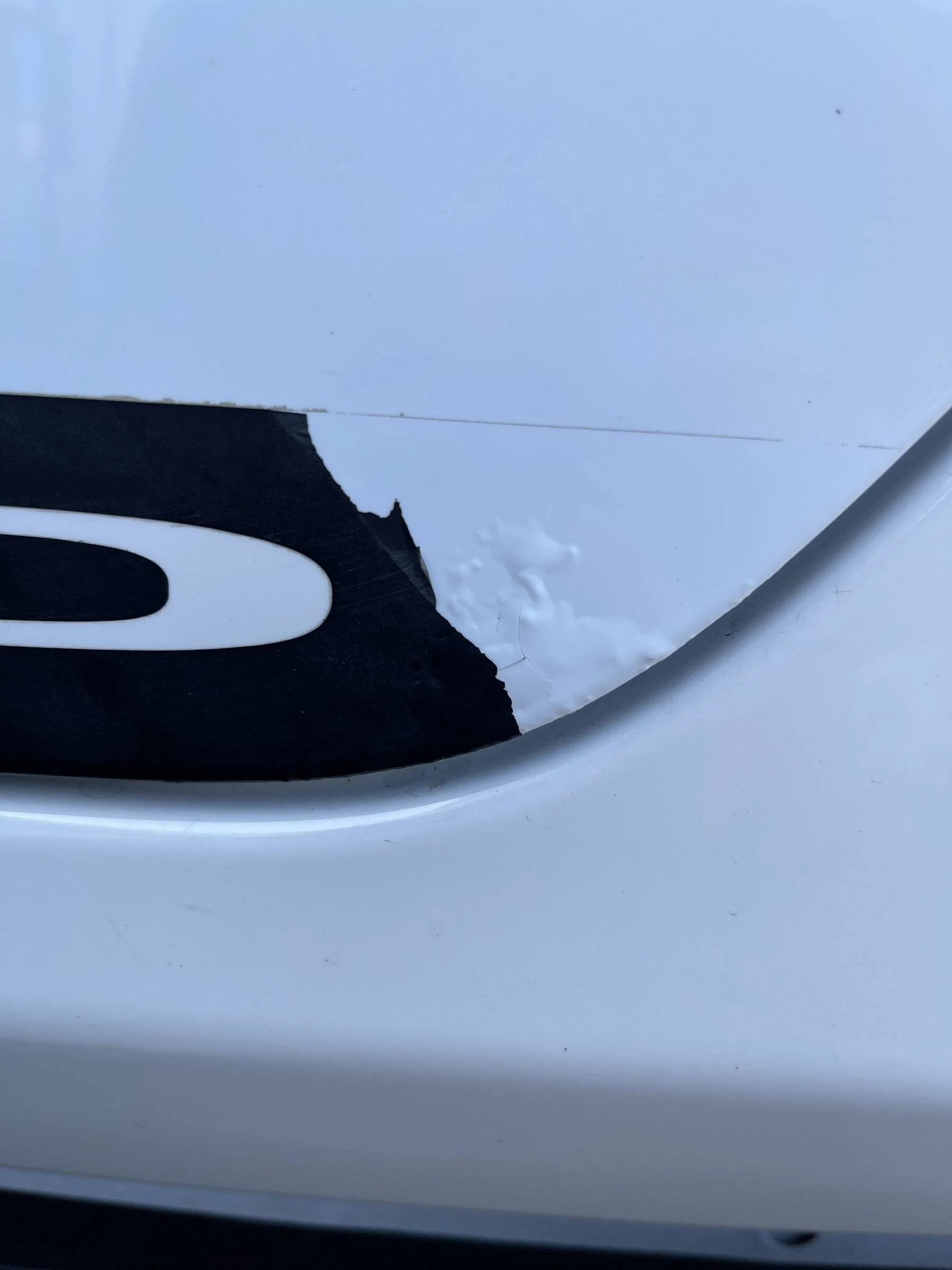

I have a 2019 Sahara and I noticed my decal bubbling up. Peeled off the High performance 3M vinyl to find bubbled paint and cracks. Going to go to a paint shop and see how much it will cost to have it repainted. Just wanted to contribute to the photo proof of Jeep's failure in quality control.
(conditions: I live in Los Angeles. No trails/off roading. No harsh weather.)
FCA'S poor paint preparation is what that's from. Take it to the Dealer should be covered under warranty 5yr or 60,000 miles
