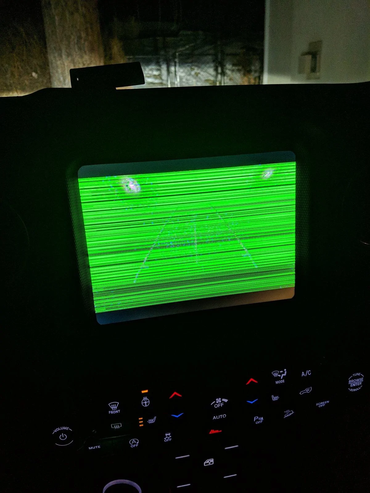

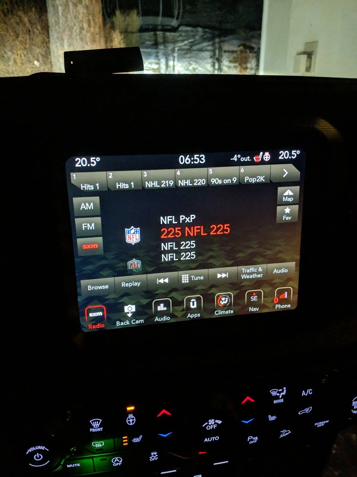

Just FYI for folks... my unit does this each morning when it is cool out. Once the Jeep warms up, it goes away. They are replacing the camera on warranty next week, but I have a feeling its the radio unit. If the cab is warm the camera works just fine.
