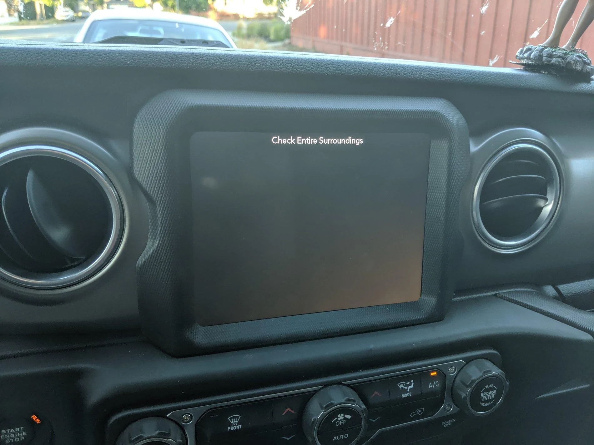

I just got this today while parallel parking. I guess I'm lucky. The blind spot behind this vehicle is huge. I'm ashamed to say I've become dependant on the backup camera I'm already on my second radio (which comes with a surprise cancellation of the free first year of Sirius...yay?). First radio had the touch screen lockup issue. Second has backup camera issue. I kind of want to go back to something analog without software.

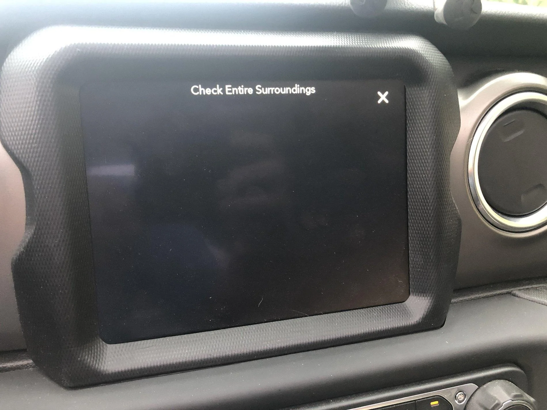

I’ve had the same issue with the Check Entire Surroundings screen.
I also have had other issues........a constant tone (like the backup warning sound) during a complete trip. It would drop the volume of the radio........very annoying. Was gone when I started the Jeep the next day. Have also experienced the No Audio syndrome numerous times as well. It is my understanding from @JeepCares there are no radio software updates.
My closest dealer is approximately 1 hour door to door, so i can never duplicate the problem when I have a day available to take it in.
