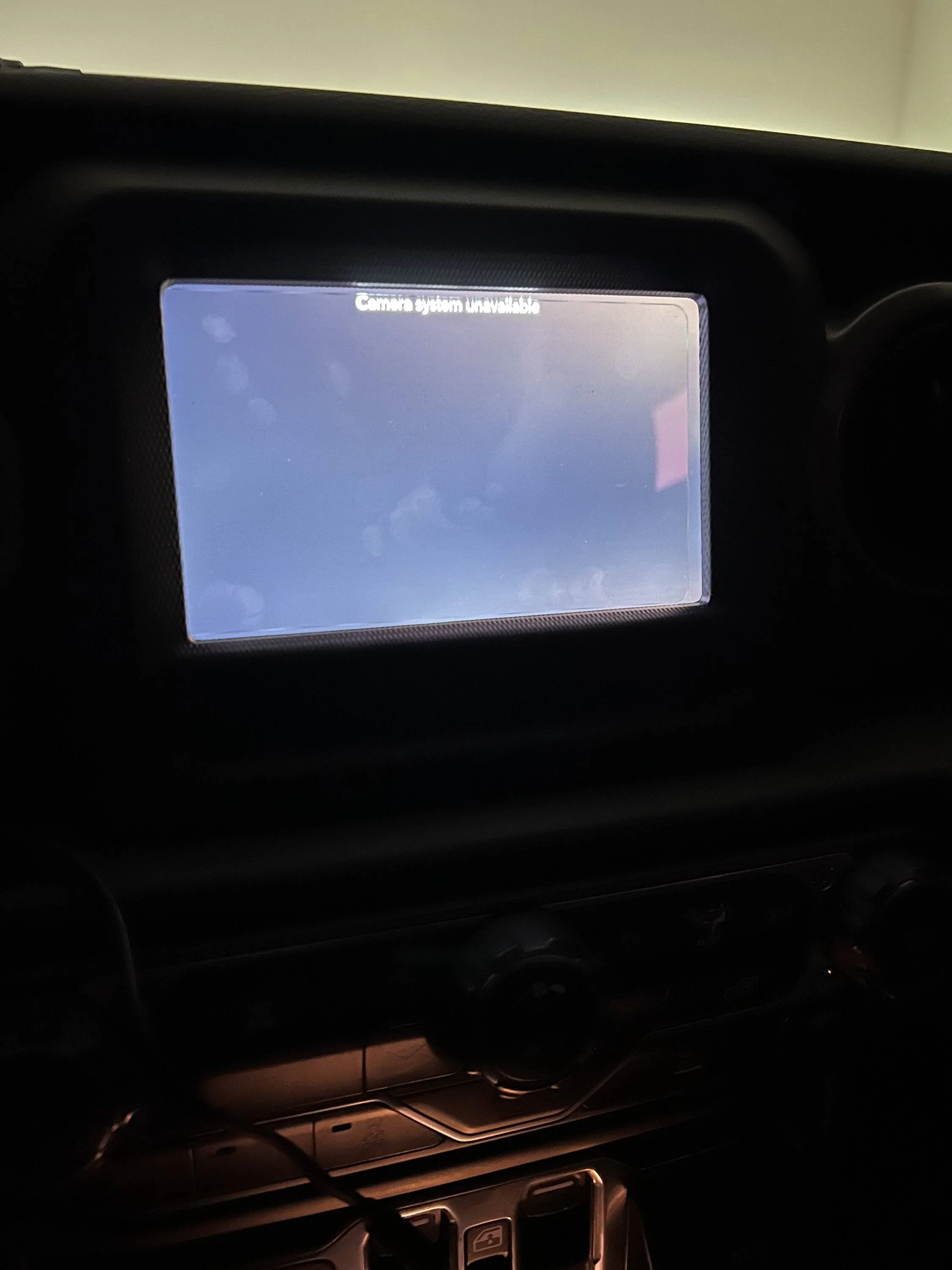

So I replaced my 7" radio a week and then my backup camera because of a chip in the lens. Tested before putting back together and it worked. Put everything back together and now its says "camera system unavailable." Any ideas?

I think I might have pinched the wiring harness when I reinstalled the tire carrier and tire. Ordered a new one to try to fix this issue otherwise I'm out of options.
