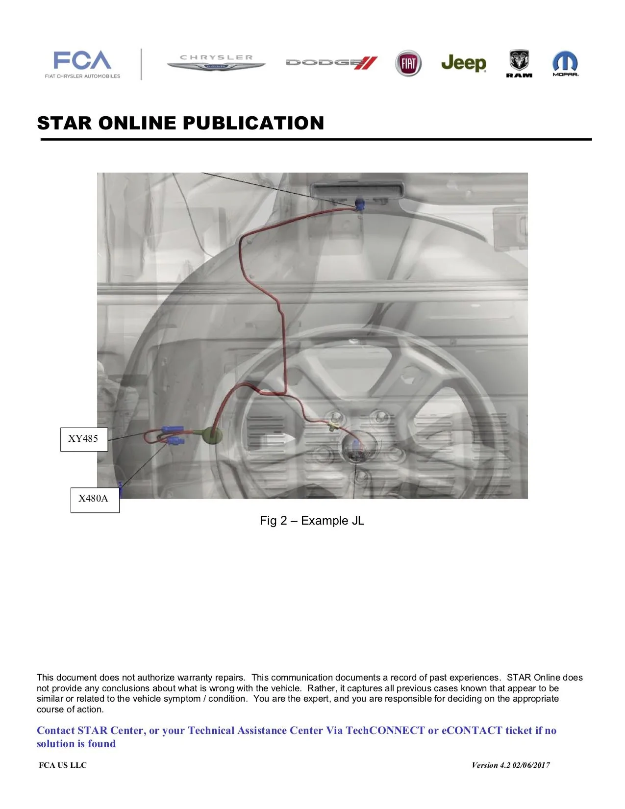

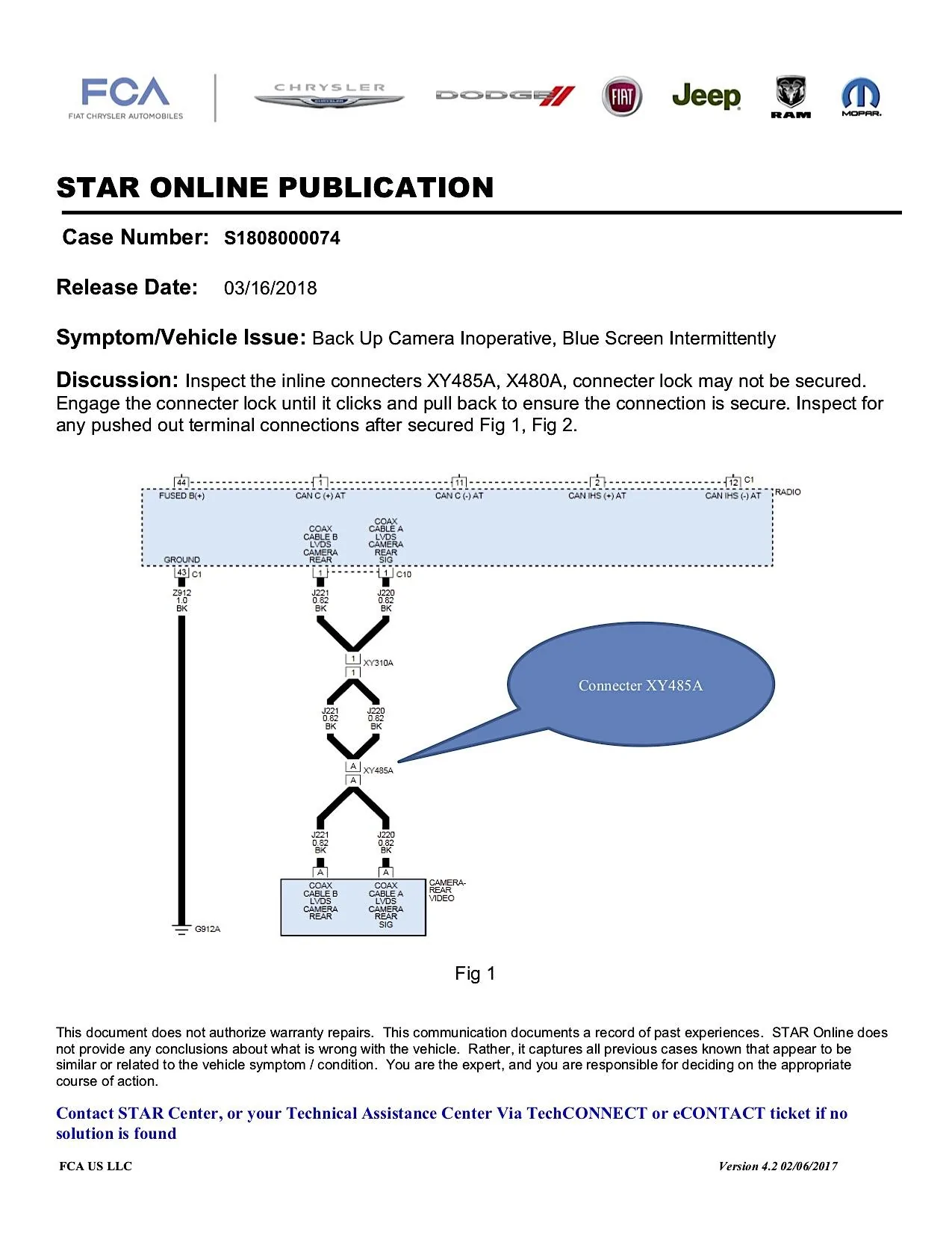

Issue Bulletin: Backup Camera Inoperative / Blue Screen
