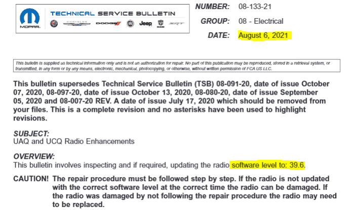

My Jeep still has not received the over the air update. Jeepcares didnt offer any help to push my vin # up in line. They just said go to dealer. So crazy
OldGuyNewJeep
Don
Sep 21, 2017
93
3,999
7,126
CT
Go to dealer and explain symptoms. This is the TSB you need:
Jeep Wrangler JL Backup Camera issue 31A70ADA-919A-4FD7-A795-B9D273357AEC

software 21.05.11 is that the latest? It still intermittently has lines. It’s spreading to my f150 now the camera in there has an occasional blue screen in the mirror.
JimmyZ
Jimmy
Oct 13, 2020
632
529
2021 2-Door JL Snazzberry Rubicon
Look at my posts and the surrounding ones in this thread about post #228ish. And see if your numbers match up. Since I got the update have not had the backup camera issue once. Still have Bluetooth issues where it won't remember my damn phone... But why would a 50k ride do that in 2021? I'm asking too much
