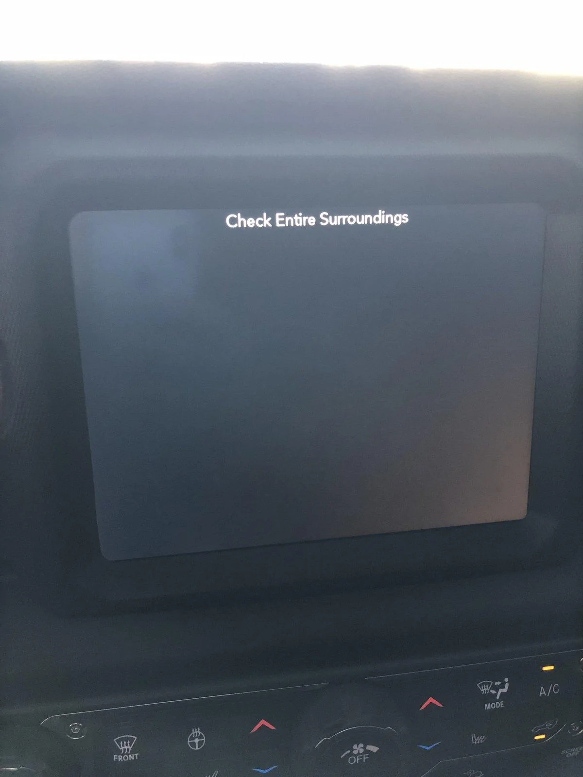

Jeep Wrangler JL backup camera suddenly stopped working 8C3CC92A-2B36-4FF5-8017-D2EC1CB6FB4F
Mine just went dark too.

Big Brother was watching you, and saw you didn't Check Your Surroundings.
Oh i checked. Just not my “entire” surroundings i guess. FCA’s lawyer must have wrote that, lol.
