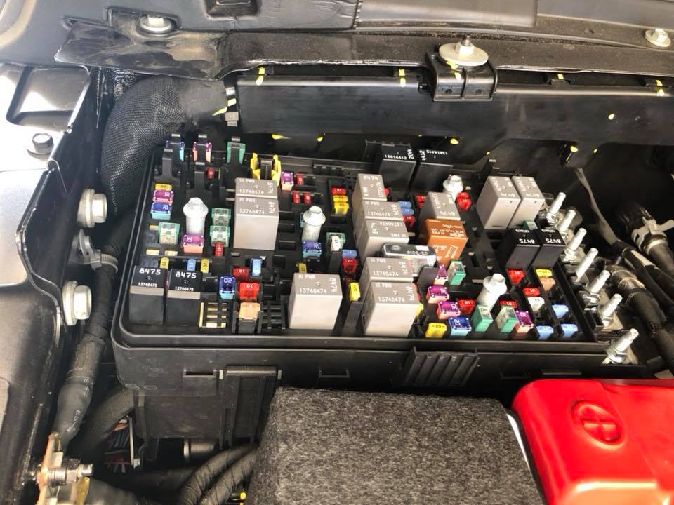

My backup camera was flakey until I pushed all of the fuses down to seat them properly. A lot of them were loose. No problems at all now for months.

I reseated some fuses and will check in the morning.

Pull F11. If it doesn’t reboot, also pull F97.
Rhinebeck01
May 9, 2018
169
12,678
19,194
Ormond Beach, Florida
Retired at 55 ..
@OldGuyNewJeep
F11 should trigger a reboot but yes, doing F11 and F97 will also net you a reboot.
For those that might want, I have attached a pdf that lists all fuses and what they are associated with.
