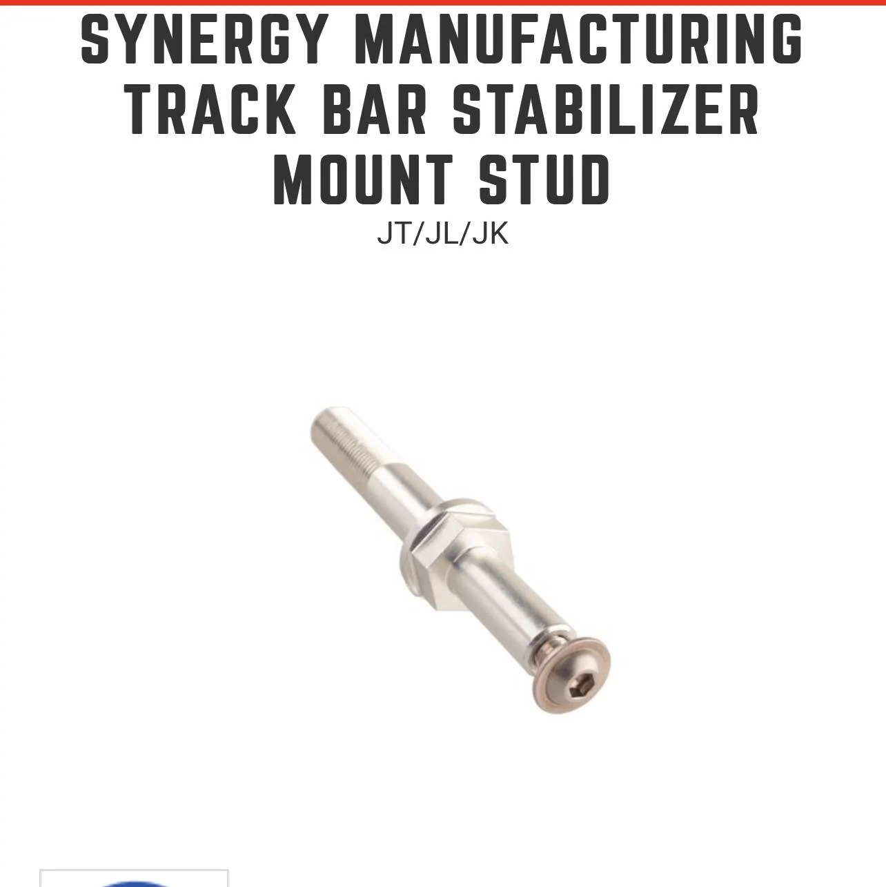

Yes. The trackbar bolt. It puts the stabilizer too close to the stock tierod, causing contact starting at about 2/3 passenger lock and a good deal of force pushing the tierod down at full lock.
The best I could achieve is angling it so it scrapes about a 1/2" section of the shock body. Can't wait to fix it.

Just curious. You not a fan of the synergy TB stud?
Actually, I am a fan. I think it is an ingenious design and worked well on my JK. What is not cool is that Synergy pushed the same design on the JL that has a stock tierod that is 1 and 5/8" vs the JK 1 adn 3/8". There is simply not enough clearance on the JL.
P.S. I had the same setup on my JKUR with both stock (2 years) and Synergy (2 years) tierods - never an issue. JL = different story.
