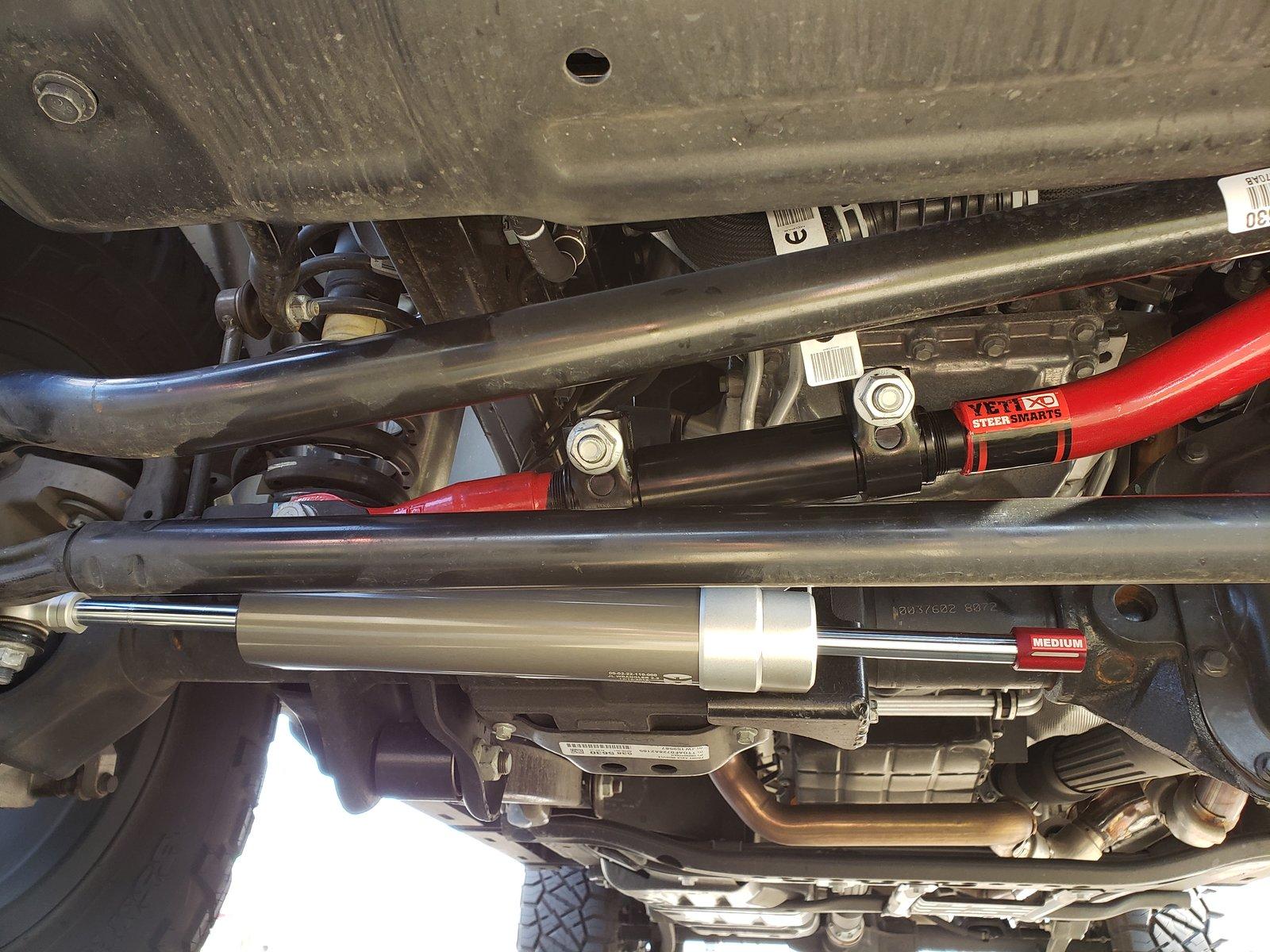

I gotta say it does feel better on the highway after falcon steering stabilizer on medium setting, still has some play but its firmer. Next I'll try on firm.

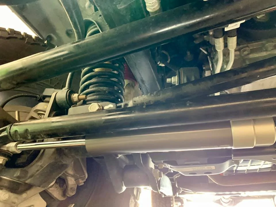

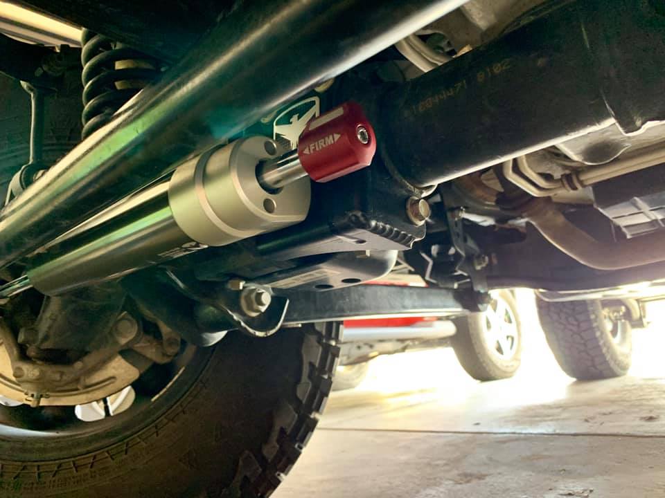

I replaced the stabilizer today. After removing I found that I could compress it without using my full strength. It was also leaking fluid.
For comparison, I tried compressing the Falcon stabilizer but found I just could do it if I put a lot of muscle into it on the Soft setting. It wasn't too much of a pain to install. I had to buy a torque wrench but hey, now I've got a new torque wrench. ;)
I've only taken it on a few roads around the area, nothing to really test it out but I'll be driving a really rutted road later today that'll give me a better impression of how this has affected my steering.
