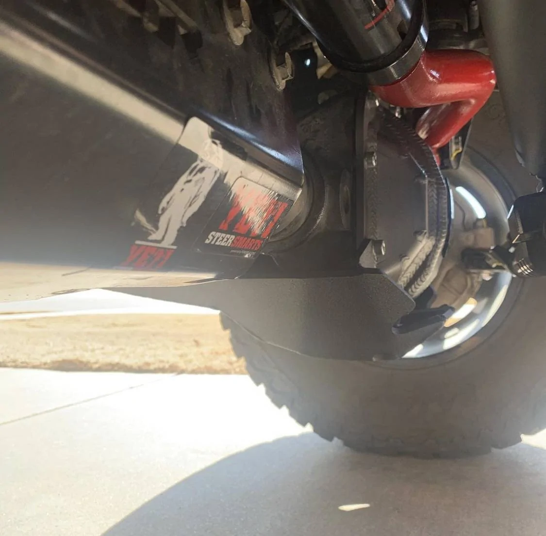

I'm putting on Apex Chassis 2.5 ton aluminum tie rod and drag link as well as the Dynatrac ball joints that are rebuild able also the Yeti sector shaft brace , I'm preventing any chance of future issues such as death wobble and or deflection from steering...any thoughts on witch stabilizer shock would be sufficient ?

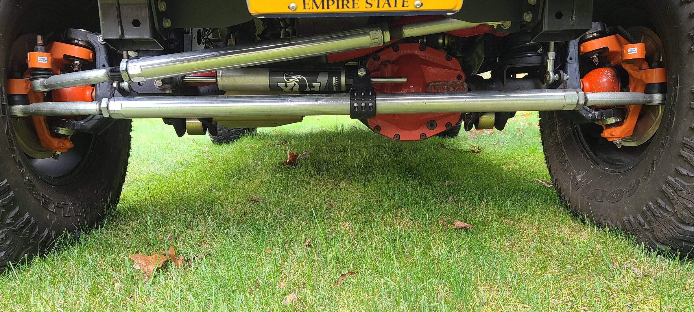

Any stabilizer… fox ts or ats are the most liked, icon has a thru shaft one too.

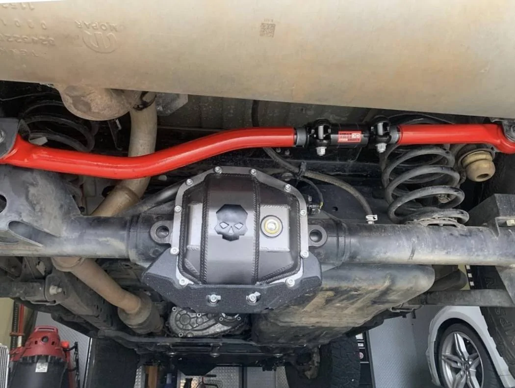

Holy crap Mike, that is some serious front end strengthening!! BTW, I was wondering if just a good diff cover is good enough instead of skid plates?
I actually like the Next Venture Motorsports diff covers and skids better. Part of me is saying to stop putting money in these axles, but the other part says what's a little more gonna hurt at this point. ?
The front Dana 44 is relatively smooth on the bottom. Damage and/or loosening of the drain plug are the main concerns, as far as the housing. The stamped steel diff covers will get damaged from any dragging. A stronger cover will resist damage and leaking. The rear 44, however, is ribbed side to side which necessitates a diff skid. I added both to my rear. It's mostly for looks, but also the oddball chance of backing into something that could push the factory cover into the ring gear.
