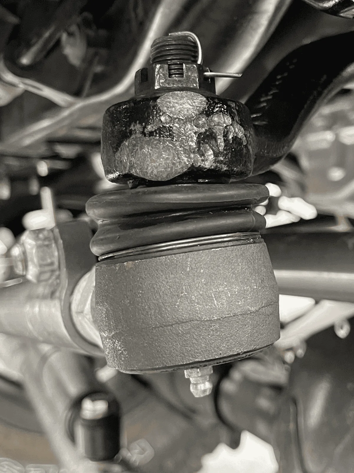

Dealership did not perform an alignment after the gear-box change even it is mentioned in the TSB. They claimed they don't have the equipment and therefor only did a test-drive. Sigh. They banged up my pitman arm quite a bit - hope that was not while attached to the new gear-box! And it makes me question the mechanics ability to use the proper tools a bit.
