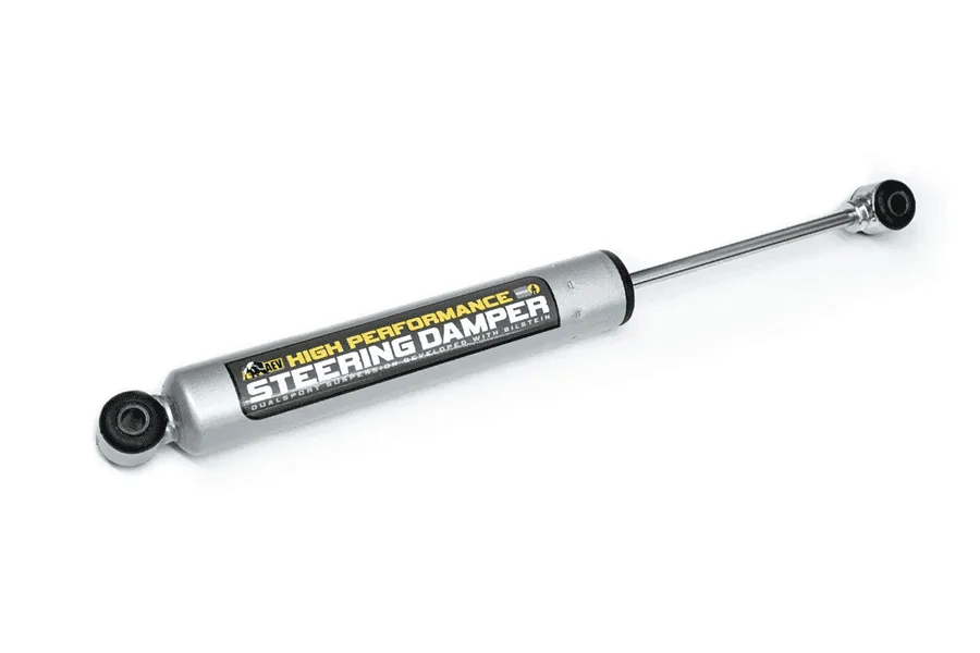

My Jeep is lifted on 37s, but still on factory steering linkage (tierod and draglink), and the steering alwyays (had bump steer and the one second wobble when hitting bumps). Tightening ball joints and linkage ends helped a little, but it always bothered me. Then I had a few instances of wobble that got triggered by a bump and would not stop unless the speed was drastically reduced.
Obviously, I have been going through the death-wobble check list and all is tight and and angles are good and Jeep drives like a dream - hands free on the highway at vMax.
Jeep has under 8,000 miles.
While the factory stabilizer is still in good working order and I tried a Teraflex twin tube one that is stiffer that one had too much small play with little resistance for small movements.
So I have a Fox thru-shaft neutral pressurized shock on order, but they have been back ordered forever.
So I decided to take a chance on a monotube pressurized damper - even though I'm against non-neutral stabilizers.
so read below....
