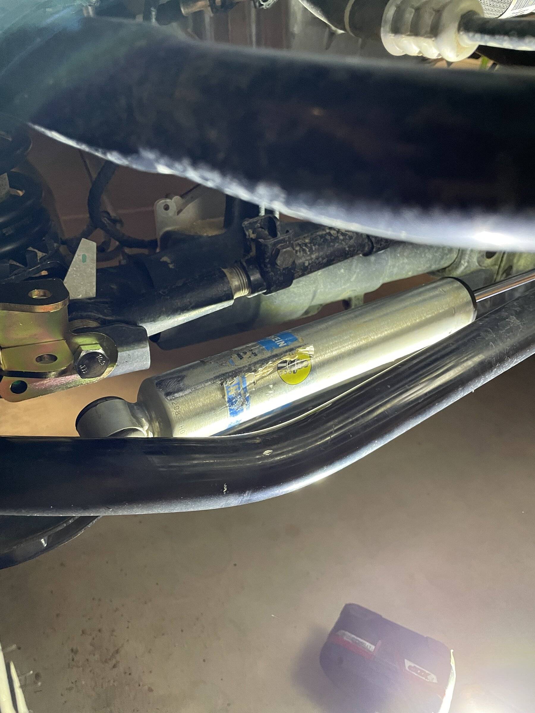

Installed mine today. While I wouldn't say it is a magical difference, it did firm up the pothole shimmies pretty good. I am happy with it.

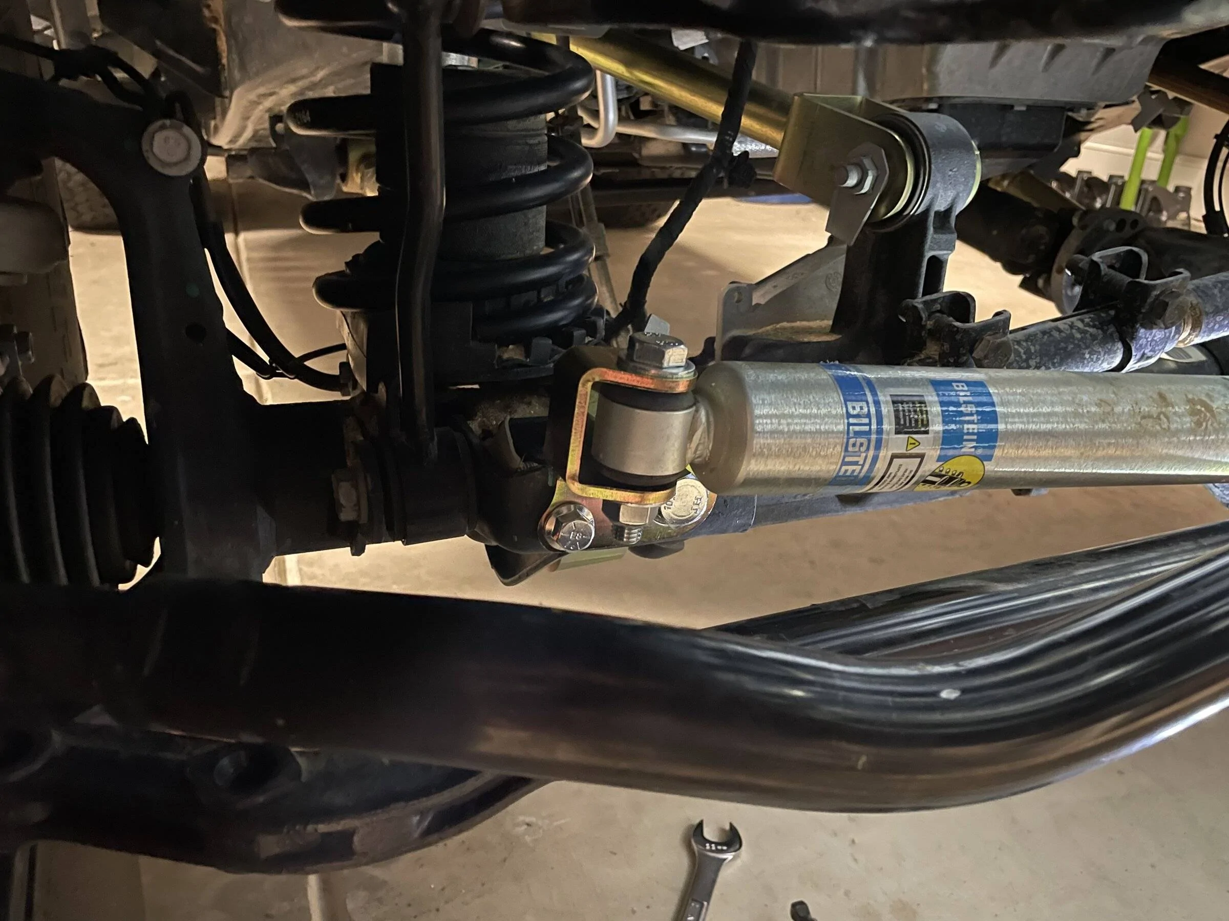

I put in a Fox TS, as my AEV one was hitting my tie rod. I get a little shimmy on pot holes with the Fox. With the AEV I have none/zero. Moving them by hand, I feel the AEV has ˜ 1/3 to 1/2 more dampening force.
I'm in a pickle. I can have perfect steering with the AEV with a little rubbing on the tierod (due to the Synergy relocation bracket) or good enough steering with the Fox (which is mounted higher with the Fox TS mount) and no rub.
I just picked up the MC track bar side bracket, haven't replaced the synergy one yet, but thinking it will do the trick on the tie rod rub, and put the bushing stress back in the same plane since it is vertical.

Ordered the AEV JL Steering Damper done in partnership with Bilstein for $120 from Northridge. Got it delivered in 72 hours.
https://www.aev-conversions.com/product/steering-damper/
All I can say is wow!!!! My steering wheel does not move at all. Completely solved/masked any hint of bump steer, shimmy or wobble hitting any of the bumps at any speed. Simply amazing.
Also is perfectly damped, not overly stiff, so it did not make the steering any heavier (nothing noticeable at all).
There is zero pull, which was a worry with a non-neutral stabilizer.
I'm extremely happy with it, and now happy with my steering again.
So passing along the info in case anyone want to try it.
Not only had it rubbed the crap out of the stabilizer, the little synergy button head had worked itself finger loose, yes it was torqued.
MC is close on my track bar pinch bolts, but just a little more room on the tie rod (lol). Nice bonus, you can rotate the rubbed off section to hide it.
