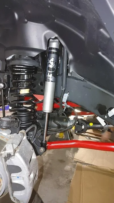

I ordered the Core 4x4 Tier 3 and plan on installing them this week. What is a good starting point for length? I have the original Rubicon springs, plus a 2.5 inch spacer. I'm thinking 24 3/8 or 24 1/2.

I installed Core 4x4 Tier 3 with Teraflex 2.5" springs on my Rubi . l used 24 and 3/8ths for lowers and 20 and 1/4 for upper, gave me 5 degree caster. Take that as a start. I would probably extend the lowers another turn out if I did it again. But those numbers should get you in the ball park.

I've the same setup as you except a 2.0" front spacer (and TeraFlex LCAs). I installed them at 24 3/8". If anything, I need one rotation longer, but I'm pretty happy where I am.

Do you have stock upper control arms? Do you know what your caster angle is?

Yes - front lowers are all I have. My caster went from less than 5° to between 6°-7° (closer to 7°). I'm using one of those orange angle-finders, and it's a little hard to be exacting. My highway steering went from flighty(ish) to rock solid.

Thanks for the info. I'll be starting at 24 3/8. I think I have the same orange angle finder.
